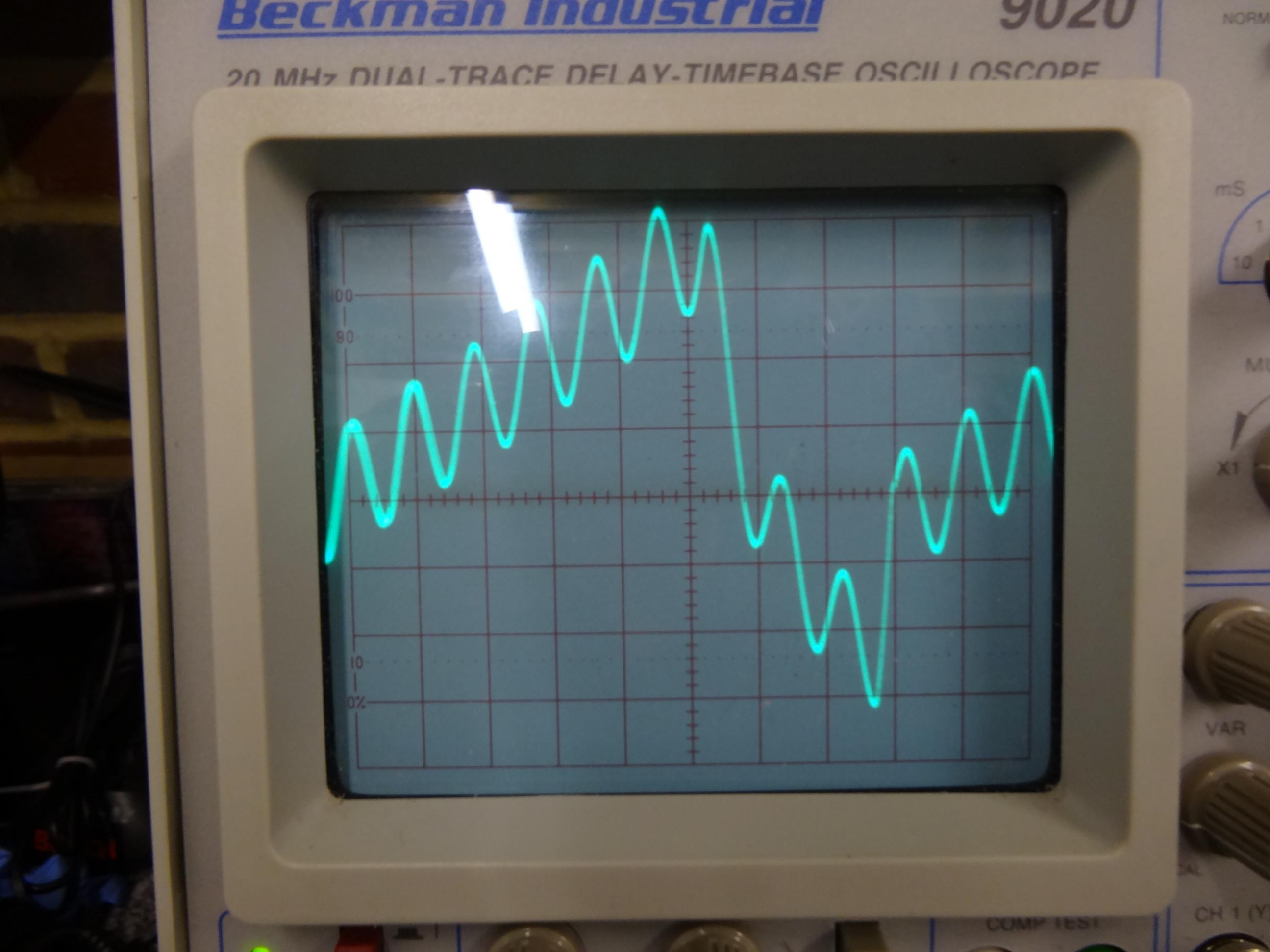

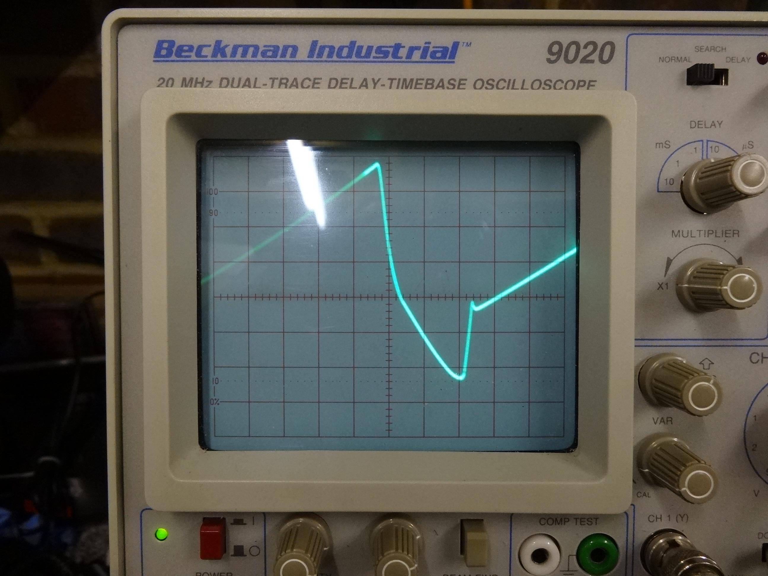

Hi, I have a problem with an amplifier. It has a loud hum in both speakers that is not affected by the volume control or any controls or buttons. I am thinking that it is a power supply problem. It has about 180ma of ac present at the speaker terminals but only -1.8 mv of dc. I put a scope on the speaker terminal and I have uploaded a photo of the wave produced. I have also uploaded a photo of the speaker terminal with a 1khz tone injected at the tuner input.
Any help much appreciated.

At first glance, it appears that the main smoothing cap(s) in a conventional transformer/rectifier power supply have died and need replacement. That suggestion would depend on the frequency of the waveform, whether there is also an output capacitor etc. These details are not shown but the waveform would then be 100 Hz frequency with a 50Hz mains supply. That may not be the whole story though and even the rectifier diodes could be bad.

What about checking the power supply with the scope. It will tell you if the problem it is with the PS.

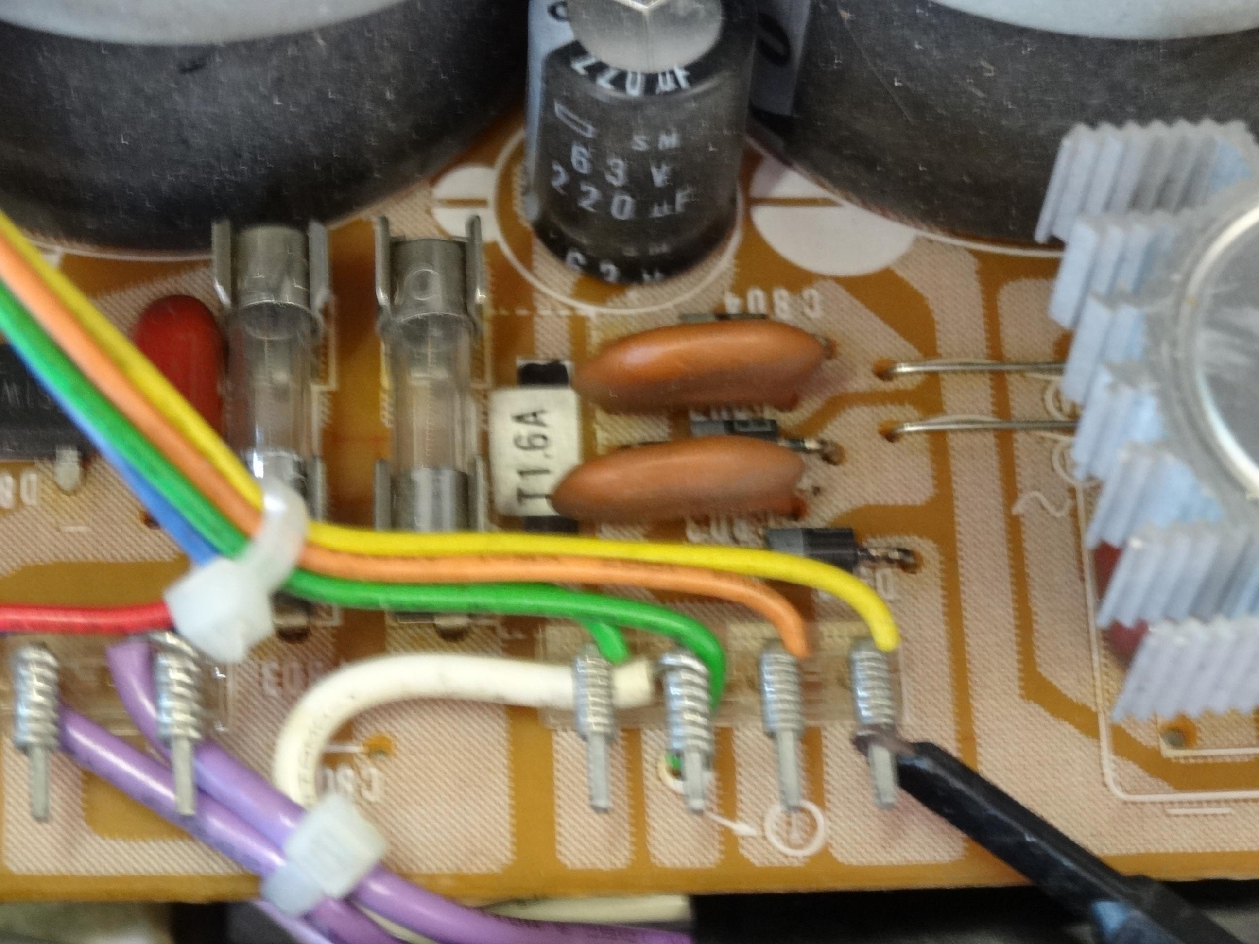

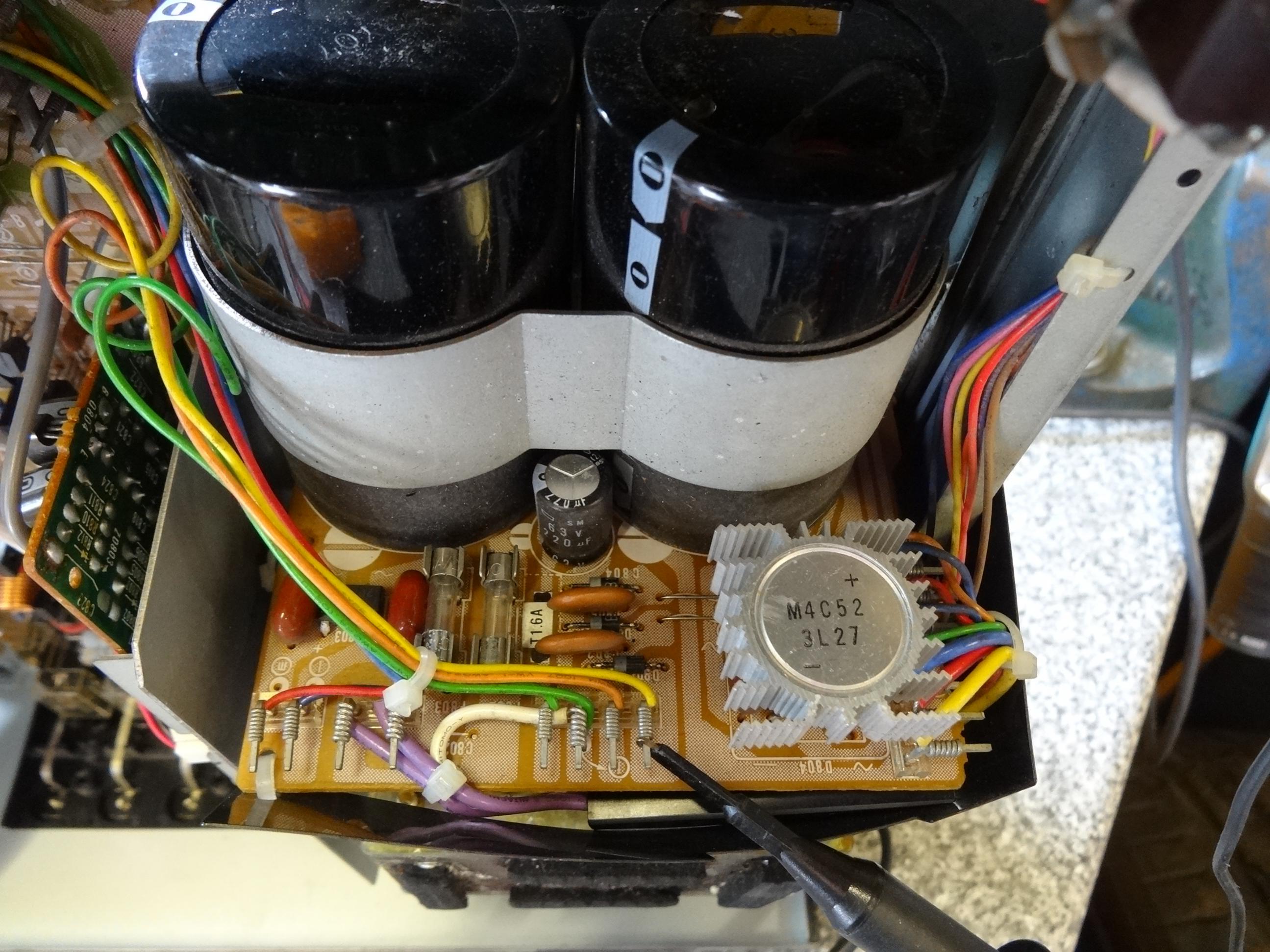

Have had a probe around the power supply today, It seems to be clean from the main supply to the rails, but it looks like there is more than one supply. there seems to be a supplementary supply (see picture) and the yellow wire has 21v of dc and 21v of half wave AC on it. I have pulled the nearby diodes and they check out ok, but I suppose they may only fail under load?
Any ideas?

That would be an open electrolytic (power supply reservoir) capacitor, I bet. Look for a largish (>100uF) capacitor from that supply to ground. Bridge it with something like a 1000uF or so (35V or so), see if the waveform cleans up and the hum goes away.

Check the capacitors on the 21 volt rail.
If the amp is old its possible the electrolytics have died or partly died.
