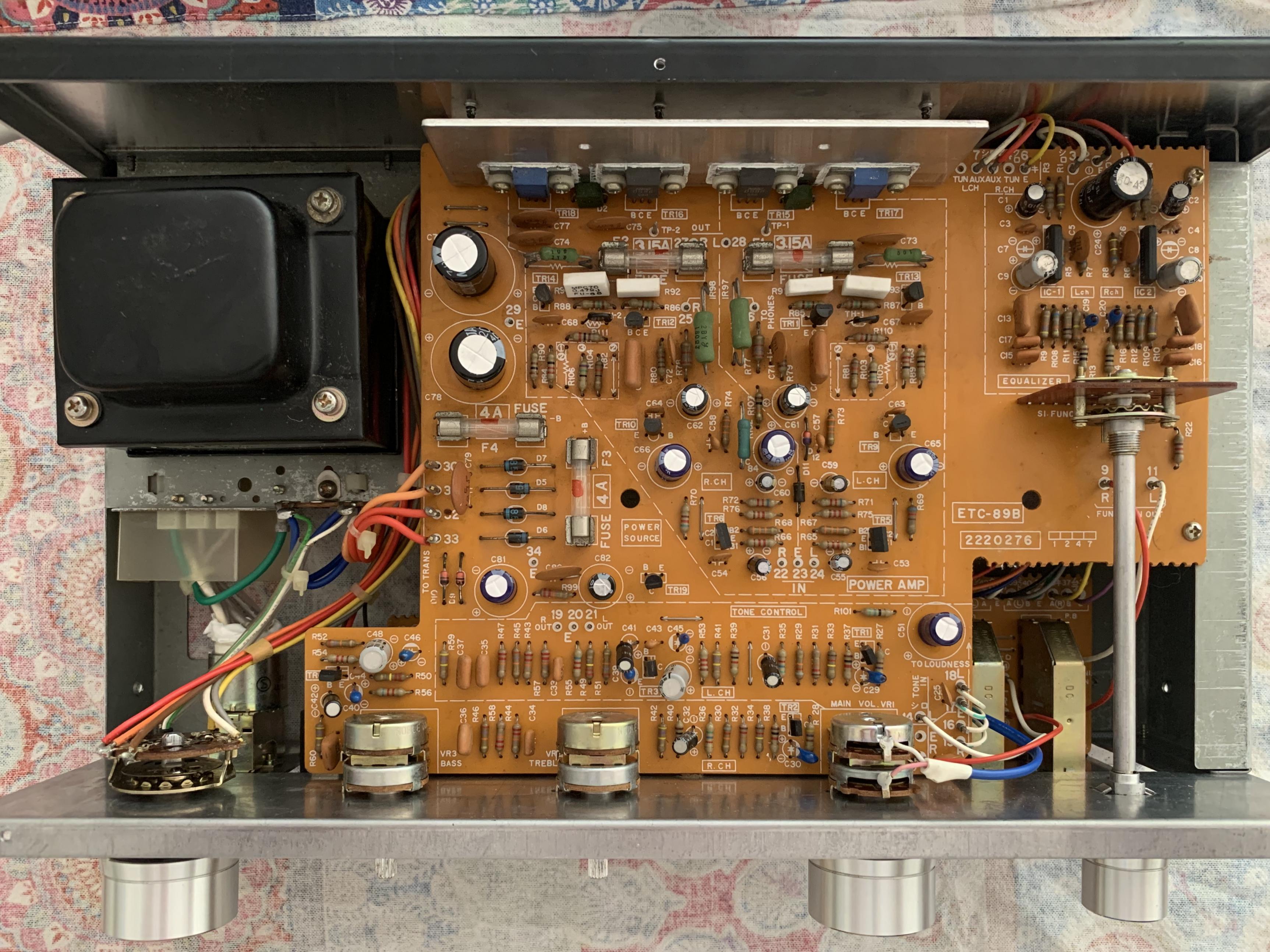

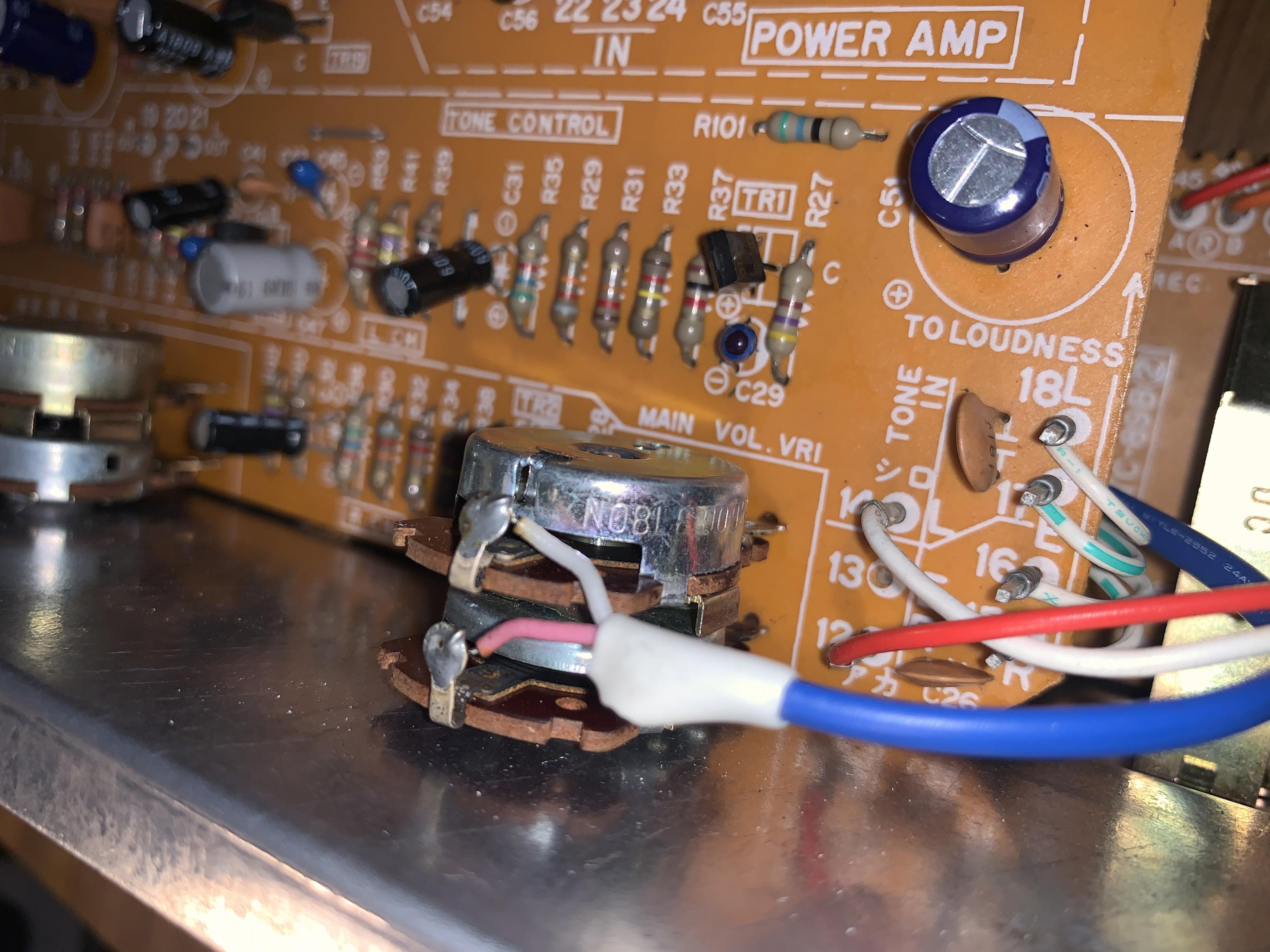

I have a 70s Denon SA-3300 (not my pic) with a 20-step Noble volume pot (see attached pic from my unit). Without taking it out, all I can read from the stamp is NOBLE 0095107

The problem is that the amp gives out varying amounts of white noise with no source plugged in (no difference whether on Aux, Tuner or Phono), depending on the position of the pot. BUT the amount of noise produced is not linear with turning up through the 20 positions - each position leads to a *different* level (and character) of white noise. Unfortunately, in positions 4-8 (loud to very loud on my speakers) the noise becomes v.noticeable in quiet passages.
It's very much "random". For example, position 4 gives off a certain amount of hiss. Position 5 may give out more, position 6 a bit less, position 7 more than position 4, position 8 more again, then position 9 next to none, position 10 none, position 11 some other amount, and so on.
This leads me to think that the problem lies in the pot itself, not the amp - and if I can fix the pot, I can have a super-quiet amp.
I have done all the contact cleaner spraying I think it can take, from multiple angles (some lubricating contact cleaner is now on the way as I will have cleared out every last semblance of lubrication from there already). Wiggling the pot whilst listening does very little to affect the white noise (but maybe a little).
My questions are - should I keep cleaning (maybe unsolder and take the thing apart, but I don't want to really have to go there), try something else or think about replacing the part?
Another thing I'd like to understand is how to even look for a replacement. There are 6 PCB solder points (3 per side) plus the two wires attaching to the pot tracks. If I took the thing out, I'd be looking to find out how to measure it and get an appropriate replacement.

This might seem like a dull minded question... but when you clean the pot are you spraying directly into the opening above the wires and spinning it up and down end to end as you spray? The back and forth is needed to wipe the smutz off the carbon trace and wiper.
From the picture, there's nothing special about the pot. It looks like a standard 1" carbon pot. It's the knob that is detented. You can probably replace it with a standard pot of the same resistance and transfer the detent mechanism over to the new pot... and it will work just fine. It would still work just fine without the detents... it just wouldn't be detented. 😉
Also, do you still hear the hiss with the volume turned all the way down?
If so it could be a couple of bad parts that need to be checked and replaced...
That Nobel pot is tapped for the "loudness" circuit, and tapped pots are almost non-available now.
Unless you hear "scratchiness", there is nothing wrong with the pot.
Also, operating the amp with "wide open" inputs WILL show hum and/or hiss, regardless.
Because there is no load to "quiet" the input to normal levels.
Short the input used, and note the "hiss" level, it should ONLY be hearable if at all, at extreme volume setting - something not normal to do.
Otherwise, don't worry about it.

Yep - done a lot of that! Today I thought that I may not have sprayed with the dial cranked up to full, to allow some fluid to get into the normal listening positions, but this didn't seem to improve things...
Aha! Thank you - That is very interesting - I was trying to get my head around how this this thing is like a stepped attenuator, with just a regular track/wiper pot.
Nope... only from about position 3 upwards...
No scratchiness - that was all removed by the cleaning.
Re the loudness circuit and tone board, I have replaced the main C51 220uF (see new pic of board I just added) and cleaned the oversized loudness and mute switches, but not done the other smaller Tone caps yet. Anything I could do there to possibly improve things?
Edit - Have not done the Phono circuit either - the caps I've done are the obvious ones where the circuit board markings are larger than the new caps.
