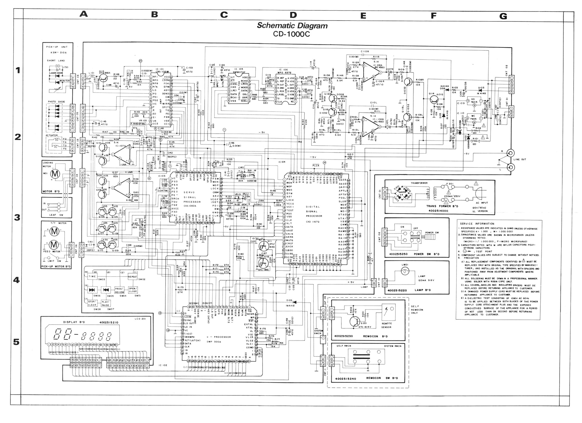

Since the entire player, but for the output stage chips, runs off of those single 7805 & 7905 regulators, it seems very likely that one or the other has either crapped out or fried it's solder connections, except that I now see that the display backlamp runs from +5 to -5 rails, so full brightness lamp means both regulators are putting out. However, you should definitely check for proper voltages from the two regs, and check ac voltage on the same lines as well. If you have more than 100mV AC on either supply line, you've got dying lytic caps before or after the regs, which could flake out the uproc. Stuck button is a good thought, as would be a failed uproc reset circuit, but the player went dead apparently while running, so it rules out both of these scenarios.
From the diagram, looks like a really, really cheaply made player. Doesn't mean it can't sound decent, though.

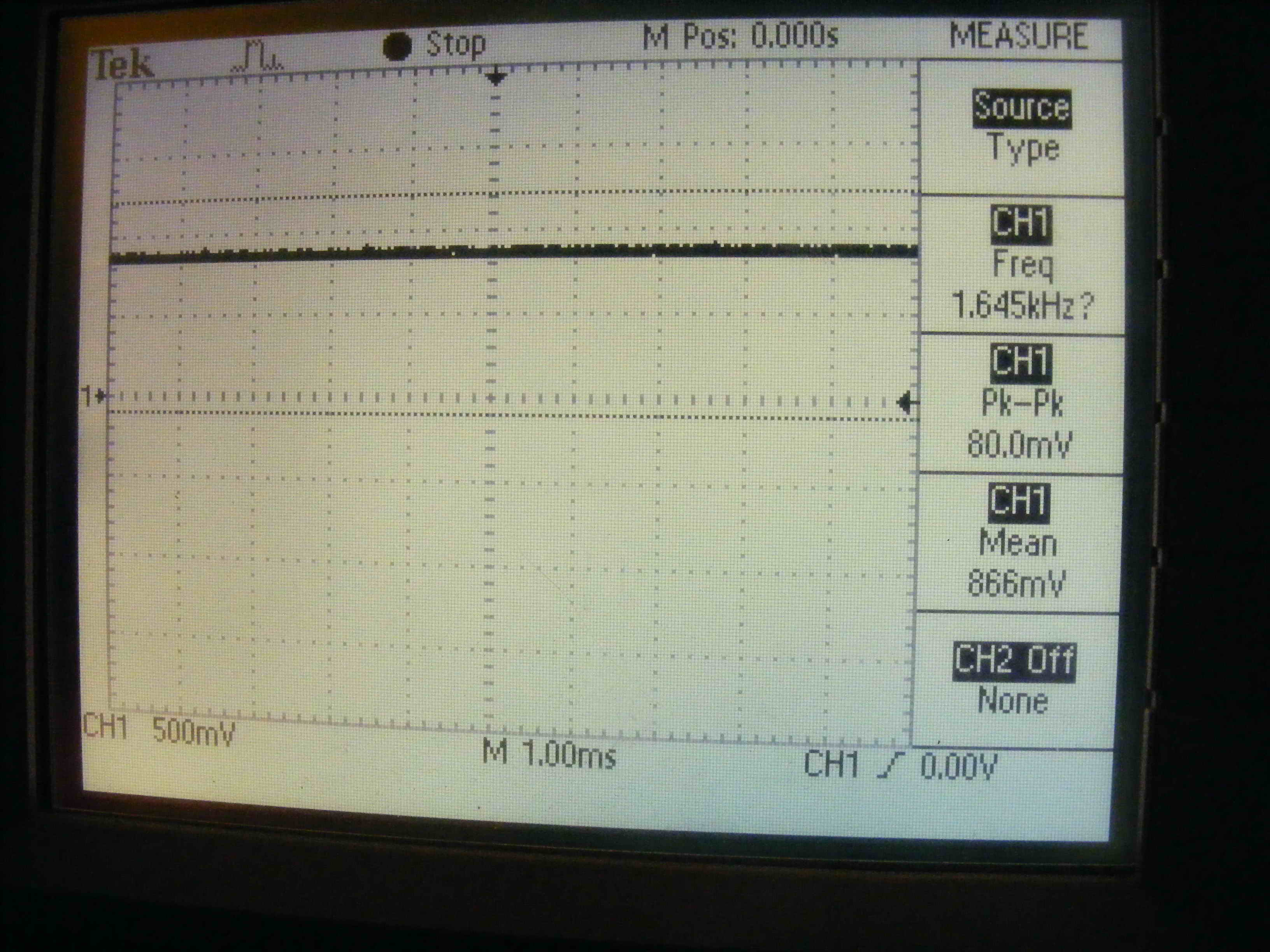

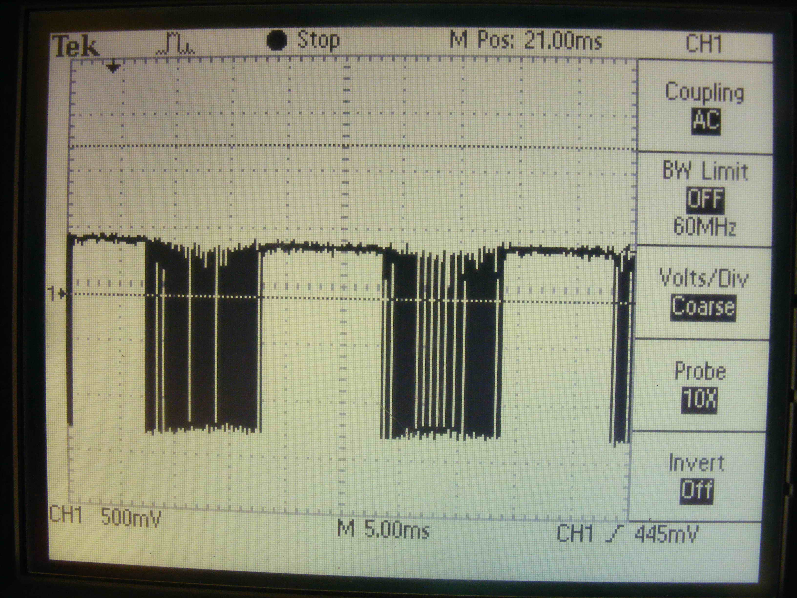

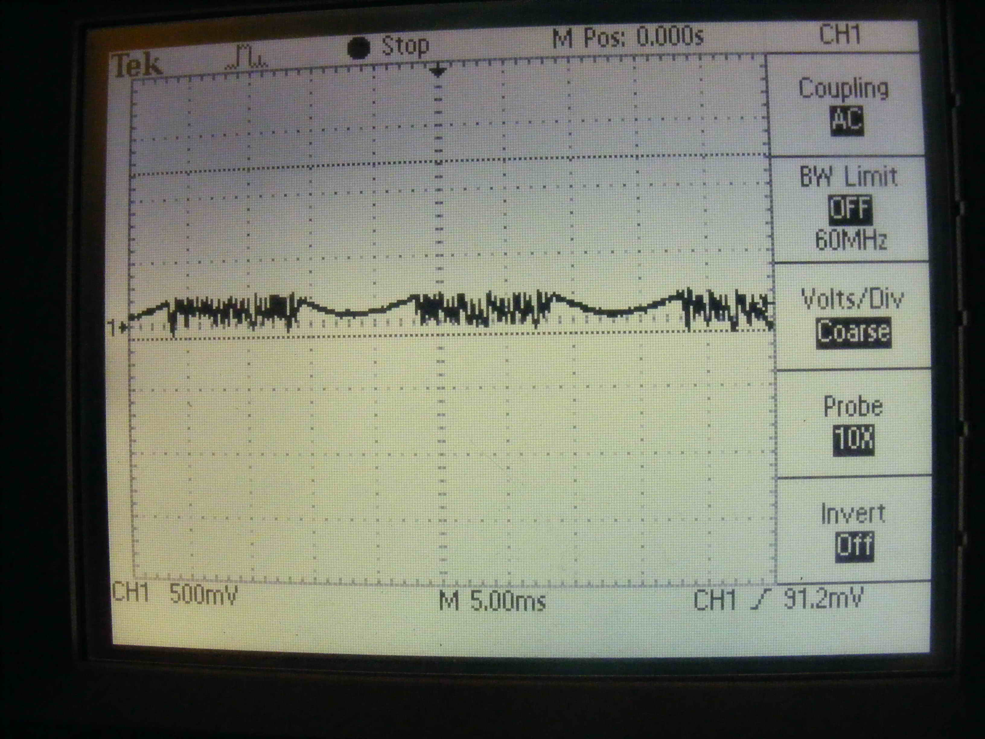

I think the missing clock is the problem... when you power up is there any clock signal on pin 4 of the digital filter which looks like it's the main "clock out" for the whole unit. The oscillator around the crystal may be at low amplitude... it's what comes out of pin that's important. Should be 5 volts pk/pk.
OK, this keeps getting stranger...
Did what you asked.
I get different results every time i switch the CD on.
Most of the times when I switch the CD on, I get only DC (about 80mV) on pin 4 (picture 1). in this "state" I get nothing on pin 2. not even dc - (the oscillator itself).
But sometimes I switch the CD on and get what you see in picture 2, steady. which is strange.
When I get into this "state" pin 2 flickers a signal like in picture 3 every half a second or so.
In any case pin 4 does not look like it should.
I don't understand how come I get a clock signal at the PLL ?
What should I do ?

I would look round that IC really carefully... although it's looking like it may be faulty.
Know it sounds silly but check every pin with the scope, if only to make sure that two adjacent pin aren't shorted with a solder blob somewhere on the PCB. Check the ground pin with the scope too, just to be sure. 5 volts OK on the chip ? If all that proves nothing then it does look like the IC is faulty. No dry joints on the crystal ?

Here are the latest checks and the results:
I have downloaded the data sheet for the digital filter IC and I understood that there are 4 outputs, in use, out if this IC (sm5807). pins 4,12,14,15.
I disconnected the 680 resistors leading out of pins 12,14,15 (R166,R165,R164 respectively) switched on, and nothing much happened.
BUT :
After disconnecting pin 4 (R162) when I switch on and wait for about 10 second, the display appears, very segmented, and slow (only some of the display at any given moment - Multiplexed ?), and if I press a button long enough, I get some action. For example the door open/close button reacts normally after holding it long enough. Plus, I get pickup activity. the pickup moves. (I think it is searching for a CD).😀
At first I didn't understand why everything seems to be slow, but then I hung the 'scope on the resistor's disconnected pin and I saw some (inductive?) 40-50KHz oscillations on it. about 300 times slower than the crystal's freq.
I changed the two caps (18pF) to new 15pF ones just to make sure it's not the caps. and even changed the crystal to another 16.9344Mhz crystal.
No improvement.
I then tried to "inject" a clock signal of my own. I decided to carefully connect my bench oscillator to the resistor's pin and "push" a clock into the circuit (relative to the PCB's ground).
Well this didn't work. I'm not sure why.
Maybe because my bench oscillator only gets to about 10MHz. I didn't have the guts to drive the signal above 4V PK-PK, so this could be another reason.
If anyone can think of anything more I can check aside from replacing the sm5807 I will be happy to do so.
