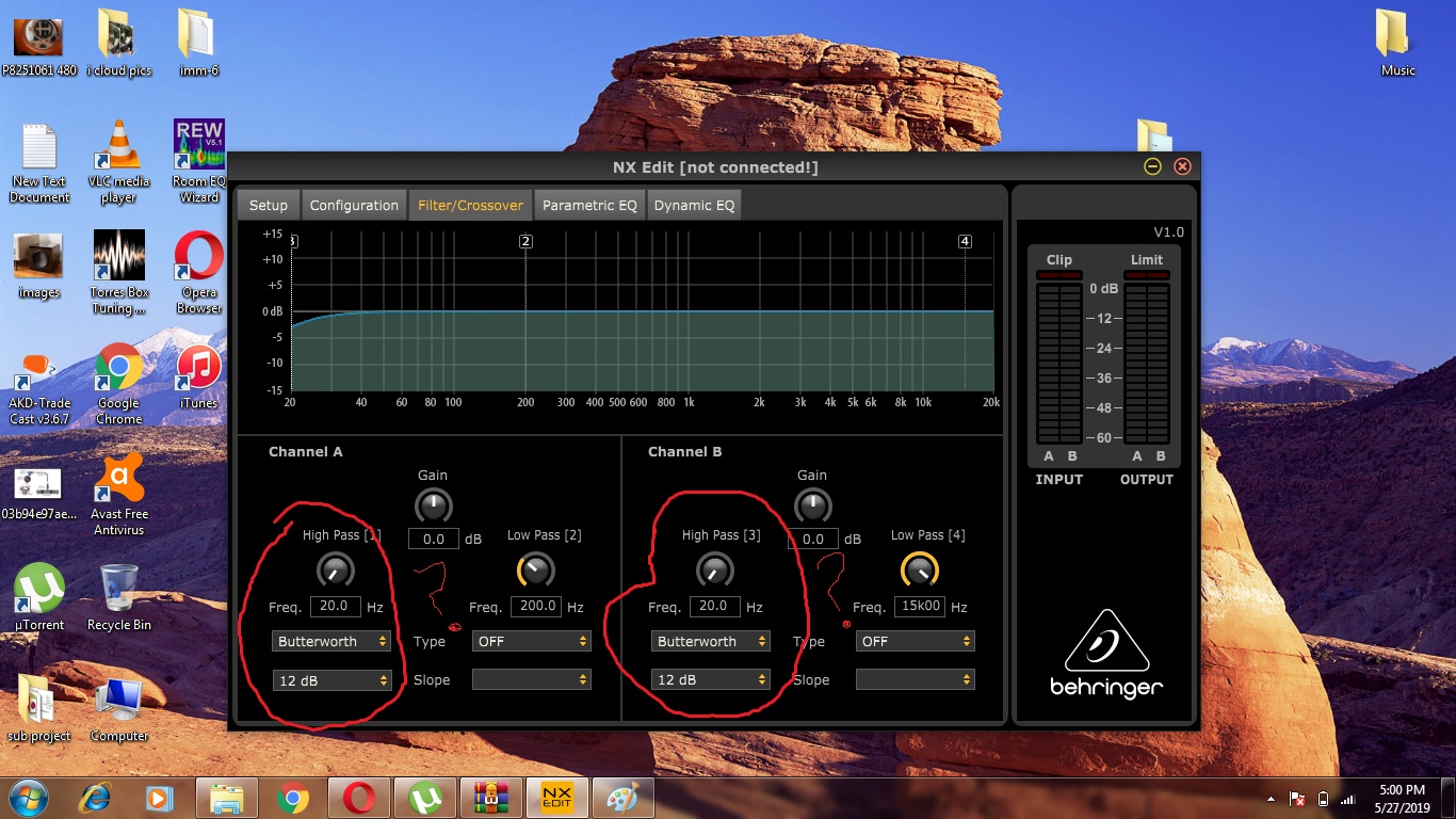

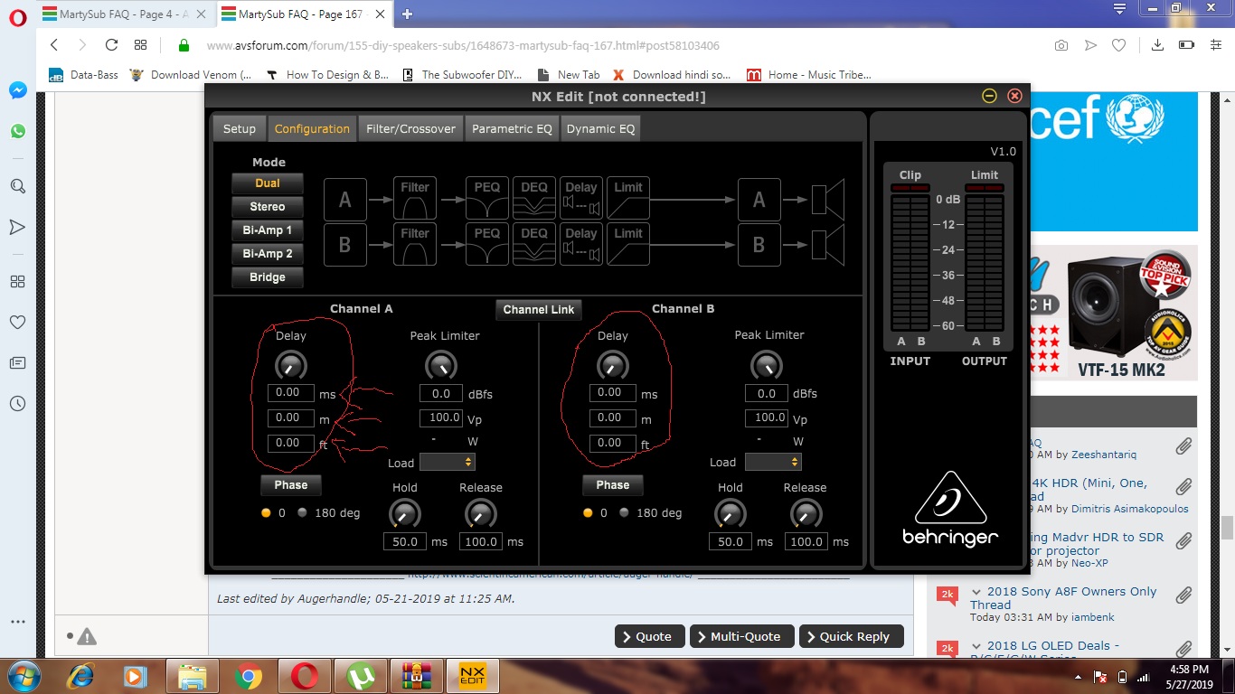

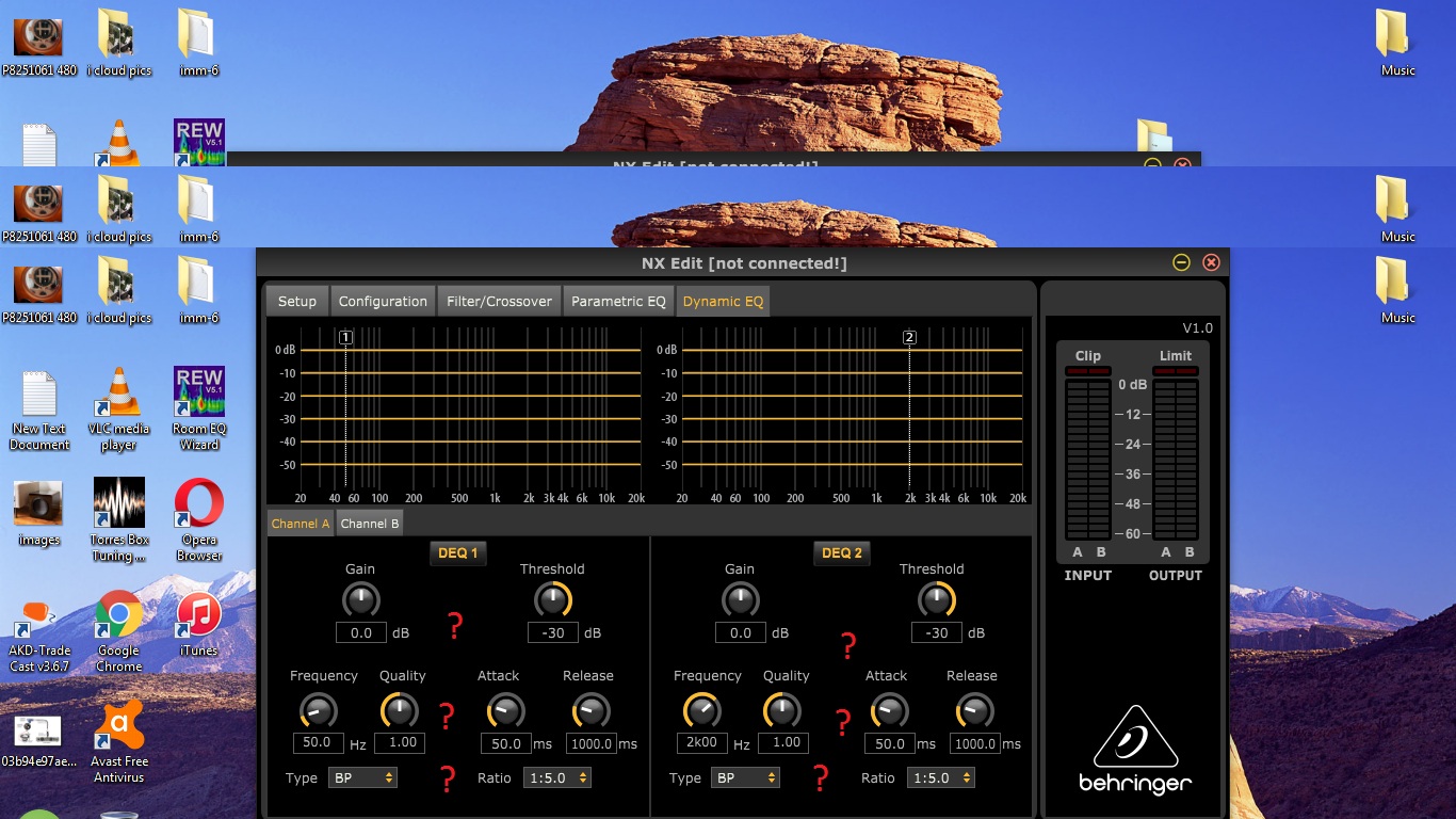

i have made dual Full Marty Cabinets and put dayton Ultimax UM-18 pushing these monster with Inuke NX6000D. i just want to know what setting should i do to prevent inuke from clipping and at factory setting my subs wont sound great and when i turn the gain hight from inside the amplifiers DSP which im operating from laptop sofware make sound better but amplifier signal light touch cliping light so quick. im a noob in these diy stuff bt ready searching and asking so many question i finally made the subs and listening them now ill be very happy if someone can help me setting up my problem which im facing. im sharing all the pictures of my dsp setting plz let me know where to set the eq,peq,dec, and rest of the things. ill be really greatfull u experts can help me oout.

Ok.. do you have the limiter set? I saw another discussion that suggested these drivers should be limited to 1500w or so.
clipping the amp is because to hot input signal. so instead of setting a limiter, which basically is limiting the Input signal, lower the input signal., also try to set hp filter to 20hz 24db/bw and LP to about 80hz 24db/bw. in this range you really do not need to touch eq/peq. it's useless anyway without rta or a measurement in the room.
also check if you wired everything correctly.
