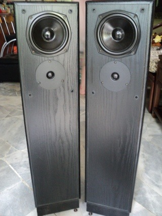

These are 30 year old Purdey( 75 X 15 X 22cm) floor standing two way speakers. I have no way of testing anything other than a multimeter. They are so old I plan on replacing the tweeters, woofers and crossovers. The current woofers are 5" 40 watts. They are blown. The owner does not want to throw out the enclosures and simply buy new speakers which is what I, and many others, have advised.
So two new woofers, two tweeters and two crossovers needed. I have selected cheap reasonable looking 8 ohm woofers and tweeters that can handle the 35 watts from the amp. I need crossovers around the 3khz range.
Reasonable stereo sound is the aim here. It's clear i think that audiophile satisfaction is not the goal.
If these are the speakers to which you refer, they're 'Revolver Purdey" with an unspecified 5.5" mid and a 3/4" Vifa tweeter.

As usual pictures of the speakers in question as well as pix of the drivers/tweeters and the existing crossover will help.

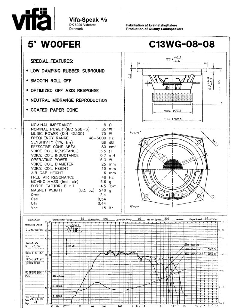

I'm pretty sure that the woofer and tweeter are both Vifa; the C13MG and the D-19.Spec's available at nedlabs
Well spotted, I think you're right. Neither of those drivers are cheap, unfortunately; a UK firm has the tweeters for 26 pounds; a well known mail order site, for A$70 each. Ouch. The D19s are specified as 8 ohms.
However, Digikey has one which looks almost the same for A$29:
https://www.digikey.com.au/en/products/detail/peerless-by-tymphany/D19TD05-08/6557405
I couldn't find the exact C13s but a very similar Vifa C13 was going for US$60 each.
Specs:
Armed with the specs, and assuming the OP hasn't purchased the drivers, people may be able to suggest alternatives.
Geoff

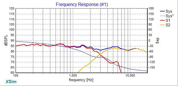

As for the crossover, Ralf Giralfino of this Forum kindly posted his design for a bookshelf design using those drivers; I've made them and they sound very good. The crossover point is about 2600 Hz.
However, and importantly, the Purdeys are small towers and not bookshelves, and have a different driver layout on the baffle, e.g the tweeter is on the bottom.
It would be polite to send Ralf a PM (use the email link at the top of this page) to see if he has any comments. His crossover is designed for a bookshelf, smaller volume than your boxes, and with the tweeter on top.

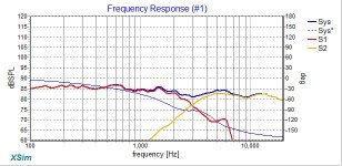

Alternatively, I've attached a crossover for the same drivers which I based on a German DIY tower design, but tweaked to allow for the BC25TG tweeter. However, it was only simmed as I don't have measuring equipment. The tweeter is connected with reverse polarity.
