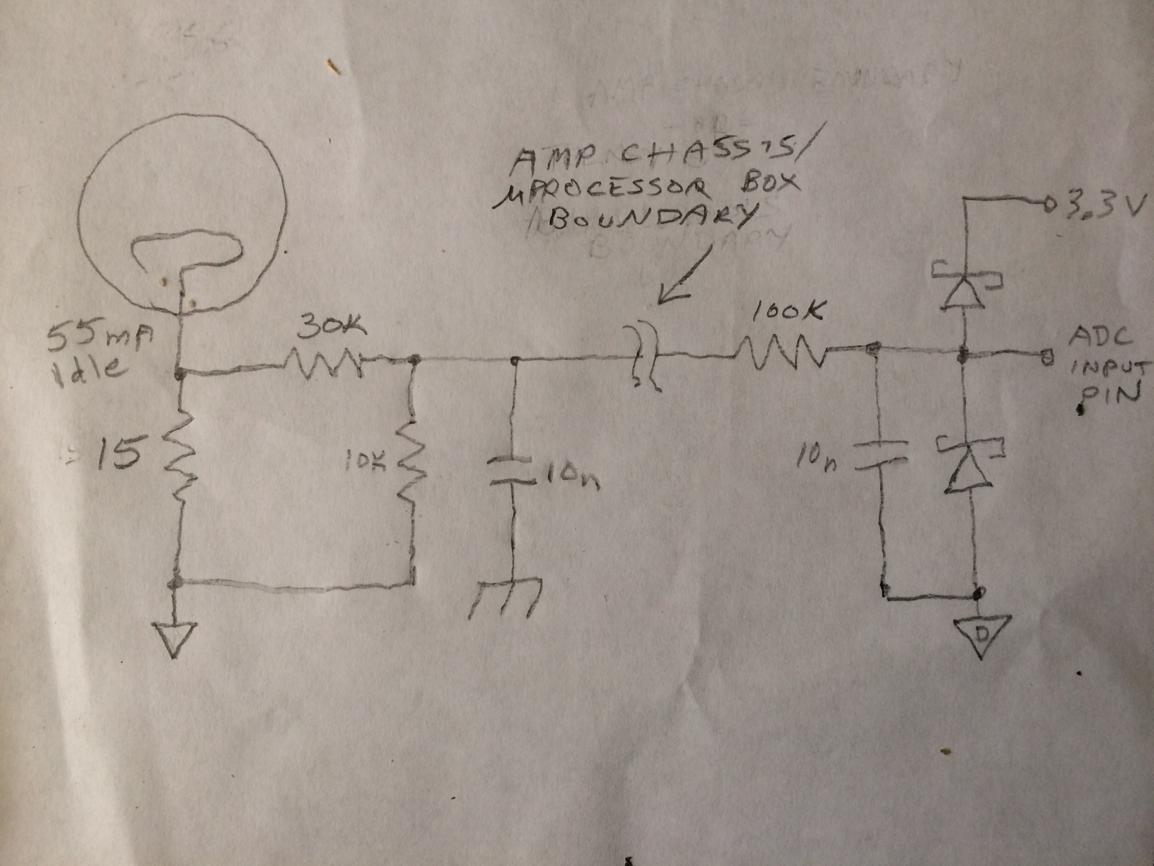

I'm in the planning stage to make a microprocessor monitor (and
possibly bias controller) for a tube amp. I have a good understanding
of tube amps, microprocessors, and code, but solid state electronics
is a gap in my knowledge. I'll probably use a Teensy, because they're
cheap, easy, and there's lots of easy to work with peripherals (it is
arduino compatible).
For the first iteration, very simple, I would only be monitoring the
bias at the output tube cathodes. The amp would be shut off via a
relay if the bias current on any tube went too high or too low.
Second iteration, I might want to detect the presence of a music
signal, shutting the amp off if idling too long (e.g. an hour or so).
The third iteration, if I go that far, would be controlling the bias.
So the part I don't know much about, is what are the considerations
for interfacing the processor with the amp? First, the ADC input will
need to be protected from overvoltage. I'm not sure simple Zener
clamping will be sufficient. Is there some sort of failsafe chip
available that will limit a voltage to 3.0V or so (assuming 3.3V
processor supply).
Second, I'll want to filter noise in both directions. For a current
sense resistor on a cathode, maybe some sort of buffer device,
followed by a pi filter. For bias checking, the low pass could be
below 20hz, but for detection of signal it would need to be higher.
Some of the low pass filtering of the detected bias current could be
in code rather than hardware.
For bias control, I think a digipot would be suitable, noise filtering
would be the only issue.
The processor would of course be in a shielded metal box, and might
also be external to the amplifier.
Thanks in advance for your thoughts.

Actually no, it wouldn't be very good at all - low voltage Zener's have very soft cutoff and to protect against exceeding 3.6V in you'd need something like a 2.5V Zener or lower, and most importantly it would do nothing at all if the microcontroller happened to be powered down...First, the ADC input will
The best way to protect CMOS logic signals is with a series resistor and two Schottky diodes to the rails, preventing them from straying outside the rails by more than about 0.3V whether powered up or not. Dual surface mount Schottkys like the BAT54S are used in the billions for this purpose, if you're happy with surface mount.
If you have a voltage divider already, it can act as the series resistance for free.
If you want high impedance voltage divider, add a ~10nF cap to ground as part of the divider to present a low impedance to the ADC (otherwise it'll be less accurate). This will affect the bandwidth (which might be good - if noise is an issue, or bad if you have to react fast).
If you want to sense negative voltages you can use an inverted divider to Vdd of the microcontroller, no need for opamps.
with voltage dividers from very high voltage parts of the circuit its wise to check the voltage rating of your resistors and use series strings of resistors where necessary.
Tubelab_com:
You mean digipot? Yes, you won't ever find CMOS chips above 18V to my knowledge. But for generating voltages digitally you use a DAC, not a pot (its a common mistake I see, people thinking you need a digital pot to generate an adjustable voltage because the equivalent analog circuit uses a pot!!) Digipots are used for controlling an analog signal without having to digitize it.E-pots for voltages above 15 volts or so didn't exist then, and may not now
There are some nice little (multichannel) DACs with internal persistent storage that you can use as programmable voltage sources - they remember their state across power down so they are all setup before the microcontroller has initialized.

Thanks, although I consider the first iteration a "simple, lazy" voltage monitor, for an existing amp. Something simple like, A) warning LED if any tube wanders 5% off current, warn if pair current mismatch by 2%, shut down if any tube 20% off current.
I've probably seen the existing thread in previous searches, but I don't remember finding definitive solutions to the interfacing problems. I'm hoping power up conditions can be dealt with simply by relaxing the monitoring rules for the first 30 seconds or so.
I suppose runaway tube protection could be added with analog electronics/discrete logic, but I have basically zero experience with that, and if I want to add features it will get complicated quick.
To answer the specific questions, I know of no special chip that will provide the protection you seek for the micro inputs. You will most likely need to add this yourself. A 3V zener by itself is unlikely to be sufficient. However, four signal diodes in series will limit inputs to 2.8V. To this I would recommend you add a current limiting resistor which can also form one leg of a low pass filter. Since your sampling rate is likely to be much high that the rate of change of the input even under fault conditions you could apply additional smoothing in software.
Thanks, Ian. Yeah, tube amps are definitely in the category of "we do them because we want to", but I also like the way they sound. I'm still kicking around what the sampling rate might be, It could be at a frequency below the audio range, if I don't want to detect an audio signal. I'm not really sure how fast a tube can red plate, but the few times I've seen it happen it appears fairly instant.

I've seen that article, I'm definitely not going that complex! Useful info there for current monitoring, thank you.

Sounds good, I'll give that a try. I'm not thrilled with surface mount, but if they're not little grains of sand, I can deal with it.The best way to protect CMOS logic signals is with a series resistor and two Schottky diodes to the rails, preventing them from straying outside the rails by more than about 0.3V whether powered up or not. Dual surface mount Schottkys like the BAT54S are used in the billions for this purpose, if you're happy with surface mount.
The cap to ground will be a good idea, bandwidth is not important here.If you want high impedance voltage divider, add a ~10nF cap to ground as part of the divider to present a low impedance to the ADC (otherwise it'll be less accurate). This will affect the bandwidth (which might be good - if noise is an issue, or bad if you have to react fast).
Tubelab_com:
The pair of Schottkys, one or two resistors, and a cap has become the standard input on nearly every modular synthesizer system built recently, since you have no control over what someone will plug into it.
E-pot, digipot, yes. Microchip has (or had) some rated for a single 36 volt supply, or +/- 18 volts. I don't know if they still exist. MCP41HVX1 (SPI) and MCP45HVX1 (I2C) are the part numbers. I used an opamp and DAC circuit running from a -150 volt supply. The Microchip DAC chip that I used powered up so that the bias was at the negative rail. After a suitable delay, the tube current is ramped up. A crafty programmer can measure the cathode current change during ramp up to test the Gm of the associated tube VS cathode current. Yes, an amp that tests its own tubes.
I would do something like that for the tube current sensing.

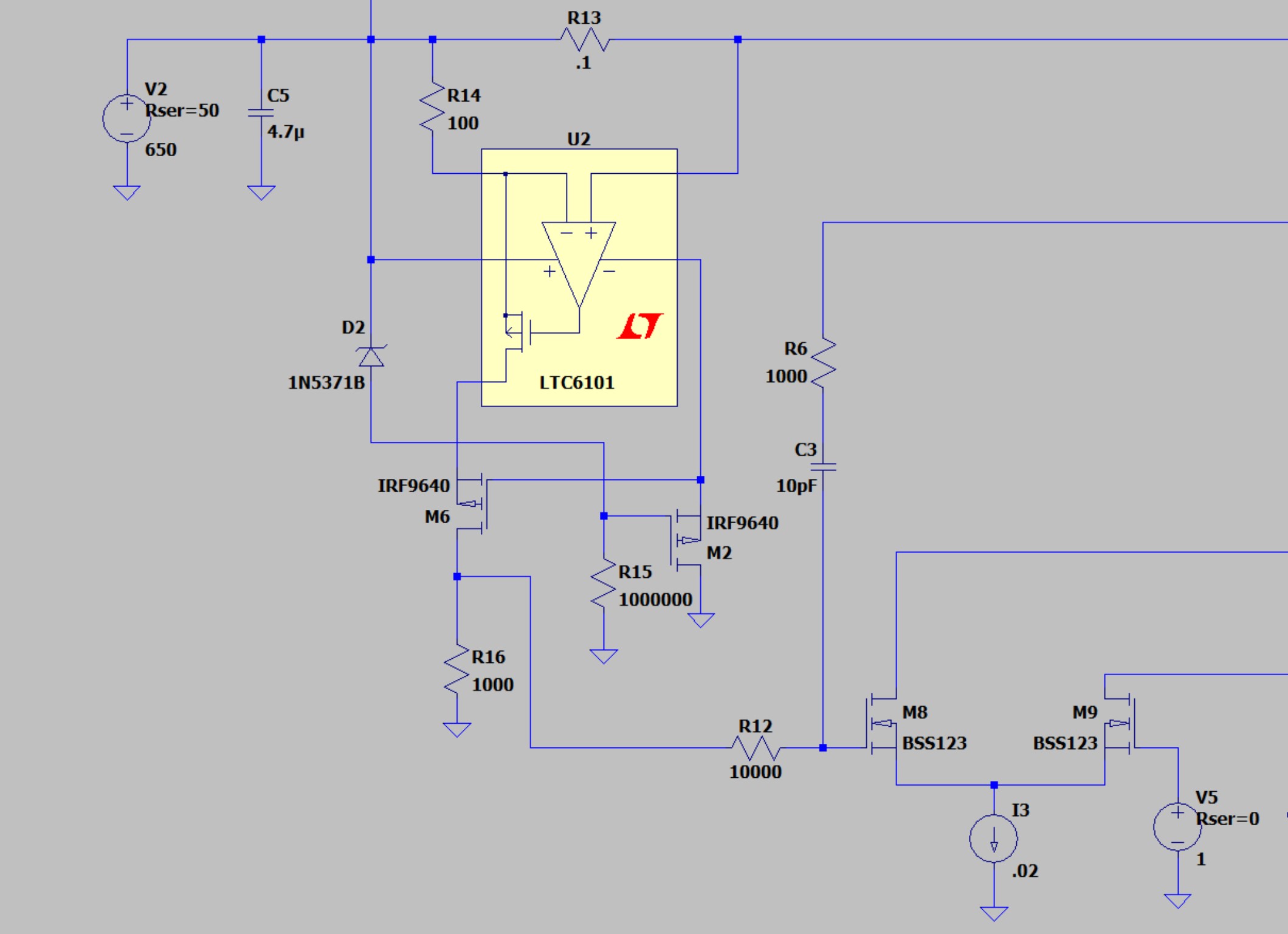

I have used a little "high side current sense" chip in a trick circuit to measure screen grid current with a microprocessor. This is very important to monitor in a high powered amp using big TV sweep tubes, since this is the most reliable indicator of tube stress in any audio amp that may be driven near or into clipping. The Teensy will calculate the screen grid dissipation and take action of the AVERAGE dissipation approaches or exceeds the maximum spec.
I used the chip in a power supply design to provide current limiting. The same circuit can be used to measure current in a high voltage application. The voltage supply is represented by the 650 volt source. The load is to the right of the sense resistor (0.1 ohm in this application). A current proportional to the load current is forced through the 1K resistor, so the voltage across that resistor is proportional to the load current. I used a 10K resistor for isolation and protection in my circuit. I would add the clamp diodes when connecting this to a Teensy. The circuit is also on page 18 of the LTC6101 data sheet.

I didn't know about that kind of current sense chip, thanks for the tip. I was ignoring the elephant in the screens because I had no idea how to deal with it. Not as critical with EL34s I suppose.
