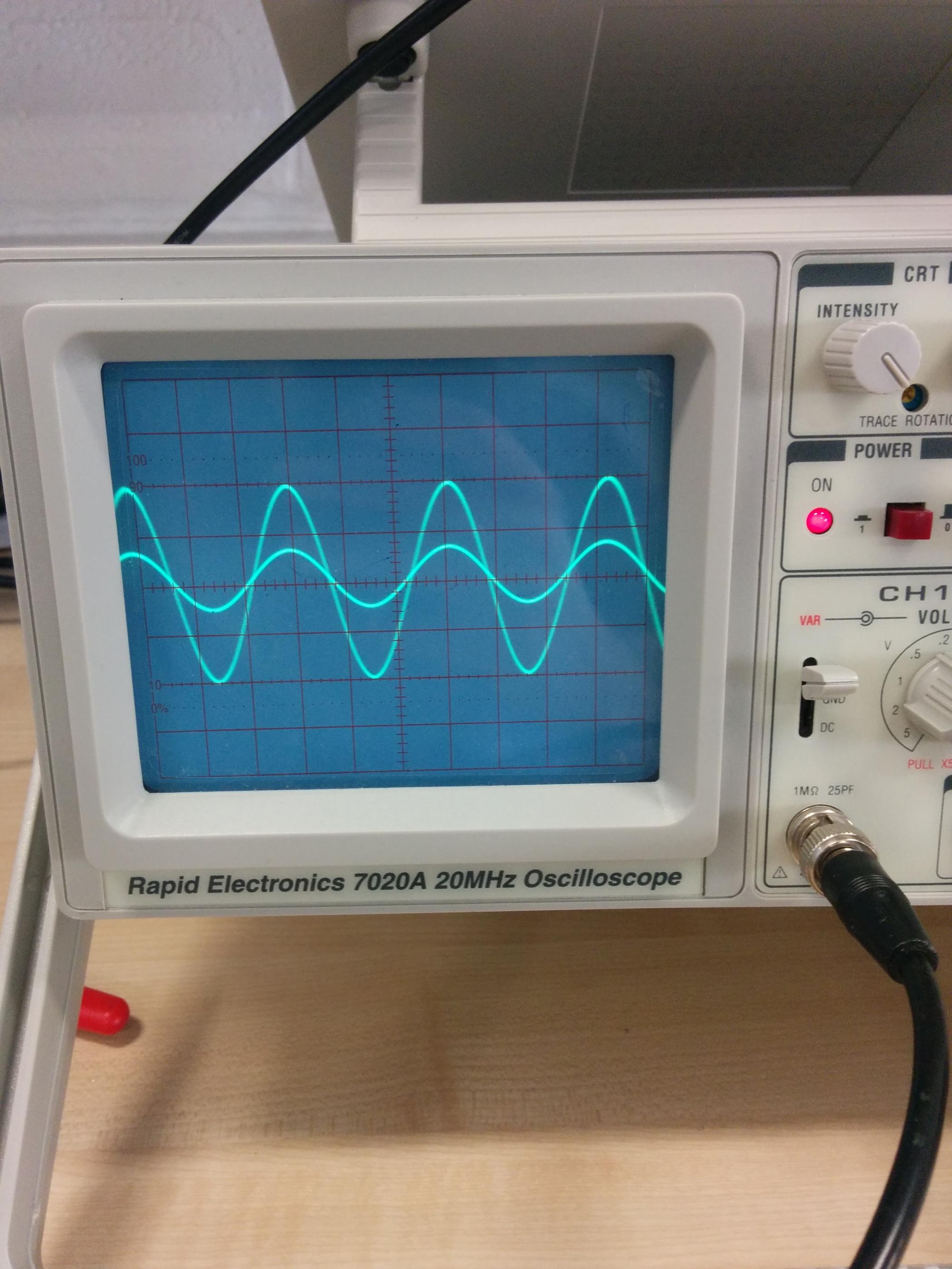

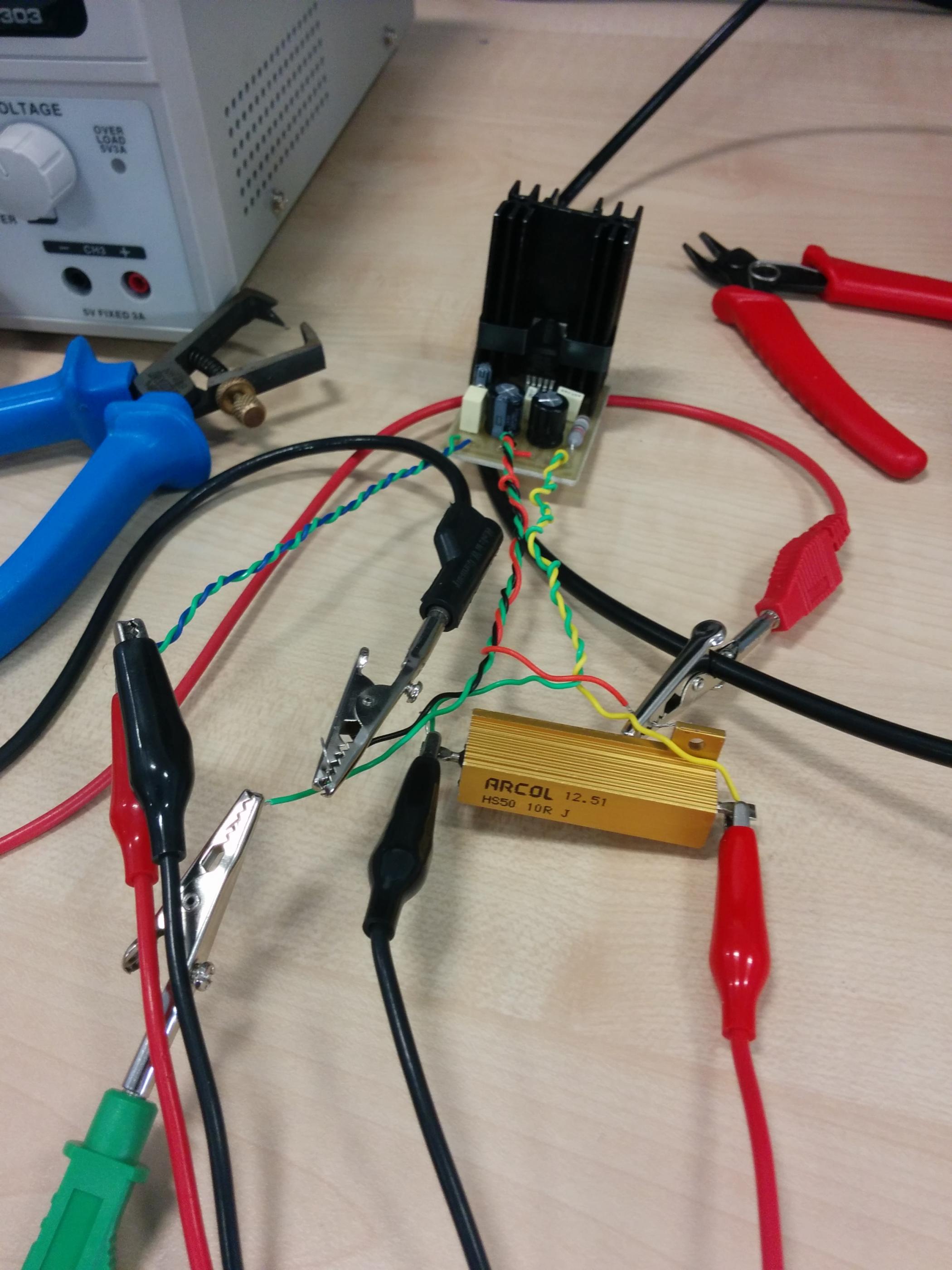

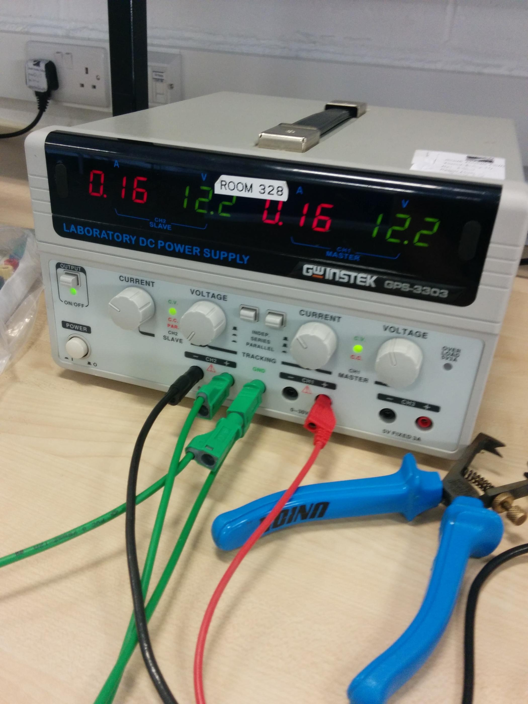

For a project at college we have to make a product of our own choice, so I decided to make a bookshelf speaker system. for this I have to make a passive crossover. I've designed it and made it, now I just need to test it. my lecturer said I need a amplifier with it, so I've used one I made last year. (I'm not sure why I need one so if you can tell me why that would be brilliant)
I set it up using a oscilloscope and function generator, however when testing the amplifier I have no idea what I am looking for, and the same goes for testing the amplifier with the crossover. the crossover is designed to spilt the frequency at 4000Hz. I will include some pictures I took when I was testing the amplifier for reference.

It would probably help if you posted the crossover diagram. You need the amplifier to drive the crossover with some real voltage and then observe the voltage across the two (I'm assuming its a two way speaker) drivers and make sure each receives the correct part of the spectrum.
So you need it all wired up with the actual speakers to be able to test it.

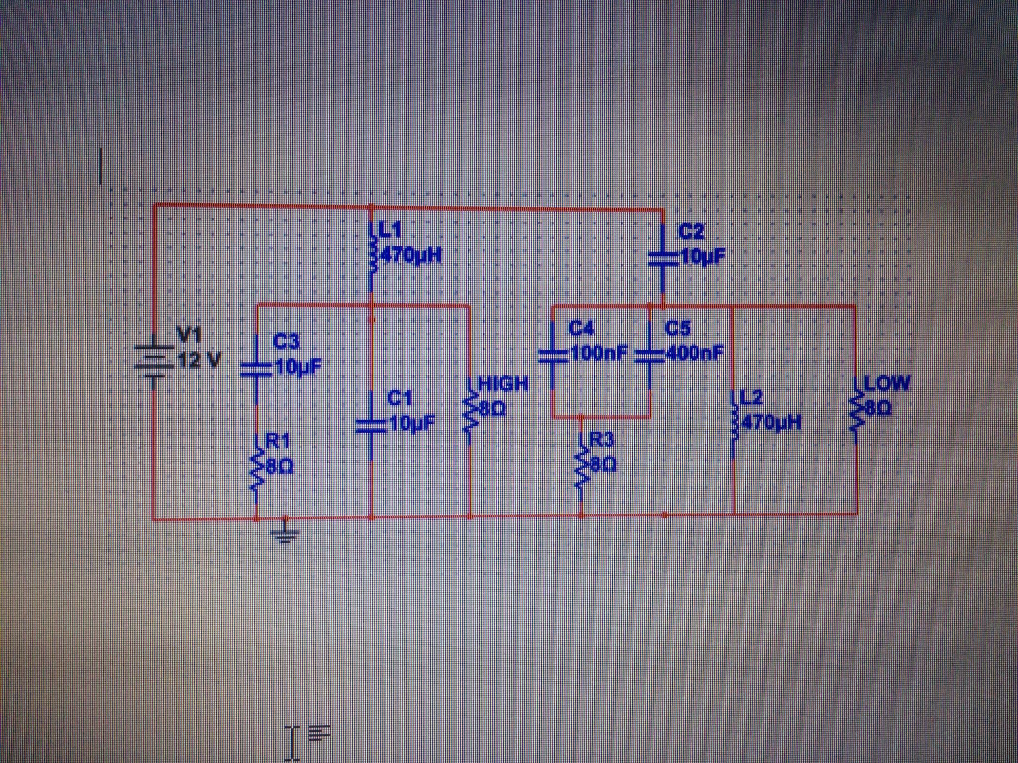

Ahh okay thanks. the college provided me with a 8 ohm resistor to use instead of my speakers, so should I use those? and yes it is a 2 way crossover. I've include a word file with a picture of the crossover design, I've mis-labelled the high and low on the diagram so I apologise about that.

That looks quite sophisticated. The actual speakers have very different properties compared to a simple 8 ohm resistor, specifically the inductance of the drive units and their 'impedance' which will vary with applied frequency. At a basic level though you can still demonstrate that the crossover works OK with resistors.

Its a textbook x/o with zobels on both drivers and
no driver EQ, BSC or relative driver attenuation.
Using 8R loads to test it you need to add driver inductance
to the test loads to reflect the zobel values, then everything
will measure hunkydory, but still be very wrong in reality.
rgds, sreten.
The V1 voltage source should be AC, not DC.

Yes. How can the OP make something he doesn't understand. Using a SPICE MODEL would be closer to reality than a 8R resistor with a different new set of problems. No speaker driver measures 8 for Re anyway. It's just a way of faking something that is not going to work as intended. OP (racer), you have to deconstruct your technically filled mind first... to start with speakers, they are very easy and not complicated as you intend.

The pic of the oscilloscope in the OP indicates there are two traces. I presume this is a dual trace oscilloscope.
To test the XO, you need to hook up the probes to the amp outputs (Vin) to measure the sine wave voltage on the scope. Take the second set of probes and place them across the 8 ohm dummy load (Vout) and compare the traces. I suggest you run the comparisons at 1 kHz, 4 kHz (xo point) and 7 kHz and compare the sine wave plots and take pics of the scope screen for a record of your results.
