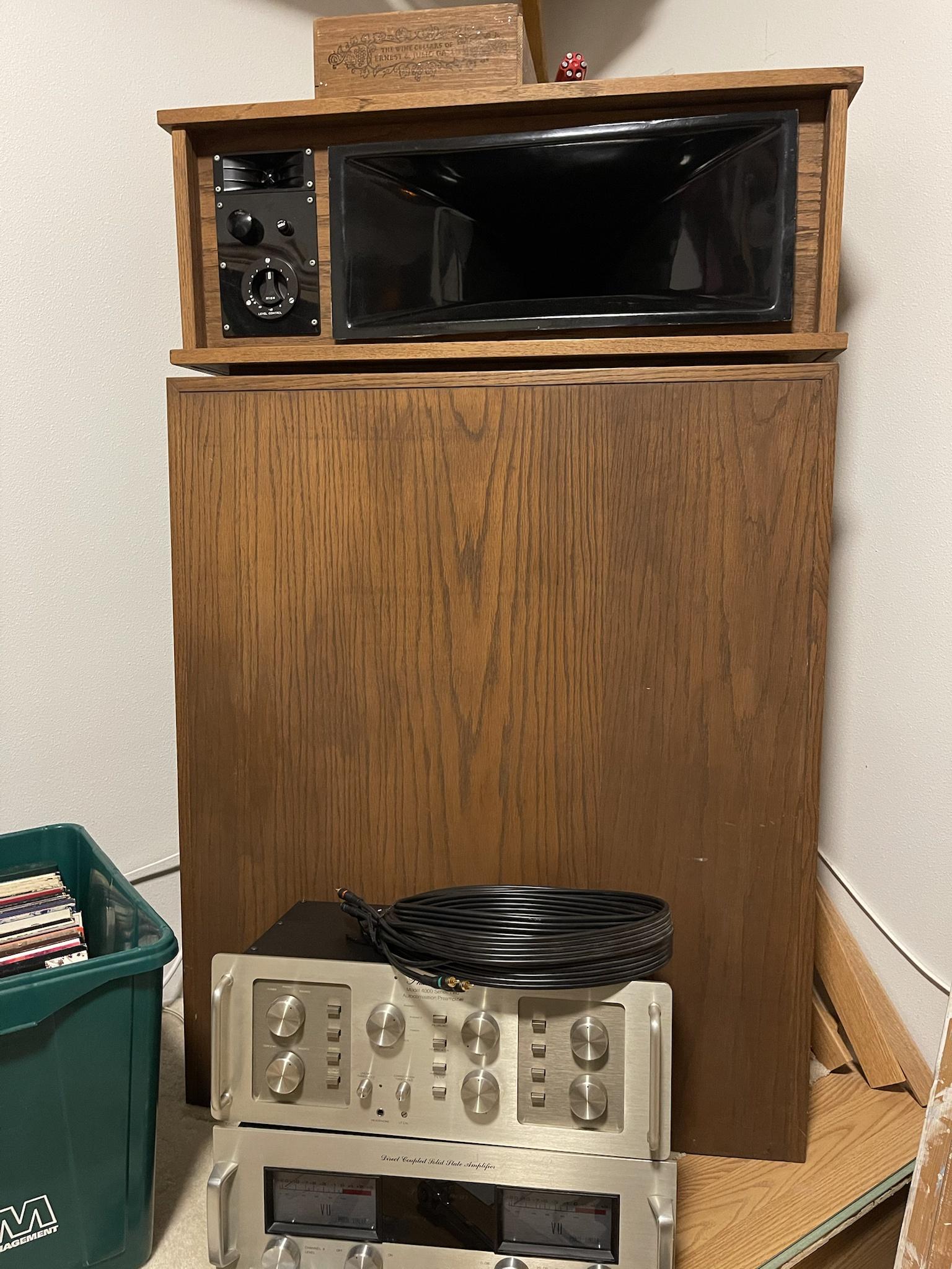

So it’s been an easy week in school so I decided to try my dad’s corner horns he built 50 years ago. After moving a couple wires around to what would make most sense, I managed to get them working. Only problem is, they sound bad! I’m just a high school kid but i'm guessing it’s from the old wiring and crossover components. Since you guys will know best, how should I approach the renewal of these beautiful speakers? Recommendations on new, quality parts?
I'll make a guess that you have a three way, with two piezo driven horns and a bifurcated bass horn. There are two level controls and a fuse. The crossover seems to have a few inductors.
Are all the drivers working and adjusted?

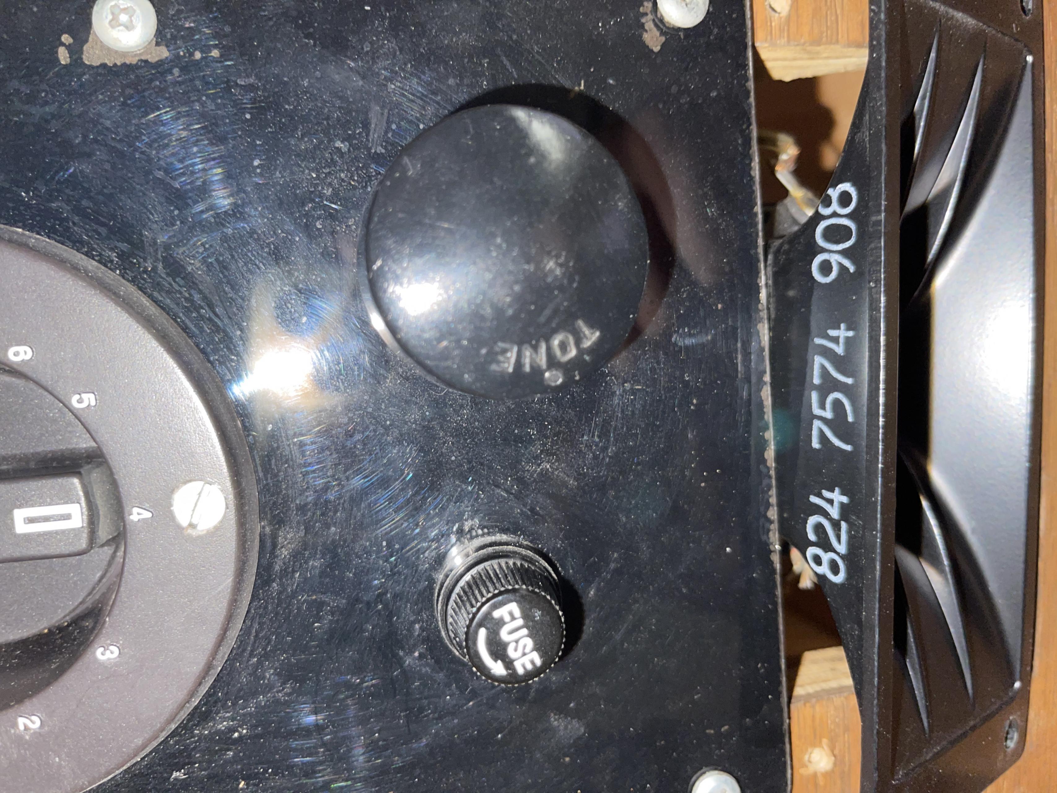

The two volume control looking devices at the top left of the speaker should control the level of mid and tweeter. If these have been bumped, then you would turn them both to minimum and take it from there.

Then, note the positions of all controls on the amps (take a good photo), move them and return them, then study their function.

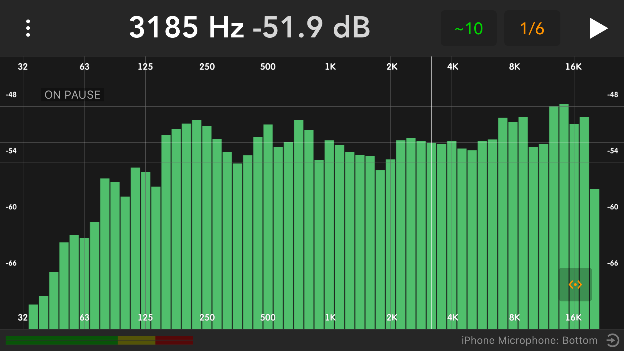

You need some test equipment. Here's what I'd do.
1. Go find a nice, long Pink noise .mp3 recording and put it on an SD card.
2. Many small amplifiers on ebay read SD cards and have the full audio spectrum power out. Get one. Get a battery pack setup for it; some even use 5V!
3. You phone's mic is good enough to tell if the three drivers in these cabs are working and if they're balanced. You'll need an audio spectrum analyzer program for your phone. Both free and paid version will work.
4. Put the SD card in the amplifier, connect it to one of the speakers and power it up. It should start playing the .mp3 file on the card. It will sound like a waterfall...
5. Bring up your phone app, select the best microphone on the phone (if the app doesn't do that for you) and have it display a spectrum, 20 - 20kHz.
6. When you set the app to do octave measurements, it should produce a somewhat "flat" frequency response - see attached. You can increase the resolution by choosing the octave fraction (1/6); it should still display a fairly flat curve on the phone screen.
If there's blocks missing, that would indicate a driver not working. A block might be all indication above 10kHz for example. Or everything below 1kHz. Or the frequency levels that are in-between.
If they're all there, but each section looks like it's on it's own shelf in level, that indicates the level controls need to be adjusted. Adjust until all three blocks align as close to a single straight line as you can get it.
Using your phone and a cheap amplifier off ebay, you can diagnose these speakers and perhaps set them up for how your dad intended them to run. If not, then you can fix it by perhaps replacing some of the electrical work he did, obviously building components by hand. Even if you replace the crossovers he made with something entirely different, you can still use your phone / amp combo to measure the results. And make the adjustments, to get it right.

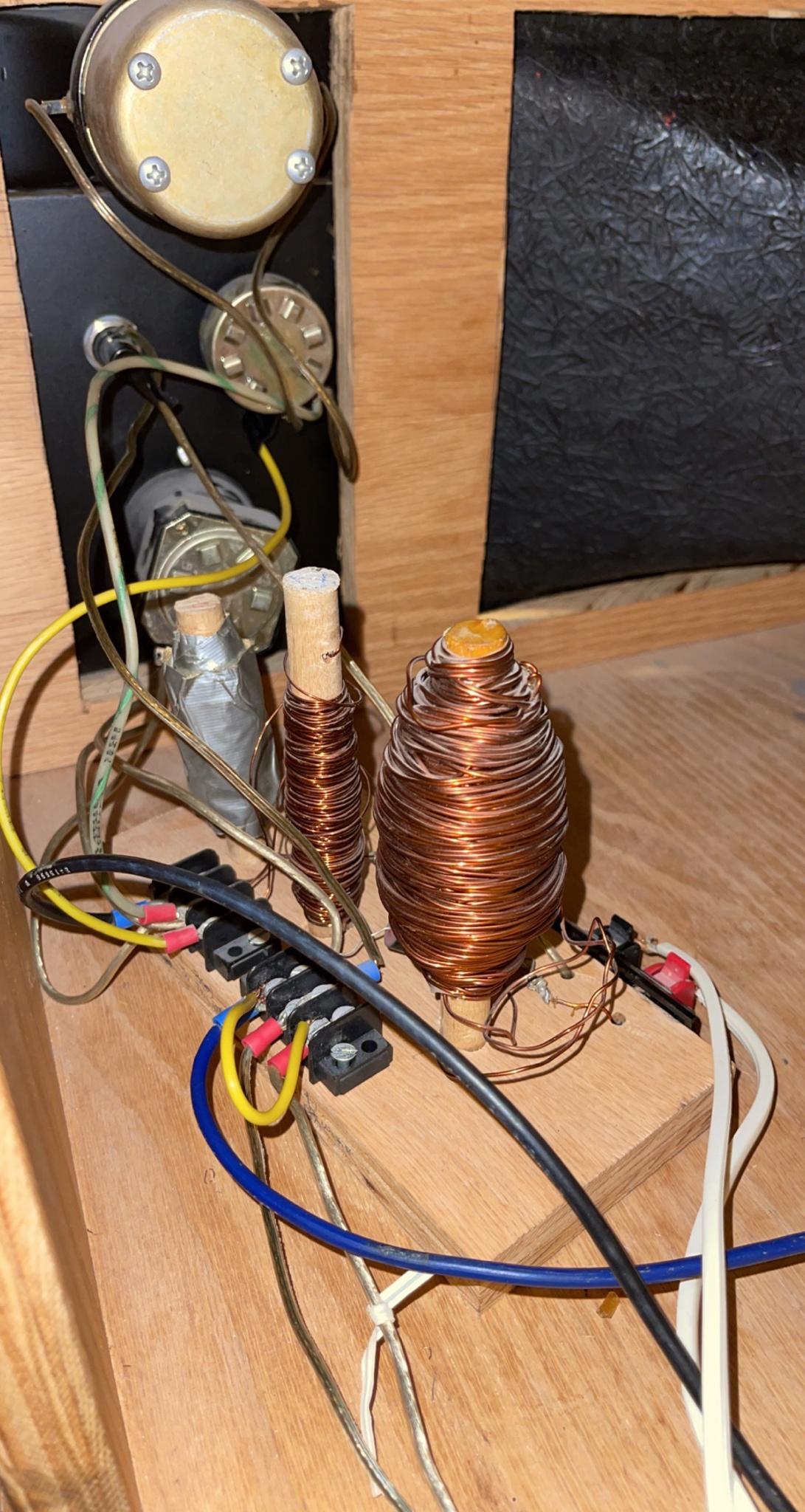

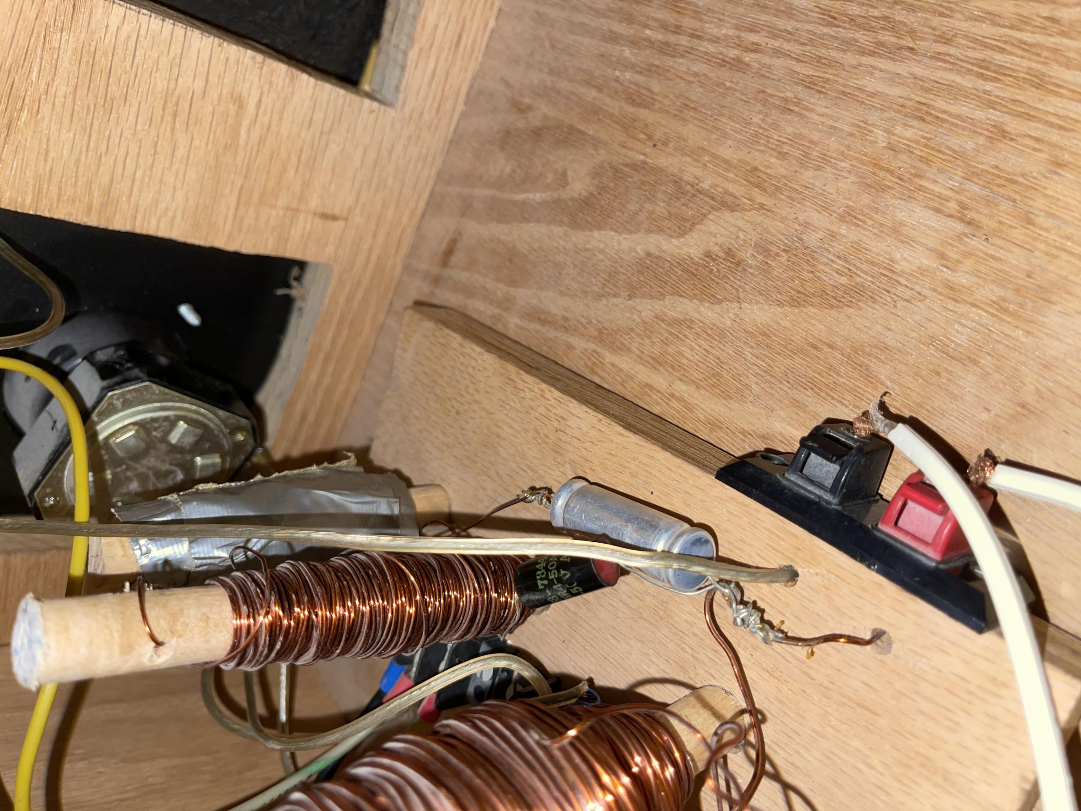

The woofer inductor looks like paralleled thin zip cord (?) Klipsch used 2.5mH "1st order" with 4 ohm rated woofers.
IF just a cap feeds the T-35 rectangular horn tweeter, then that probably should not be more than 2.5-3uF value. (I've popped T35 diaphragms...)
If you can open the woofer chamber, try testing the woofer disconnected from the crossover by itself with a flashlight battery, then music, listening for static or voice coil rubbing. Take a picture of the woofer.

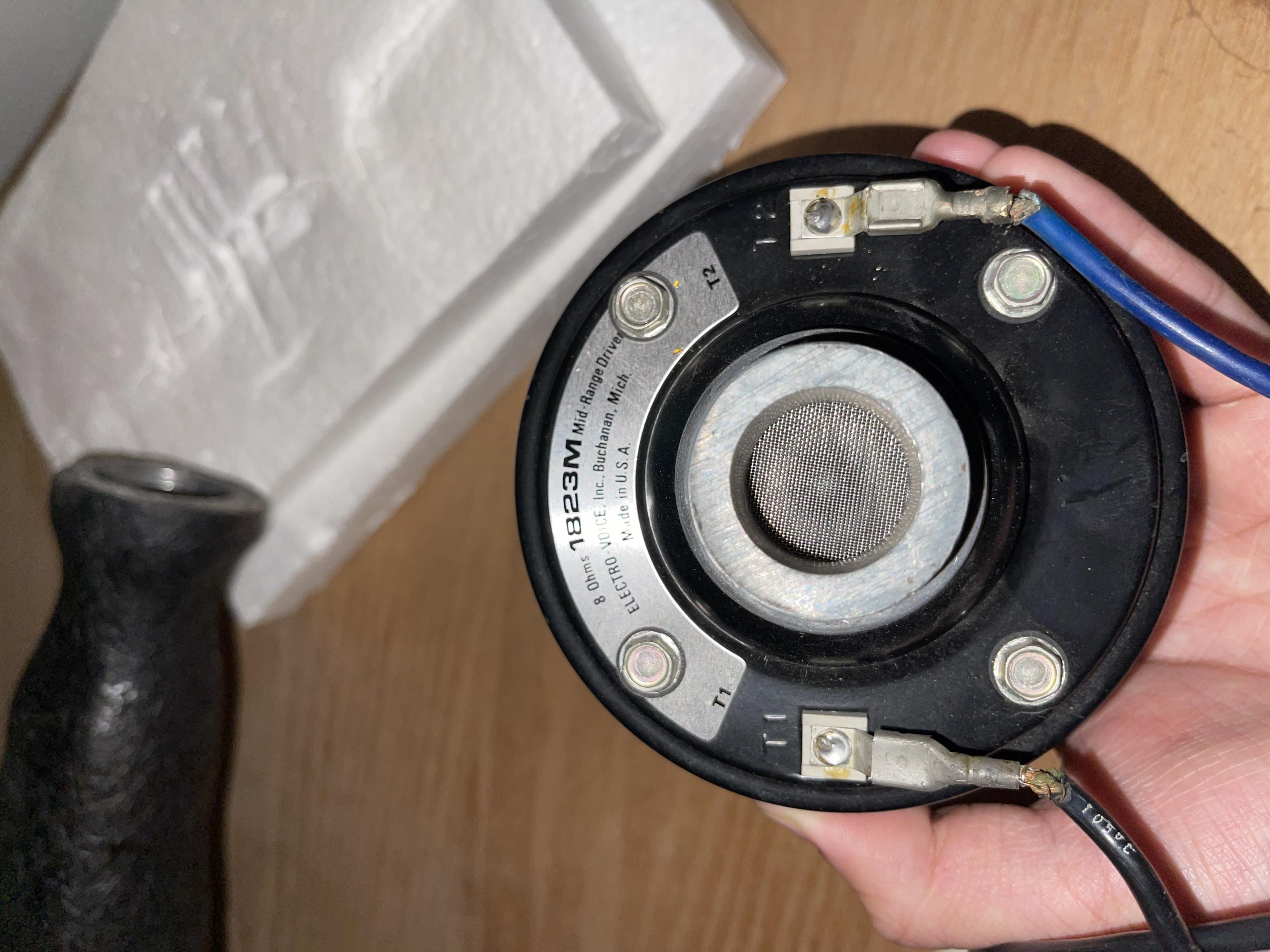

Also, upload a picture of the midhorn's driver. There should be a capacitor associated with it - perhaps in the 12 to 30uF range.

That is a great looking horn build.

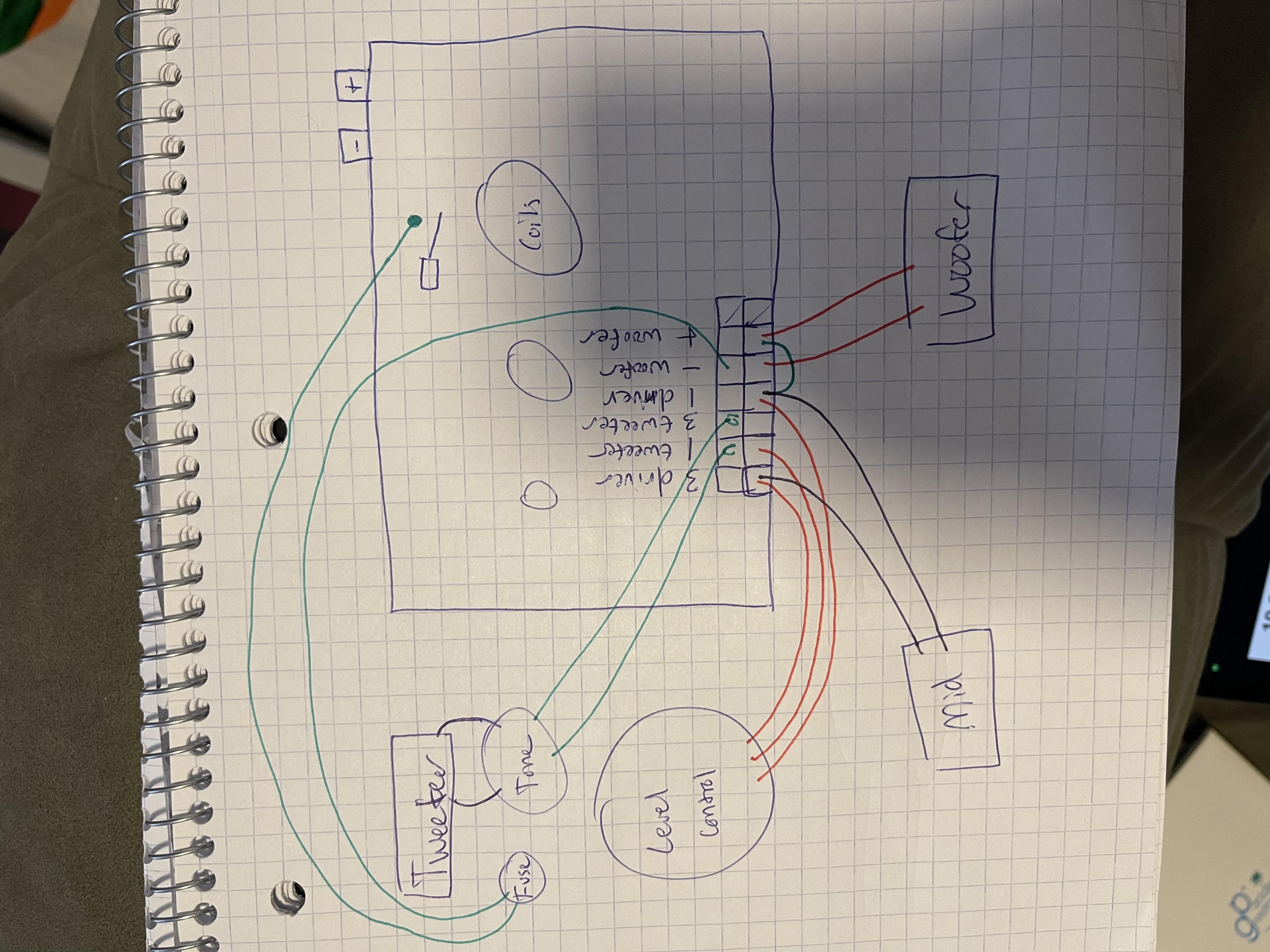

I’m not exactly sure what you mean by the first sentence. And are you asking for a wiring diagram?
It is likely you have a 2nd order filter on the small tweeter. That is a cap in series and one of the chokes in parallel with the driver. That is a High Pass filter.
It is likely you have either the same configuration on the midrange horn allowing it to run unfiltered on the top end or both a cap and coil in series, cutting off the top and bottom but only as a 1st order filter.
The woofer likely has just a choke in series making it also a 1st order filter.
You need to trace out a wiring diagram, complete with the capacitor values so we can suggest what's best. You should also open the boxes up and give us names and or numbers on the individual drivers. We're pretty sure the small tweeters are the EV T35's but the other two are important.
Is the thing wrapped in duct tape a choke coil as well?
I suspect there are no piezo units there.

I have no idea what the capacitor values are but here are pictures.
(keep in mind I am no professional)
And yes, the thing wrapped in duct tape is a choke coil.
The black capacitor has numbers on it. What are they?
The silver capacitor is electrolytic bipolar, because it has indents on both ends. The numbers might be on the bottom. Your looking for a xx mf yy volts.
That EV horn tweeter is priceless, I'd put a 8 ohm 10 w resistor series to keep pops of bad connections from blowing it. It is likely much more efficient than the woofer.

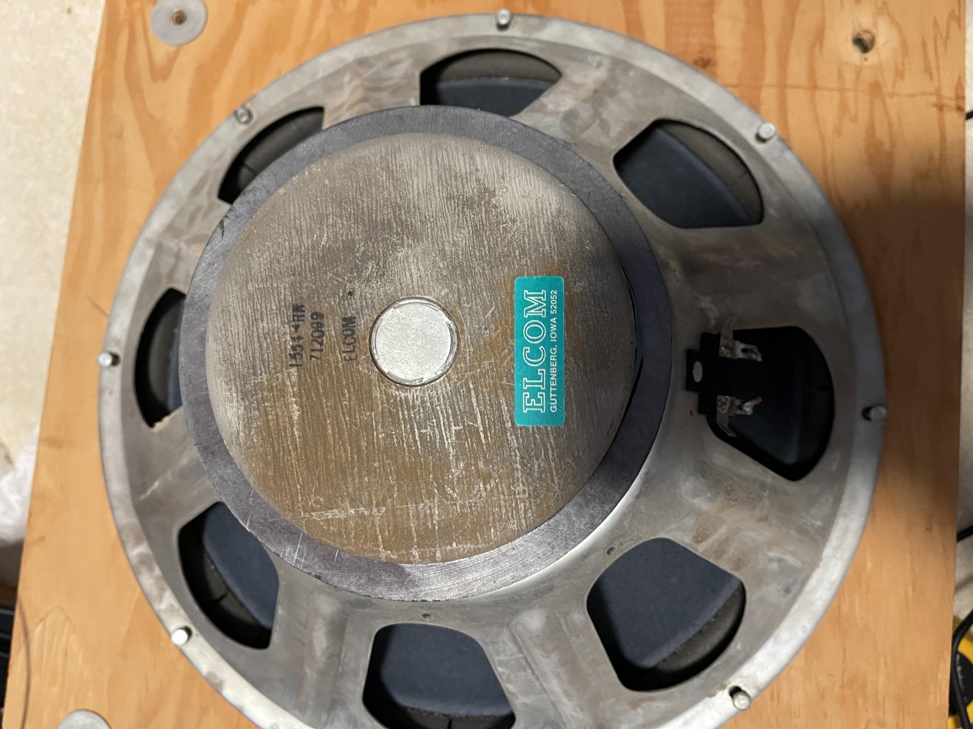

You can try woofer separately on alligator clip leads to amp to see if it scratches that way. If so, in the trash can.
All good advice except this. As mentioned it might be cone sag. Turn it 180º, leave it in a warm room for one or two days then try it.
The roll surround looks to have some aging/damage.

If there is no damage to the woofer's voice coil, then you could re-do the foam surrounds. Perhaps there's a cloth surround which would work and last longer. You would need double thick cardboard gaskets, or make a spacer to ensure the cone cannot slam into the motorboard.
