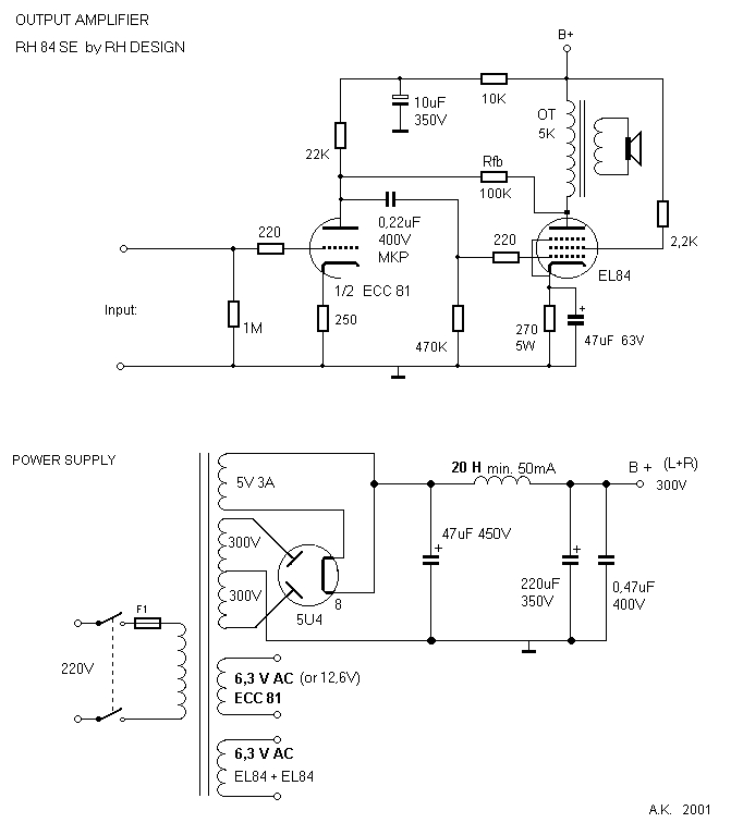

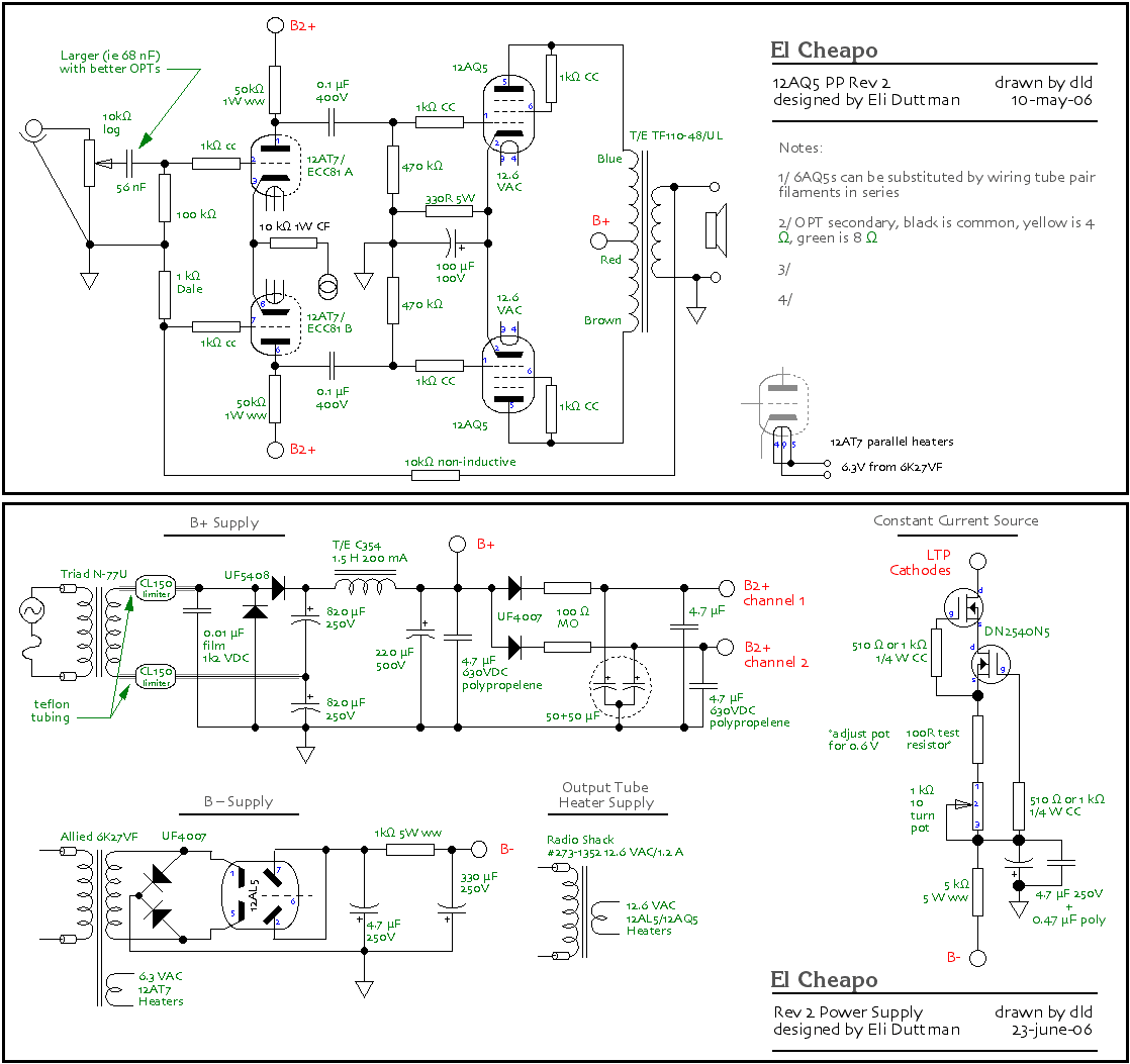

If you can source a Triad N-68X isolation trafo, which has dual primaries, a high performance B+ PSU that's inexpensive can be built. You use the "full wave" doubler topology shown in the attached "El Cheapo" schematic.
The signal topology shown in the attached RH84 schematic can be a good point of departure for a SE EL84 amp build. An obvious improvement is to regulate EL84 screen grid B+. A nice way to regulate g2 B+ is using stacked 0A2 and 0B2 glow tubes.

Thanks for the schematic,I am now on a quest to finding the output transformer and power transformer 😀If you can source a Triad N-68X isolation trafo, which has dual primaries, a high performance B+ PSU that's inexpensive can be built. You use the "full wave" doubler topology shown in the attached "El Cheapo" schematic.
