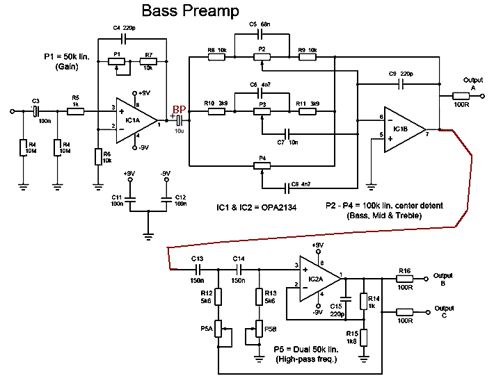

HELP needed! Bass Preamp Pedal
Hello there to each and every one.
I've been fiddiling around with analog audio circuits for some time now, and have made a few onboard preamps for my basses that I build.
Now, as my pedalboard seems to be growing bigger and bigger every year (no surprice there...) I'm having trouble to find a preamp pedal that suits my specific needs.
What I need is a high impedance input, a gain stage, 3-band eq and three seperate outputs. One output for the "dry" signal chain and two outputs with a high-pass filter, to feed the "wet" portion of the board (stereo chorus, stereo reverb, etc.).
So I've been searching the net for various circuits and have learn a lot about analog audio circuits, BUT some components I do not understand what they do and why they are in the circuit at the specific locations they are. Not to mention why that specific component has the value it has and how the value will effect the signal IF the value is changed.
Anyway, what I've done is put together a schematic using various circuits and I would appreciate if someone would care to take a look at it and comment on it.
A jpg file of the schematic is attached.
What's wrong with it? Will it go up in smoke if I build it and turn on the power?

I can't anything wrong, for what that's worth. 🙂
Why not breadboard it, or at least the individual modules, and test them to see if they work (and sound) the way you want?
Is a maximum gain of 7 times (i.e. 60k/10k + 1) okay with your bass guitar and +/- 9V supplies? Still have some headroom left before clipping?

The OPA chips are better inputs, and better outputs, than simple JFETs. Lose the FETs.
The OPA parts' DC error is low enough that I would skip output blocking caps. However your gain stage may multiply DC error, and I would stick a blocking cap after it.
Outputs to cables should have a few hundred Ohms series resistance.
This is configured for bipolar +/- supplies. That's often awkward on a pedalboard.

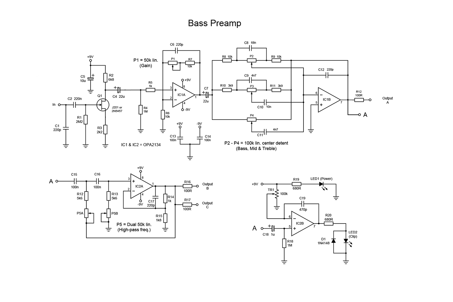

Hi "PRR" 🙂
Youre right, I too would like to use only op-amps. If you think the JFET output buffers are not really needed, I will probably remove them.
However, the JFET input buffer is there to get that valve/tube-like sound that I'm after. What's YOUR experiences with JFET's and the sound of them?
Aaaa, ok. Didnt know that a gain stage can be "unstable" in that sence. Thanks for that info! However, the reason why I put a cap on the outputs is to protect the circuit(s) from static discharging that could occur in the long cables that are connected to the outputs. Is this a good idea or not?
Ok, so WHY should there be a few hundred Ohms series resistance on the outputs? There's one in the high-pass circuit too, but I dont know why...
Correct me if I'm wrong but it seems that this OPA2134 is designed to run on +/- supply rails only.
So I'm going to use a switched-capasitor voltage converter (the ICL7660) to get that -9V.

It has to be fed from a low impedance output, yes - but your Output A is already low impedance. That means you don't need any additional buffer.
Op-amps (and other high-gain, high feedback amplifiers) don't like having a capacitor connected directly to their outputs. But if you connect a length of guitar cable to the output, it has quite a lot of capacitance. This can drive the op-amp into instability, worst case.
Adding a few hundred ohms of series resistance, right at the op-amp output pin, removes the problem. The resistor buffers the cable capacitance from the op-amp, so it can remain stable.
It is possible to get around this: use two equal-value resistors across the power supply to create a 4.5V point, which then acts as the "0V" for the op-amp. In effect, you get a fake 0V ground, along with +/- 4.5V supply rails. This is done in a lot of guitar FX pedals.
However: 9V is really a small amount of voltage to run a guitar preamp on. I like your way (with 0, +9V, - 9V rails) better.

And speaking of that, I think I've run into a problem with the charge pump IC. The OPA2134 draws about 4mA per amp (according to the spec sheet). Using both amps in the chip will draw a total of 8mA:s. The max output current of the ICL7220 is 10mA:s. Adding another OPA2134 chip will raise the current drawn to about 12mA:s (IF using JUST one amp in the chip). Will the ICL7220 charge pump "blow up"? It might.
So I think I'd better find a charge pump chip that is capable of higher output currents, like the MAX634CPA.

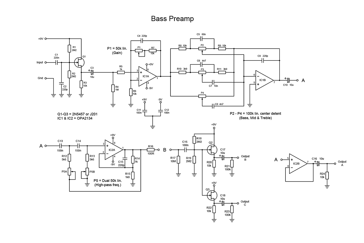

So what are you saying here? Are you saying that a simple JFET buffer (a stage that NOT amplify the signal) does not sound "tube-like"? I think you are right about that.
To my ears, a JFET sounds better than an op-amp, but not as good as a real valve. And a JFET common-source gain stage sounds better (i.e. a wee bit warmer) than a source follower. But still not as good as a real valve (and I've tried to make it as good!)
I think the trouble is the 100% negative feedback in a source follower. The feedback makes the JFET pretty linear. And linear is not what sounds best.
Been building the Tillman JFET for various projects and it seems it does sound "warm","round" and a bit compressed. Maybe its possible that to get that "tube-like" sound out of a JFET stage it HAS to boost the signal?
The Tillman circuit is set up for a voltage gain of somewhere between 2x an 3x. It has a lot of negative feedback, too, from the unbypassed 2.2k source resistor.
I have used something very similar in my current project amp. Mine has a 47k drain resistor and 10k source resistor, which happen to be the right values to bias this particular MPF102 properly using a 24V supply. (JFETs have huge manufacturing variations, another MPF102 may need something other than 10k at the source to bias to the proper operating point.)
The trouble, I find, is the (relatively) low supply voltage that JFETs can tolerate. If you bypass that source resistor with a cap, the JFET immediately becomes less linear, more "tubey". But the gain also goes up, and so it will also overload and clip easily, and may not handle the full output from your bass.
A valve stage doesn't have the same trouble, mainly because you can run it from +300V rather than +/- 9V. There is a lot more output headroom before clipping.
So far, I cannot find a way to make a JFET sound as good as a real vacuum triode. I haven't yet explored using a small MOSFET along with a high voltage supply rail (+300 V if necessary.)
You might try Amazon.com to see if you can find a DC-DC converter that does what you want. There are a tonne of positive voltage ones, but fewer ones that take a positive input and generate a negative DC rail from it. But you may get lucky and find what you need, a DC-DC converter that runs on +9V and generates -9V.

To my ears, a JFET sounds better than an op-amp, but not as good as a real valve. And a JFET common-source gain stage sounds better (i.e. a wee bit warmer) than a source follower. But still not as good as a real valve (and I've tried to make it as good!)-Gnobuddy
Nope, there's nothing like real tube-amp. Had the pleasure to test out a Ampeg SVT II Pro (even the power amp is tube only) once. OMG! THATS what a bass amp should sound like! 🙂 Too bad it weighs 70 Pounds!

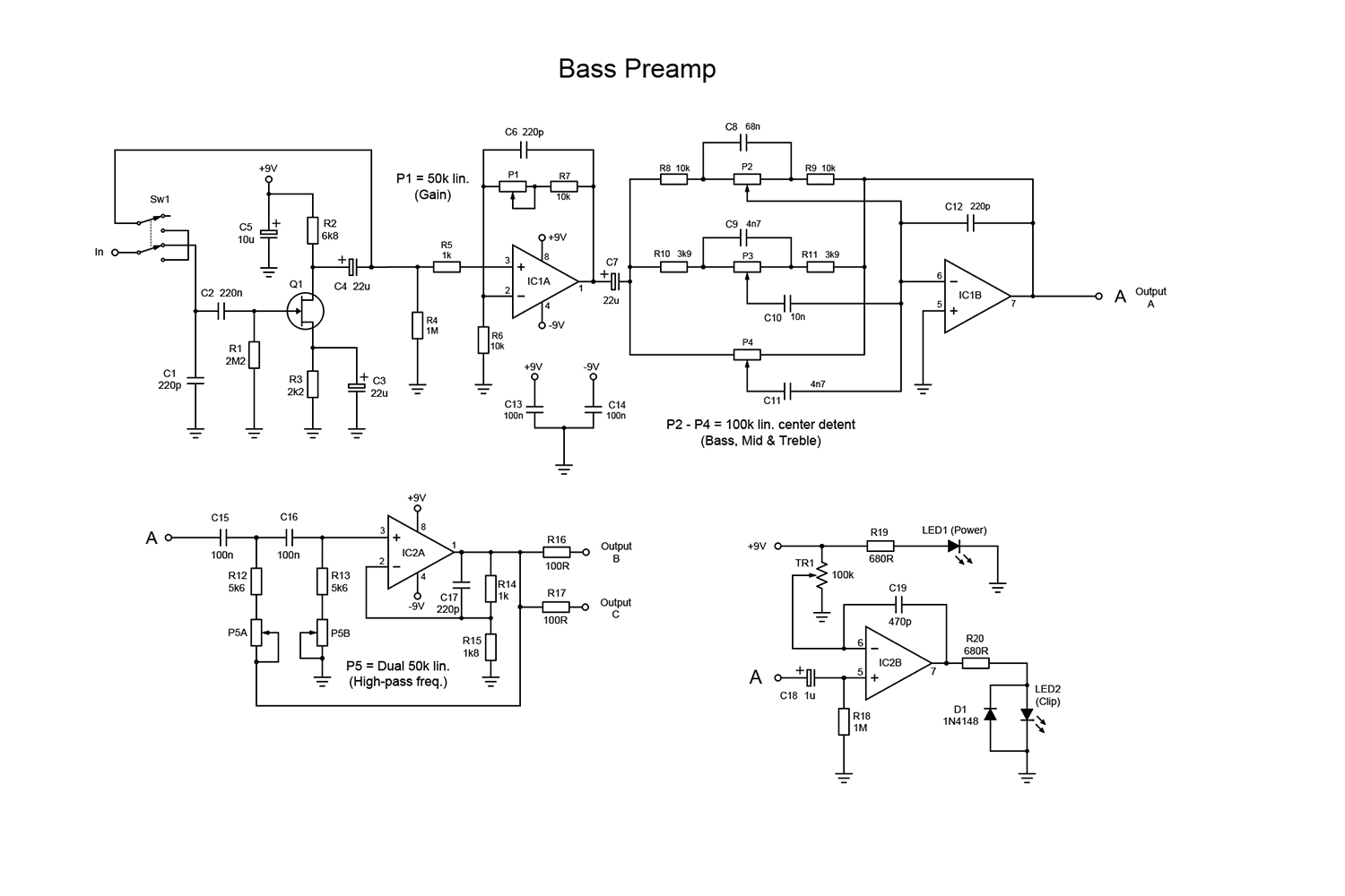

I saw this interesting looking schematic of a op-amp driven clip LED. See attached file. I do have one spare op-amp to use, so maybe it would be cool to use that op-amp to drive a clip LED? Don't know, we'll see...
Maybe I'll make a JFET input stage in front of the op-amp gain stage, and make it bypassable (is that even a word?) with a DPDT mini toggle switch...

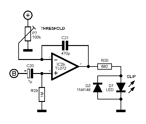

I wonder if it would be worth adding one more diode, and a capacitor across the LED (to make it stay on a bit longer after each clipping event)?
I think this should work (attached). Some experimentation with the capacitor value might be needed to keep the LED on long enough to be an improvement, without slowing down the clip indicator so much that brief clipping might be missed altogether.

Did some breadboarding today.
The high-pass circuit works. Who-hoo! Lovered the value of C13 and C14 to 100nF. That resulted in a bit higher max. cut-off freq, around 300Hz.
Also breadboarded the op-amp clip circuit. Both works, but the 1uF cap across the LED (and its resistor) dont have any visual effect. Only about 100uf and 220uF makes it light up longer, BUT the intensity of the LED is not as bright.
Good idea, but not very practical.
Something way more practical would be to somehow integrate a green "signal" LED to the circuit. I have no idea how to experiment with something like that, so...
One perhaps a very insignificant thing I've been wondering about is the values of R6 and R7 in the gain stage. Are those value critical somehow? They're now set to 10k, but could they be like 1k or even 100k? Does it matter?
Cheers, "Bobby"
Thanks for testing it out. The trouble is that (relatively speaking) it takes a lot of current to charge up a 100 uF capacitor in a millisecond or two, and the TL072 cannot deliver that much current.
I think it would work better to have the capacitor working at a smaller signal (current) level, and buffer it to drive the LED, but that would require two opamps.
There's a red/green LED indicator circuit here that might be of interest (I haven't tried it): MUFF WIGGLER :: View topic - [Project] 1 LED signal level meter (sch+PCB)
...the values of R6 and R7 in the gain stage. Are those value critical somehow? They're now set to 10k, but could they be like 1k or even 100k? Does it matter?
They're not critical, over a reasonably wide range. Lower values reduce thermal noise a little, but demand more current from the opamp. Extremely high values will misbehave because stray capacitances in the circuit will start to affect impedance, and/or may increase DC offset due to input bias current of the opamp.
3 op-amps to feed 2 LEDs? That seems a bit overkill to me, but if that is what it takes...
For commercial manufacturers, op-amps are dirt-cheap, and you can get four of them in one cheap chip.
For us hobby builders, op-amps are still cheap, but now you have all those joints to solder, resistors to install, wires to connect...it gets tedious!
For this reason, one project I will never DIY is an audio mixer. I could use a six-input one, but building six identical channel strips is just too tedious for me. It would probably cost me more than a commercial product by the time I was done, too.
Made a few changes to the overall schematic.
My only suggestion is to breadboard and test that JFET input stage. With the reduced supply voltages that JFETs can handle (compared to old-fashioned vacuum triodes), there is a much finer line between "too clean" and "too distorted".
-Gnobuddy
-Gnobuddy
Allright...
Did some breadboarding on the JFET stage AND some testing at the same time. Had to test out what the minimum (and/or maximum) values for all those caps.
So I decided to remove the cap from source to Gnd. Don't need that much gain. Actually I did test how much gain you can get out of a circuit like this and it seems to be about 10. Fed it with sinuswave 70mV and out came approx. 700mV. Did test out at what point this circuit starts to clip and 800 - 850mV on the output is pretty close, depending on the JFET of course.
So I guess this is what I'm gonna build, working on some layouts.
Cheers, "Bobby"
