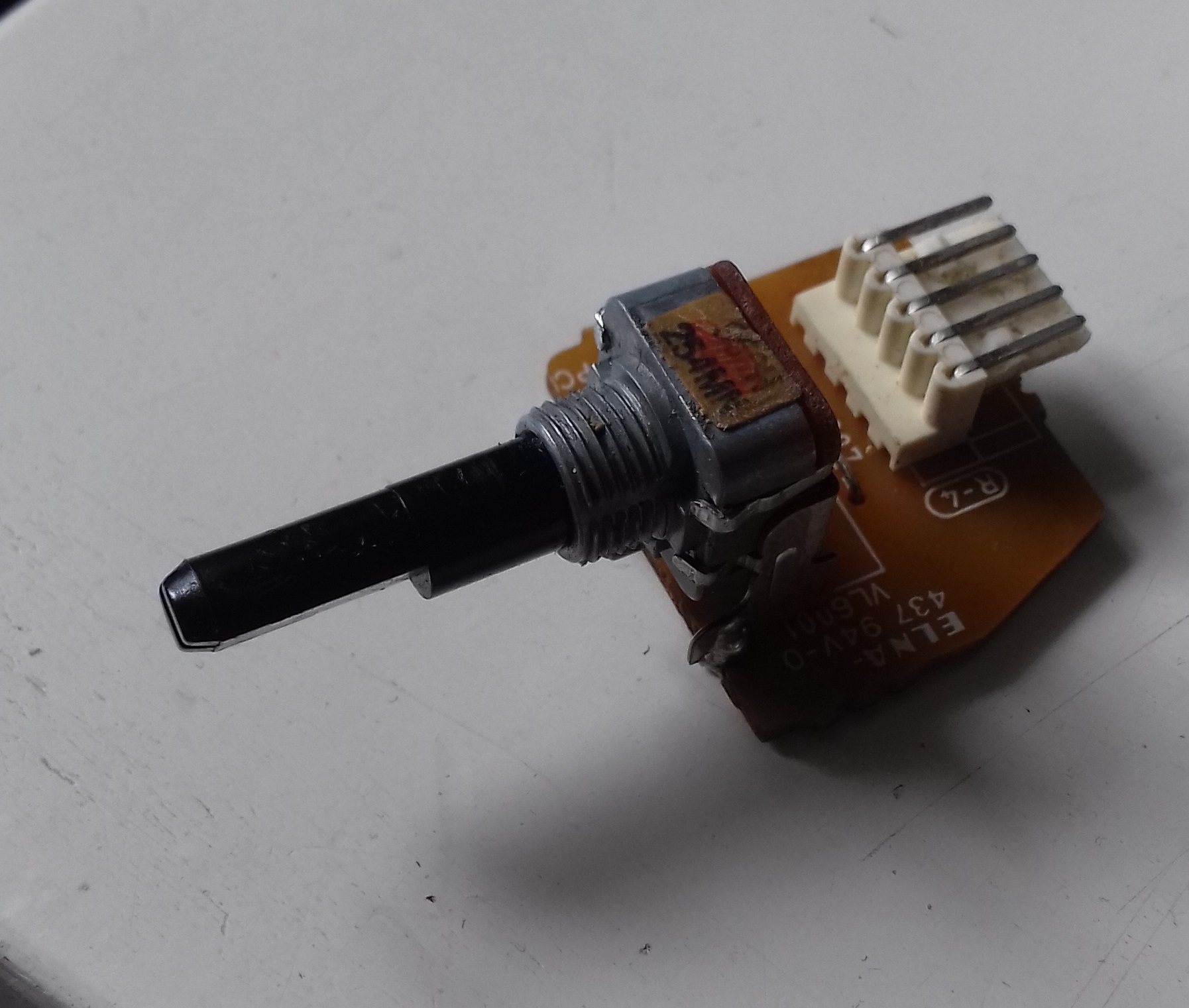

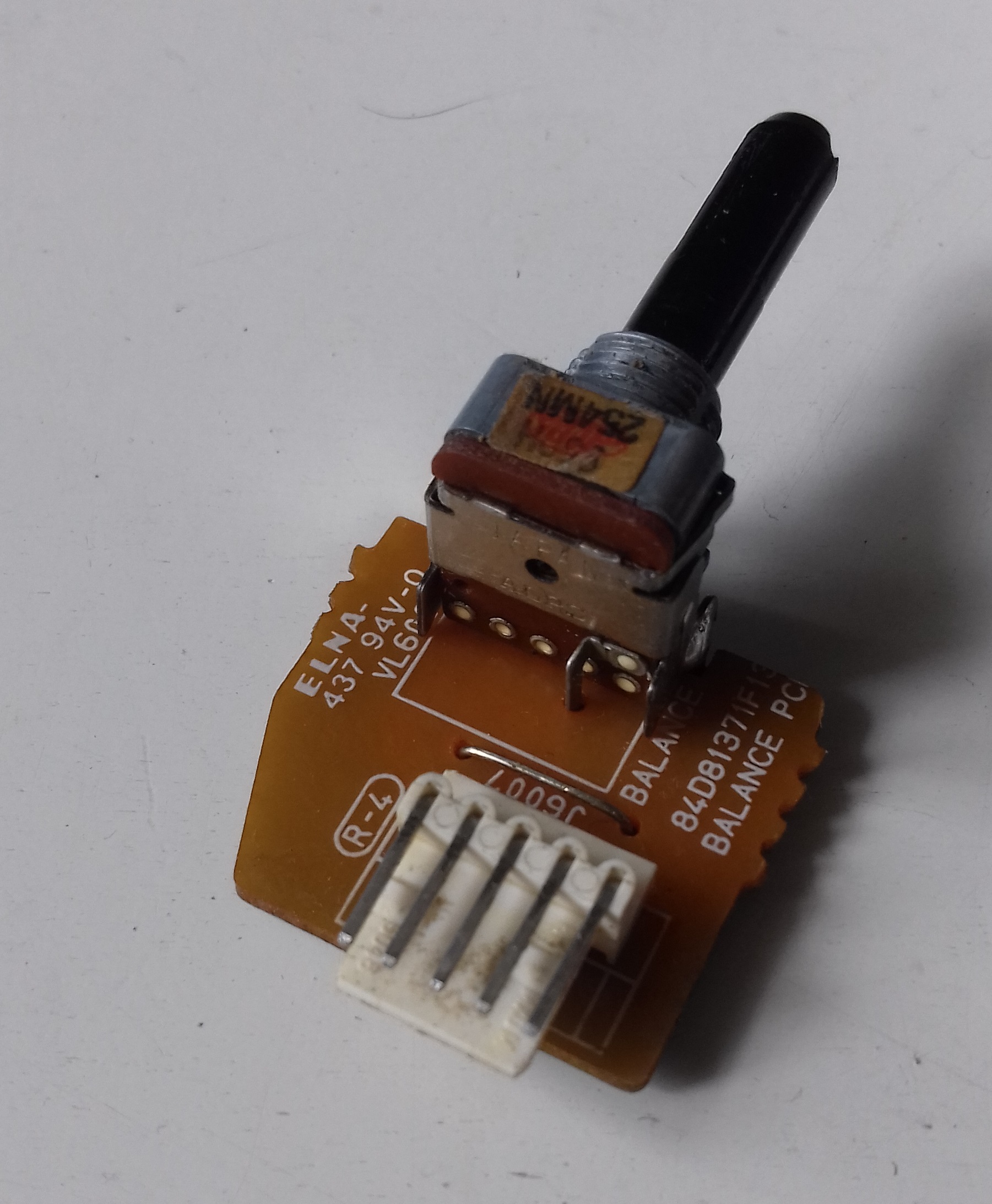

Hello,
I've got a Luxman LV-105U with a faulty balance pot (alps 254MN 250k dual).
One of the two gangs has a resistance of 250k but the other is at 300k which is causing quite a difference in output between both channels. I tried cleaning, checked for cracks but I don't think there's anything more I can do to save it.
An exact replacement seems impossible to find (or maybe I didn't look in the right places) so I'm looking for something similar. I know ALPS are still making pots that look like this one but 250k versions don't seem to exist any more.

The thing is when I got it, there was no sound at all on the channel that now is weaker that the other. cleaning the pot took car of that but the amount of difference between left and right seems to get worse again, I cleaned it again and it got better but I can imagine it won't stay this way very long.
I don't really need to keep the pcb, I can connect the wires directly so that's not a problem. adapting the knurled shaft to the knobs that are made for a flatted d shaft will maybe be a little harder, I don't think they have these.
I cleaned it with a European equivalent of deoxit. I even opened it and cleaned it several times with a soft toothbrush and some paper towel with the product. I use this a lot and it worked well so far. I think this one is really just too far gone.

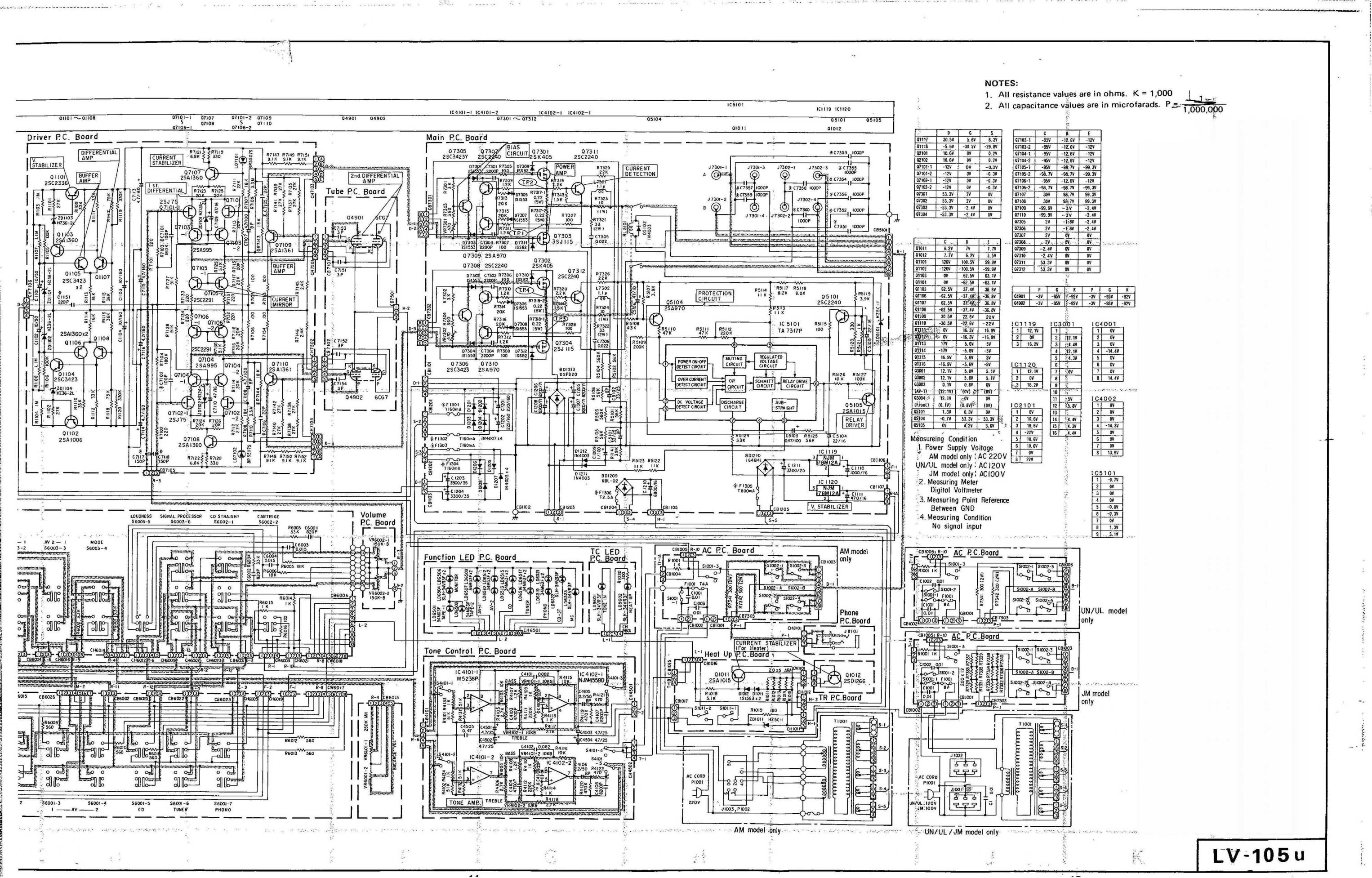

Depends on how the circuit is set up, it could be center detent or plain pot.
The balance control is on the bottom middle of the attached schematic. It appears to be a standard dual gang pot set up so that as the resistance increases to one channel, the inverse is applied to the other.
It's late here so have a good look for yourself (or investigate your pots with a DMM to see how they behave) and decide which type is right for you.

From what I see inside the pot and my measurements it is how I described before, one channel has a carbon track on the right side to ground and the other has a carbon track on the left side to ground. The rest of the track is just metal and goes to both inputs. The wipers are the output. When the pot is in the middle (where it locks) the wipers for both channels are just at the limit between metal track and carbon track (so 250k to ground. When I turn the pot left, the wiper for the right channel moves on the carbon track and finally gets shorted to ground, same the other way. The schematic illustrates this perfectly btw.
If I use a simple stereo 250k pot, when set in the middle it will measure 125k between wiper and input and wiper to output.
