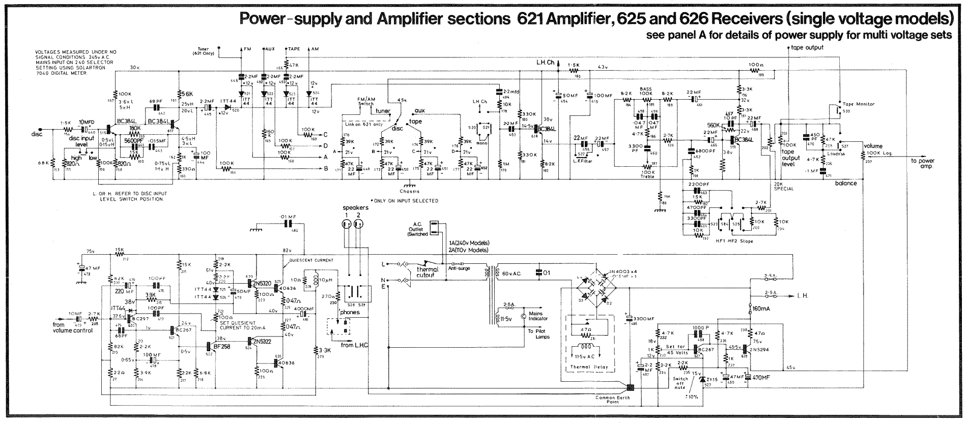

I am repairing an Armstrong 612 and am struggling to understand a fault on the output stage on one of the channels. Here is the circuit diagram:
When I power up the channel, it draws excessive current (ie. the light bulb on my bulb test/current limit box comes on), and the upper driver transistor ref 623 (2N5320) fails short. The PCB in my amplifier differs slightly from the circuit diagram in that there is a 22R resistor in the collector of the 2N5320, which starts smoking.
I have replaced all the semis on the board, as well as the output devices, and I have tested every device and satisfied myself that they are all okay. I've not tested the resistors, other than to measure them in circuit to check that I don't get any suspicious readings. I have replaced all of the electrolytics.
I am completely stumped! Has anyone got any ideas?
Because of device obsolescence, I have replaced the BC297 with a BC327, the BC267 with a BC337, and the ITT44s with 1N4148s. I have also replaced the BF258 with a KSC3503 and the output devices with 2N3773. The other channel is working fine with these substitutions.
This is driving me nuts...!

If you link the base of 623 to the base of 624, does it still fail? If not, take a close look at the biasing circuit, check the preset.
There is also the possibility of a short to the heatsink so check and compare the DC conditions around the output transistors, such as 40V at the midpoint of the 0.47R resistors.
Thanks for your suggestions and apologies for the delay in replying. I have checked the output devices for shorts to the heatsink and all appears to be well. I have replaced the mica insulators with new sil pads.
The preset appears to be fine and gives sensible readings if I measure its resistance whilst adjusting it. I've given it a good going over with contact cleaner just to be on the safe side. If I link the bases of 623 and 624, the circuit still draws excessive current. The DC level on the output does not rise when I wind up the variac carefully, and it looks as though the lower output device turned on and holding it low. I tested this theory by shorting the base of 624 to its emitter and checking that the output voltage rose when I increased the supply voltage. I've again used the diode checking setting of my DVM to confirm that all the transistors are still good (which they indeed appear to be).
I'm now checking the board for any visible PCB damage, as well as visually inspecting all the passives.
Any other theories?

Be super wary of the bias/dc trimpots.
Any slight wear/cracks in the track will potentially blow the outputs and drivers.
I speak from experience here.
I replaced the pots with 10 turn bournes.
How are the two 4,000uf caps ?
Unit I worked on needed those replacing too.
With the age of the unit, I'd do a full recap for future reliability

I've already replaced all the electrolytics, including the 4000uF output caps. I agree that it would be a good idea to replace the trim pots just to be safe, although it doesn't explain why the circuit still draws high current when the bases of the driver transistors are shorted together. My present line of enquiry is to understand why the upper output Darlington pair isn't behaving like a Darlington, ie. Why the emitter of the output device is not following the base of the driver. I've been looking for a PCB trace fracture or dry solder joint but everything looks okay.

Other quirks of these old designs:
Be sure that you noticed any TO220 semi's are BCE and not EBC, and twisted the leads around.
Some To92 products are the revised lead order, too, compared to TO5.
Modern output transistors do not have the base resistance of an RCA homotaxial part, even though the part # is similar. You need to install 10 ohm >1/2 watt resistors between the drivers and the bases of the output transistors.
I find drivers hold up better with a heat sink.
I've had the upper driver transistor get very hot on the similar Apex AX6 board and found the O.T. base driver solder joint was open, making the upper driver work very hard trying to pull the output capacitor center line up. This has the light bulb limiting.
Also without a base resistor new output transistors with high Ft (>200khz) can oscillate ultrasonically. Check for AC voltage with an analog VOM with a 390 or 220 pf capacitor in series with the ground lead. Music won't go through a capacitor that small, ultrasound will. Or use a scope and look for fuzzy waveform that won't hold still.
If oscillating, dynaco in their copy ST120 circuit (I don't know who came first) added 50 pf disk capacitors between base and collector of the two driver transistors. See the "TIP mod" on greg dunn's dynaco website. they also put a 1k series .047 uf snubber between output and ground to keep RF from sneaking in that way. There is a lot more RF floating around the house these days than in 1966, ie cell phones. (The dynaco ST120 bias spreader circuit was stupider than armstrong, I hope armstrong was later design)
What I like about these capacitor output amps, no matter what happens they won't blow up your speaker.
If your boards are getting torn up ( my ST120 has been repaired too many times) see the Apex AX6 thread for modern boards that fit modern transistors that will do the job. Nobody is selling the boards, you have to make them. I've built one on perf board, I'm trying today to see if it oscillates or not.
The AX6 also has a 27 ohm resistor in the lower driver emitter line, perhaps to reduce thermal runaway. You see armstrong found a 22 necessary in 623 the upper driver. And the AX6 has the .51 resistor in the emitter lead of the lower output transistor instead of the collector, probably to also limit thermal runaway. Newer output transistors aren't as slow and don't have the base resistance of the RCA ones.
I clamped my bias trim pot with a parallel diode, to keep idle current from running away if the wiper fails. If the voltage across it is low enough after prototyping I may clamp with a schottky diode instead of a 1n4148.

The only replacement device with a different pin-out is the KSC3502. I needed to joggle their legs to get them in the board but they've gone in fine. The output drivers (2N5320 and 2N5322) have heatsinks. My frustration is that the left channel works absolutely fine with all the same device substitutions as the dead right channel. I've checked it thoroughly for instabilities (using the scope and a spectrum analyser) and it seems to be absolutely fine. You make a good point about adding base resistors to the output drivers - presumably these should be fitted as close to the output device as possible (the output transistors are mounted off the PCB with wired connections). I've re-made all of the wired connections because the original was solid cored and prone to fracturing. And after 40 years has become very tarnished and difficult to solder to.
I've just worked out that the lower driver (ie the PNP in the CFP) has a 22R resistor in its collector, presumable to reduce the risk of thermal runaway. A bit of adhesive aluminium tape was loose in the chassis when I first opened it, and traces of dried adhesive on the board suggests that it once provided a thermal connection between the upper driver heatsink and the two diodes in the bias chain. I've looked at a few pictures of Armstrong 621s on line, some of which show this piece of tape and others which don't. I suspect is was a manufacturer's bodge to keep the bias current more constant with temperature, but I haven't decided whether to replace it (I'm worried about relying on the tape adhesive to provide electrical insulation).

You have one good channel, right? There must be DC differences between the two to indicate that not everything is correct, in addition to the high idling current. Perhaps marking up the schematic posted in your OP with any voltage discrepancies would be useful to all of us.
As you are telling us that everything you looked at checks out correct, it is difficult to get a handle on your problem, other than as some have already suggested, that the bias control circuit must simply be faulty. So let's look instead for the differences between the channels with say the bulb limiter or better, a fixed ~ 1k limiting resistor in series with the supply to each channel - and there will be some differences even if you have to compare every circuit node in each channel to find them.

I finally found the fault - the 2N5322 had a failed even though its diode drops measured okay on the DVM. Its junction had gone leaky, which I spotted when I measured the resistance across the output of the channel and found it didn't match the good channel. I traced it back through the circuit until I got to the 2N5322. I've now put a new one in and it's working fine!
I'm going to replace the trim pots, even though all is now well. These old carbon types worry me - I've known the tracks to crack and the wiper contact to become corroded.

The 2n5322 driver may have failed because they have selected a 75Vceo device to run on supply rails of 82Vdc +-mains voltage variations.
You really need a higher SOA device with Vceo >= 100V
The 2A rating is OK. But gain can be a bit low (30 minimum) unless they have selected higher gain versions for the build.
