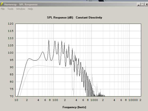

This type of subwoofer has some form of low frequency response shaping to increase the output in the range where a sealed box would be falling off, and it almost always has a high pass filter to protect the speaker from excess excursion below its useful range. So there could be all kinds of things wrong here, the amp, the driver, wiring, the cross-over, the box (leaking, inadequate bracing).

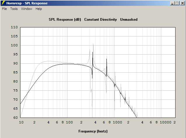

Basically, you should have a working product with this particular driver in a sealed box. I'll attach a quick Hornresp SPL output comparing this driver in a seal v. a ported box (internal volume = 3ft^3).

As to your original question: If you look back at my previous posts you can see the SPL comparison between 3ft^3 sealed and ported boxes in Hornresp. The difference between the respective SPL lines indicates the unequalized difference between the sealed and the ported alignment. There is also a quick run at the response of a tapped horn, but it's quite big. I did this real quickly as examples, all of these boxes would be workable, provided that the T/S parameters from the manufacturers spec sheet have something to do with the driver you have. As to port size: I took a quick look at the Partsexpress forum, and found another set of T/S parameters posted by "Jethro". For a ported box with factory T/S I end up with 4.5ft^3, and with Jethro's T/S with 2ft^3. Naturally, the port size changes too. I recommend you measure your own driver to have a starting point. For a shot in the dark you could try a duct 4"Dia.x 20"long.
A really important thing to check is that the box is free of leaks, including any build-in amplifier box. After that, one of the easiest modifications would be bracing the middle of all the nice square sides that make up the box (and where possible from brace to brace accross the box). A little more involved, but maybe more promising would be a shelf port under the existing box. Something similar to a toekick board on a kitchen cabinet can be made to work very nicely to provide added volume, or the room for a decent size port, or both. Another way to play with a port and the present box: you cut a hole in the bottom (back corner) and attach an external PVC ell and pipe, e.g.: 4"Dia.x 15" long. Then play with the tuning by changing the length of the pipe. (I prefer a 1.5"(2x4) high shelf port, and sticking pieces of 2x4 into it until the tuning is where I want it.)
