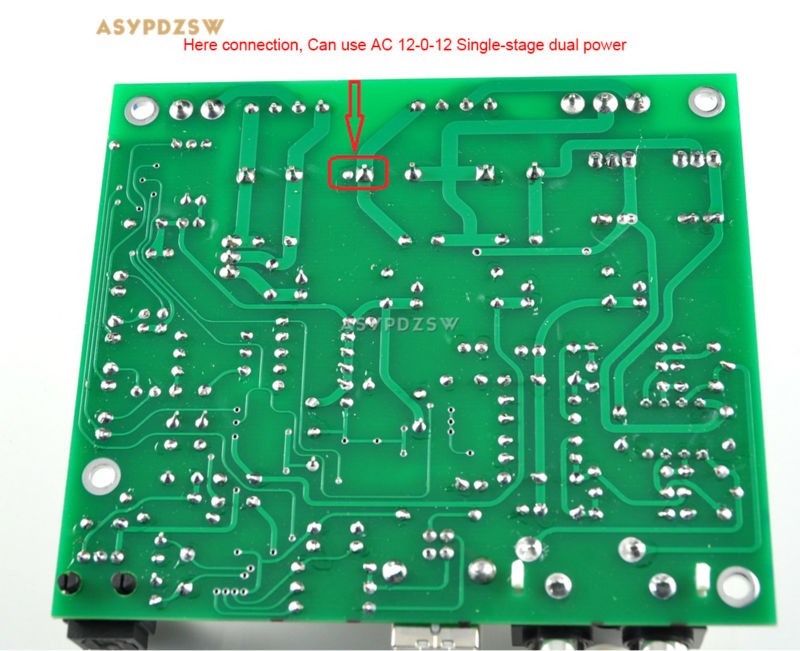

I want to buy as well this board, but I have some questions about it.... maybe you can help me.
1- could I use it with Mac OSX? Is it recognized?
2- on the back there are 2 solders points where is specified that I can power this board with 12-0-12 transformer. I don’t understand if I have to soldering together these points if I want use 12-0-12 power supply.
3- Can I use the same transformer for this board and as well for an headphone amplifier? I want buy only one transformer with 2* 12-0-12 line (10watts)
4- About the 0-9v ac Terminal block... I have to buy a transformer that have as well these output values? So, 2*12-0-12 and 1* 0-9 ??

From the first photo, post 1.
First supply is dual 13 to 15V. This feeds the 12V + & - regulators 7812 & 7912.
Also is a single 9 to 15V supply. This feeds the 7809 regulator.
You can use the same transformer to supply both (using 0-12 for the second supply).
I should think a 12-0-12 would be near enough but wait for more knowledgeable members to confirm.

The question is different. The 12-0-12 transformer is low quality so I have to buy this one. ...But it’s the first time that I use this tipe of power supply, and is not really easy to me to understand how AC current work. I have always work with DC.
I can share a 0 wire between devices? I can split a 15v wire between 2 different input on a single device?
