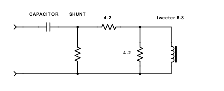

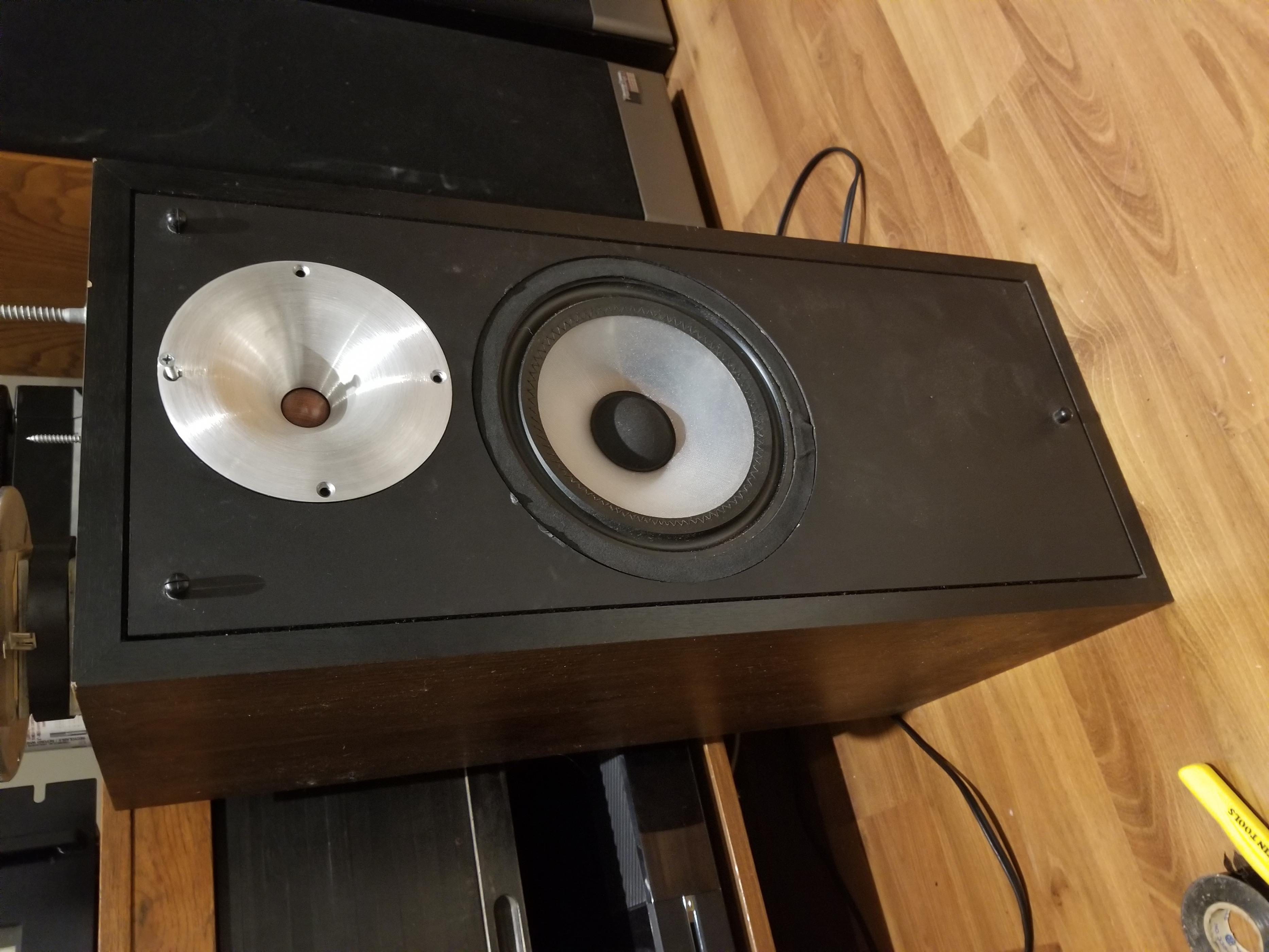

Well I just swept both tweets one keeps failing to my ears sounds ever so slightly weak like it's missing something. It's super annoying as it's just enough to play mind games. Gotta send them both in to be rebuilt in the near feature.
Till I get the finances together at the end of the month let's try this mod on these energy 22 pro. Everybody loves sticking these sound dynamics tweeter in them. Lucky I have a set in storage. They come off smoking way more effiecent. 8-10db more effiecent. So let's try and correct that shall we?
Tried a 8.2 db chop that still presents a 6.8 ohm load. I would say a 9 db chop would be on par with the original tweeters.
But the original tweeter impedance is 4.2-4.5. Can I lower the sd tweeter impedance to match the energy tweeter specs and still lower the db? Anybody got a formula for that if it's possible.
The end goal is to match impedance with the original tweeter so it doesn't effect crossover point of the tweeter as much and get the db close as possible by ear.
As a note yes the crossover is only made for the original 22 tweet I understand that.

Tried a 8.2 chop that still presents a 6.8 ohm load. I would say a 9 db chop would
be on par with the original tweeters. But the original tweeter impedance is 4.2-4.5.

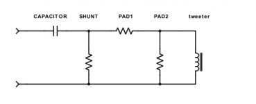

Just add a shunt resistor after the capacitor, to make the total 4.5R.
To go from 6.8R down to 4.5R would require adding a shunt of 13.3R.

Typo. 8.2 db chop not ohm.
Tweeter is 6.8 ohm
Existing tweeter is 4.5 ohms
As of right now I got a 4.2 ohm resistor in series and a 4.2 ohm resistor in parallel. To achieve that 8.2 db chop value using just static values. Driver ohms out and 6.9 ish with it installed. How can I do this where the drivers reads 4.5 ohm and gets a 8.2 db chop.
Having issues uploading pics to show what I'm doing.
Tweeter is 6.8 ohm Existing tweeter is 4.5 ohms
Like this? The shunt should be 13.3R to make the capacitor load 4.5R.

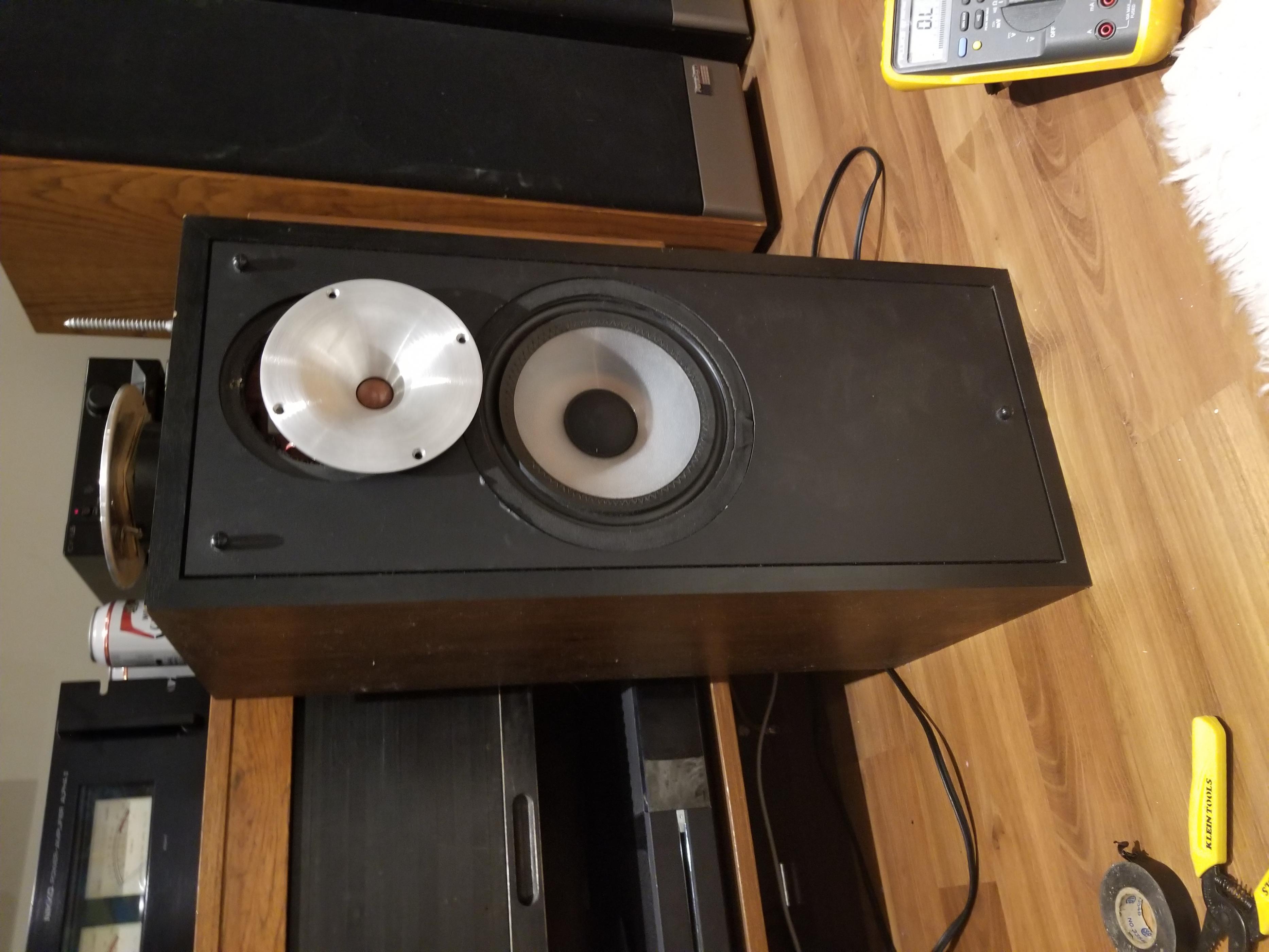

Already checked the vc resistance its .1 off from each tweeter which is minor. I dont have any software to check its frequency range so I'm trusting my ears on this. The tweeters are known to just fail at any volume in energy 22 speakers. I'm suspecting early failure signs. Plus we have a replacement tweeter already that's energy 22 correct in one. I got them that way. So maybe the tweeters are simply from different batches and made slightly different.

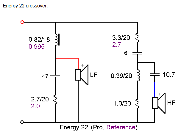

We seem to have a schematic. That 47uF NP Electrolytic in the bass section is likely deteriorated too. I would also check all the connections for corrosion and dry joints in the soldering.
Steve,
I have a set of these speakers and have had the fluid recently replaced and the tweeters checked by Chris Coote,one of the original techs who worked for Energy.I have not replaced th 47uF cap you mentioned.Can you tell me what the sonic implications are of that cap if it is dried out?
This is quite an established sort of design these days. Troels Gravesen is fond of big waveguide tweeters:
TQWT-
If the 47uF bass shunt capacitor deteriorates, the midrange around 2kHz would be altered in tone. The 7" polycone bass would roll off less steeply and phase would worsen dramatically. These things are so cheap to replace, I would do it anyway. Stuff like Mundorf 70V should be fine.

Steve,
Thank you for such a quick reply! I did not send the whole speaker to Chris,just the tweeters.I will take your advice and replace the caps. These speakers are too good to not have them preforming at their best. Cheers!

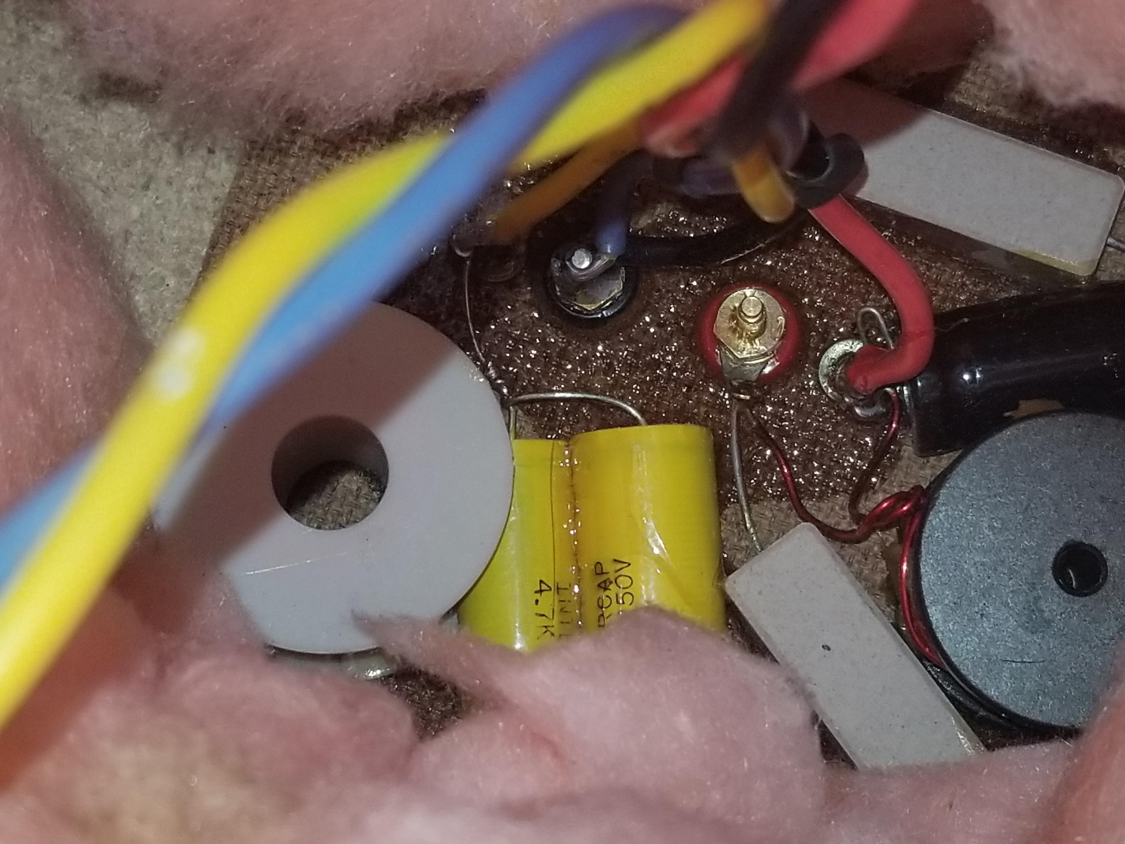

Going to order some new ferrofuild and clean out the old Crud to see if it helps. When I was digging around in there I only seen 1 electrolytic the rest plastic capacitors. The electrolytic would be suspect as the plastic caps seem to last a long time.
Trying it with a shunt didn't help much. The sd tweet crossover at 2250 hz and the energy at 1800 hz I think.
Those sd tweets are just lacking compared to those energy tweeters. The detail and soundstage are worlds apart.
You can see why the sd tweeter gets chosen for this job and the classic epi inverted dome tweeter. It's a direct fit for that hole. My advice is stick with the original tweets.
