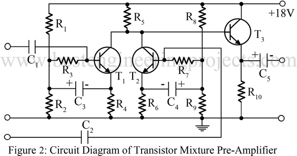

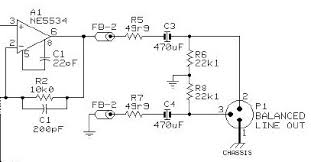

Have a look at a balanced output stage. The two signal lines have the same resistances (R5=R7 & R6=R8) and the same capacitances (C3=C4). If it's made symetrically then the inductances will also be very similar.
The balanced input stage has the same features: the input resistances (R3=R7, R1=R8, R2=R9, R4=R6), capacitances (C1=C5, C3=C4) and by symmetry the inductances are all equal.
Note, that there is no ground connection in the signalling.
The two enclosures are connected via Pin1 at both ends. But ONLY the enclosure is connected to Pin1.
Note also, that even in the three unbalanced cable arrangements that the Pin1 are ALL connected to the enclosures at BOTH ends.
The signal cable gets connected to audio ground at one, or both ends, that makes the connection unbalanced.
Where the signals are NOT connected to the audio ground (option a) then the connection remains balanced IF the IMPEDANCES are balanced.
If RF attenuation is added, then the capacitors are taken to the enclosure at the input socket.
