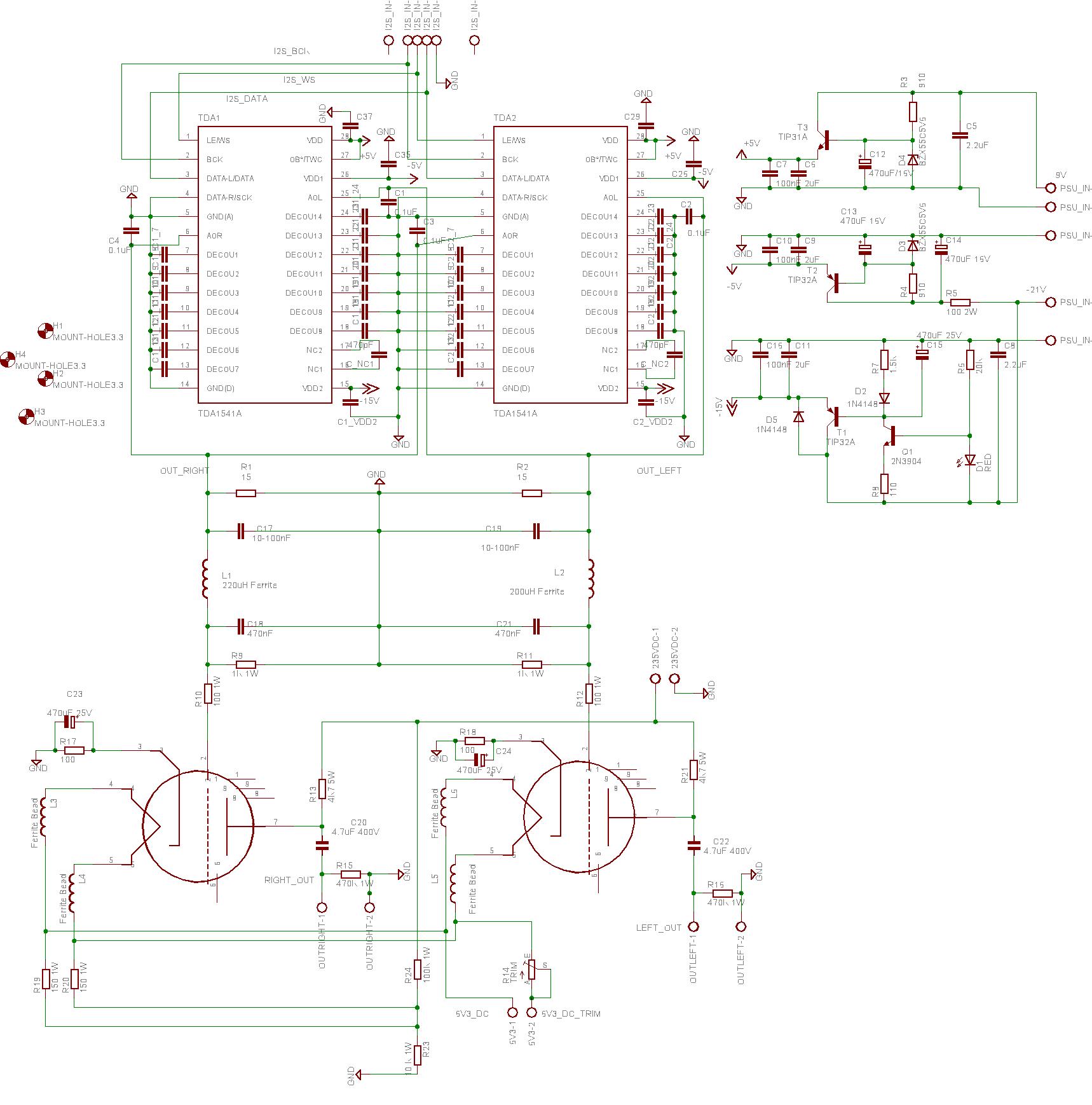

Hi all,
you will find enclosed the schematic of my DAC. it consists in 2 tda1541 in // with the output buffer made of two 6C45PI.
I found the schematic of the output buffer in the net.
Unfortunatly, I don't know which ferrite beads I should ordered. 🙁
The ferrites I'm talking about are L3,L4,L5,L6 (connected to the heater of the tubes)..
They are dedicated to avoid the tube from oscillating.
Do you have a reference, an example of ferrites I could buy ?

the last one on the page could do the job

These ones ?Bricolo said:the last one on the page could do the job
Self de choc VK200
Self d'arrêt et de découplage VHF. Impédance: >700 ohms à 180 MHz. Inductance: 10 µH. Matériau: 4B1. Diamètre: 6 mm. Longueur: 10 mm.

Yes, these ones.
All the others on this page aren't ferrites, they are coils.

something close to this I think
Ref : 308-8889 www.radiospare.fr
