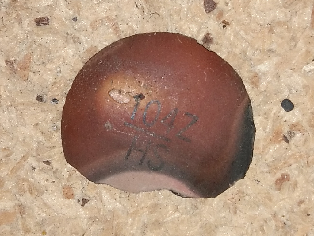

I recently acquired a faulty NAD 7225PE. It's a nice little unit and sounds great. But one channel was cutting in/out/crackling etc.
I tracked it down to this little 100nF 100V CAP, which exploded and left little pieces of ceramic and metal everywhere! It's a cap on the +/- 40 volt rail.

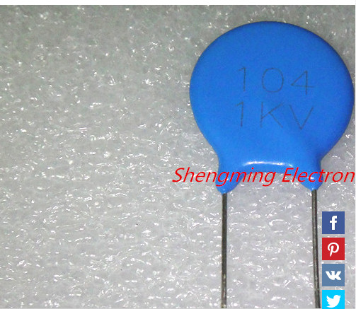

Now... what can I change it with? 100V ceramics are hard to come by, even after a quick search of e14/mouser/ebay/aliexpress. However, there are heaps of cheap 100nF 1KV caps around. Can I use them, will it affect anything? They just don't look ceramic, with their blue covering.

The blue 1kV capacitor should be fine. Below is a suitable Mouser part number, $0.14US each.

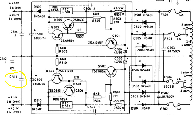

To be certain of what this cap is supposed to be doing, a reference to the schematic or part number might be useful: NAD 7225PE - Manual - AM/FM Stereo Receiver - HiFi Engine
Thanks for the advice. I guess the main question really was: Will a different type: multilayer, film etc make the amp sound different?

It'll work fine with any cap of a similar value and same or higher voltage rating that you have to hand - anything from 100n up, film, ceramic, multilayer, disk, whatever is to hand.
Importantly though, you need to ensure that there's nothing left there that caused it to blow - IME ceramic caps are incredibly reliable, and they usually only fail if something causes them to. I'd be checking the rails for excessive AC ripple and replacing the electrolytics on the rail.

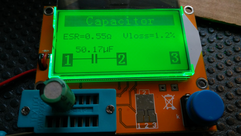

I think it blew because it was physically pressed up against the 3A (1N5401) diode, while its partner on the other channel had an air gap. But interesting what you say about the electrolytics, I suppose the 3020B is a similar circuit. I don't have an ESR meter, but have a scope. The best I can do is measure ripple on the 41.1V rails. But what's a good/bad value and at what volume?
Anything more than a couple of hundred millivolts at idle will be a problem. Looking at the schematic, C504 & C505 will really cop a hiding, with lots of ripple current. I’d be expecting them to be dead.
On my 3020 the main filter caps were fine - it was all the smaller electrolytics that had problems. They’re all 20c parts, so I just replaced the whole lot.
C504 & C505 actually seem to be alive. Sure, this LCR meter is a bit of a toy, but I guess they're serviceable.
