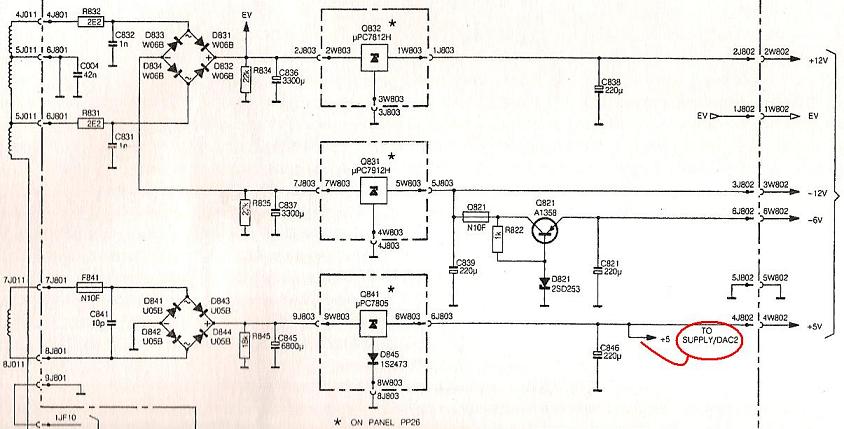

Help me mod Philips CD960

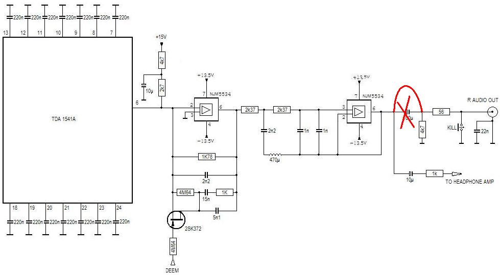

Here is shematics for analog out:

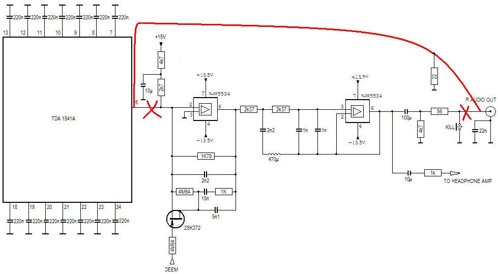

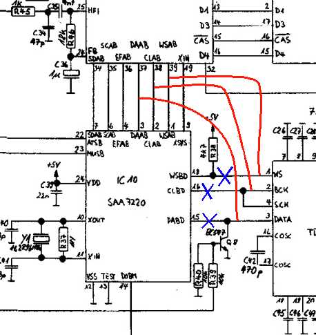

Here is another shematics for analog out:
I need opinion/explanation of this mods before I start desoldering.
Does anyone have any other suggestions for modding analog out?
I will post power supply shematics also.

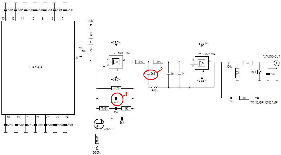

You could try to remove the 2,2n slew rate limitation cap.
And the 22n cap on the output.
The first resistor with red X is for DAC current offset compensation, removing it will cause DC offset on output if 100µF is removed.

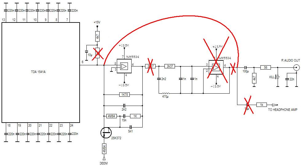

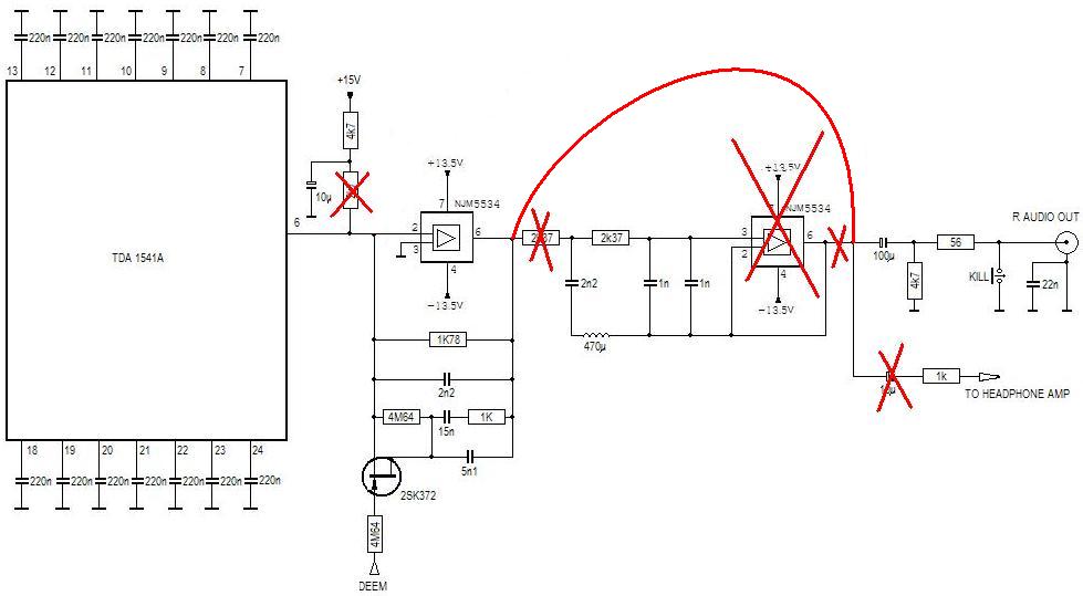

The middle part is the analog filter, gives lot of HF when removed because of 4x oversampling.
Try change the 14 decoupling caps for higher quality/value,
1k78 I/V resistor for better quality,
better op amps + better decoupling caps.
Upgrade to S1 chip + SAA7220B perhaps.
Which one? (see red circles in shematic)
Higher value is =
I have at hand only 100n WIMA MKP :bawling:
[/QUOTE]
Do you have any reccomendation (KIWAME, VISHAY)?
I have AD825 OP AMPS. Any other/better choice you can reccomend?
cap.
I have SAA7220B, S1 and S2 chip. I replaced TDA1541A with S1 (for S2 I'm not sure is it original or not) and player has more detail and better sound now.
THANK YOU for your replay 🙂

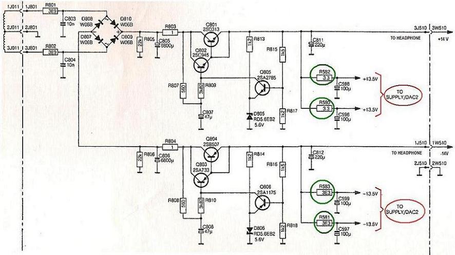

Here is first part of PS shematic of my cd player.
What is the purpose of this four (circled in green) resistors?
What if I remove all of this four and bypass with wire?
What can be done here in order to improve power supply?
I replaced diodes with shottky 4A/100V.

Allen Bradley CC and Russian Teflon (R) caps.
