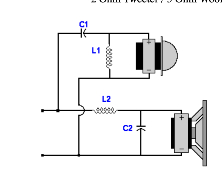

I found this simple crossover (i really dont know if its crossing over) with just a capacitor of 4.7uf b/w the tweeter and the mid driver. The response of the system is very flat now, i would like to get in a bit more punch to the lows and the highs. Opened it up while trying to add a Bluetooth module to the system and found the crossover setting.
Attached is the image of the 2 way system.

A woofer is better crossed before cone breakup. This typically happens at a frequency related to the size of the woofer. This might be a guide to you choosing where to cross. Although it is uncertain whether this tweeter could cross at that point, I would assume so if a second order crossover is used there. At some point you might adjust the level of the treble.

Yes its a 4inch woofer and 1inch tweeter
Can you suggestvalues to start testing out with for the cap and inductors.
100hz would be a good freq to crossover on this one?
100 Hz would blow up your tweeter when you turn up the volume. I'd guess somewhere between 3 kHz and 8 kHz would be more suitable.
The present crossover frequency for the tweeter is 1/(2 pi 4.7 uF Rtweeter), so 4233 Hz if it is an 8 ohm tweeter and 11288 Hz if it is a 3 ohm tweeter. You can probably go a bit lower with a second-order filter, especially when it is a Linkwitz-Riley filter because then its response has already dropped 6 dB at the crossover frequency, but you can't go decades lower.
By the way, my practical experience with loudspeaker crossovers is quite limited.
Yes, my first guess would be 3 or 4kHz, with 2nd order on the tweeter, but I can see the temptation to go even higher. Can we guess a 1/2"vc tweeter and 2 paper cones?
Something like that, yeah. There's only so much polishing that can be done, but I found I could get really good results from a pair of Fostex PM04 converted to passive (they were sold without the amp modules). It took 2nd order lowpass, 3rd order highpass and a few other bits.

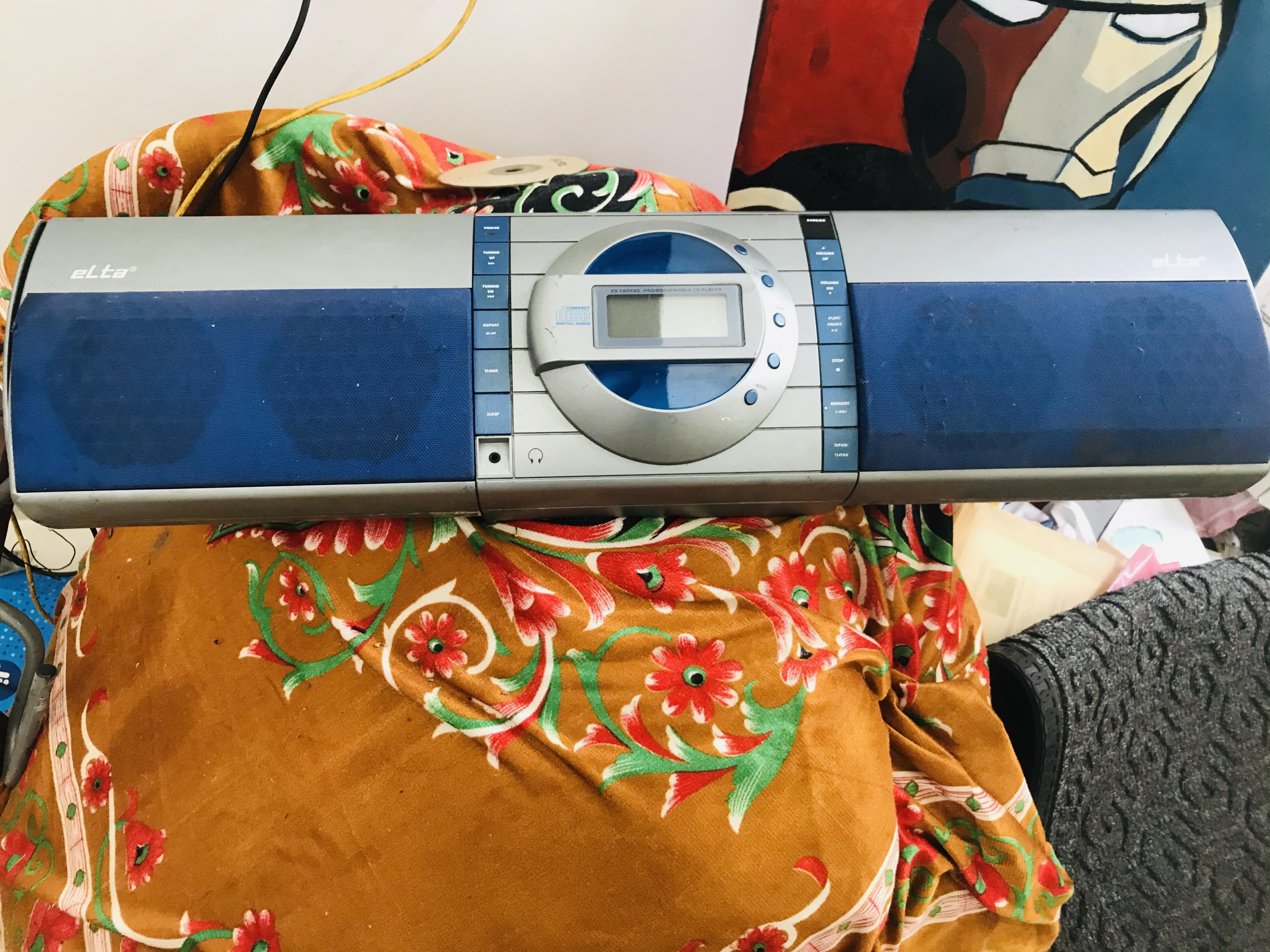

The plastic loudspeaker enclosure will almost certainly be a limiting factor in the audio response of your Elta system.
Applying some viscous damping pads to the enclosure walls would be beneficial.

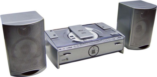

Could you supply a photo of the complete system so we can gauge the extent to which efforts to improve the crossover are likely to bear fruit?

Yes i thought about adding it to increase the lows. Sure here is the picture of the full system.

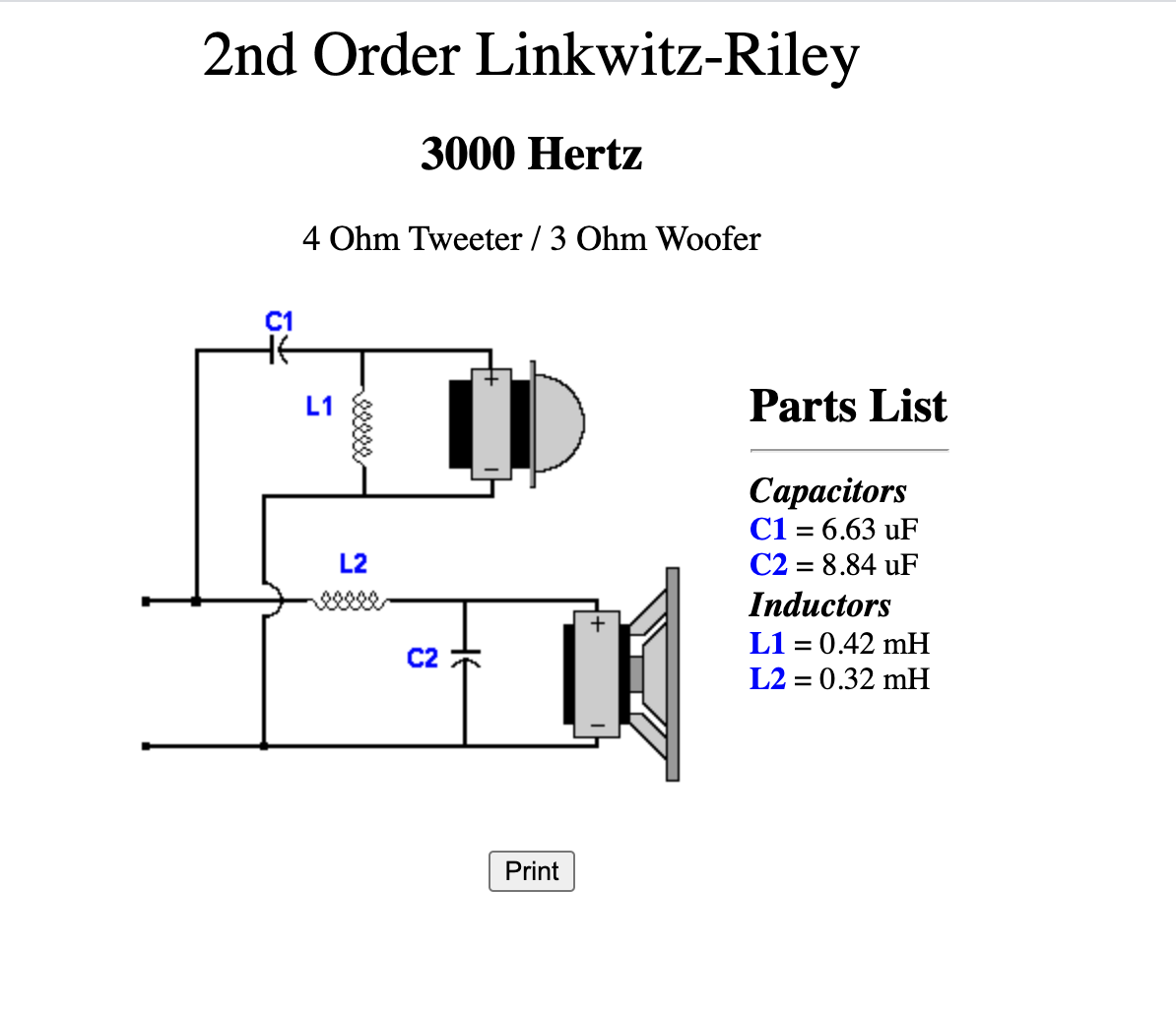

Thanks everyone for the suggestions, the tweeter is 4ohms here is a crossover design i calculated online. Share your suggestions please.

It appears you have assumed that the impedance at the crossover frequency is the same as the nominal impedance - not the case. For these drivers, I'd add a zobel to the tweeter.

However, FWIW found these TSPs for the woofer: Fs 86 Hz; Re, 2.8 ohms; Qms 3.44; Qes 1.16; Sd 63 cm sq; Vas 3,57L.
QTS ~= 0.8675, so you already get a bump in the response when you put it in a very large closed box. Then again, the thread starter wanted punch, so maybe a bump is desired. Otherwise one would have to resort to electronic correction, or an enclosure that rolls off, like a finite baffle or a box with open rear.
