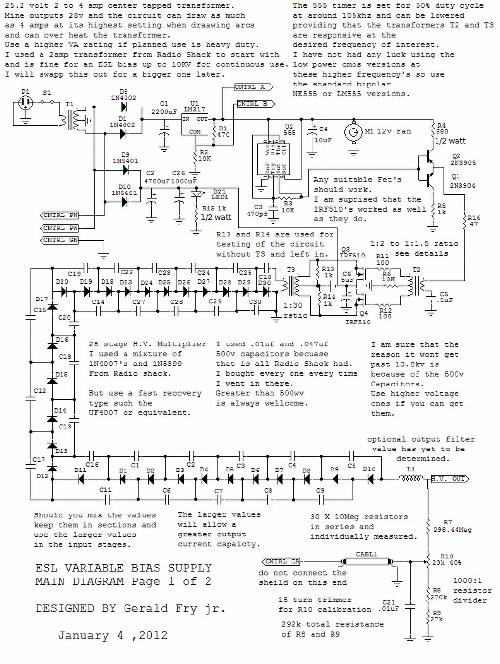

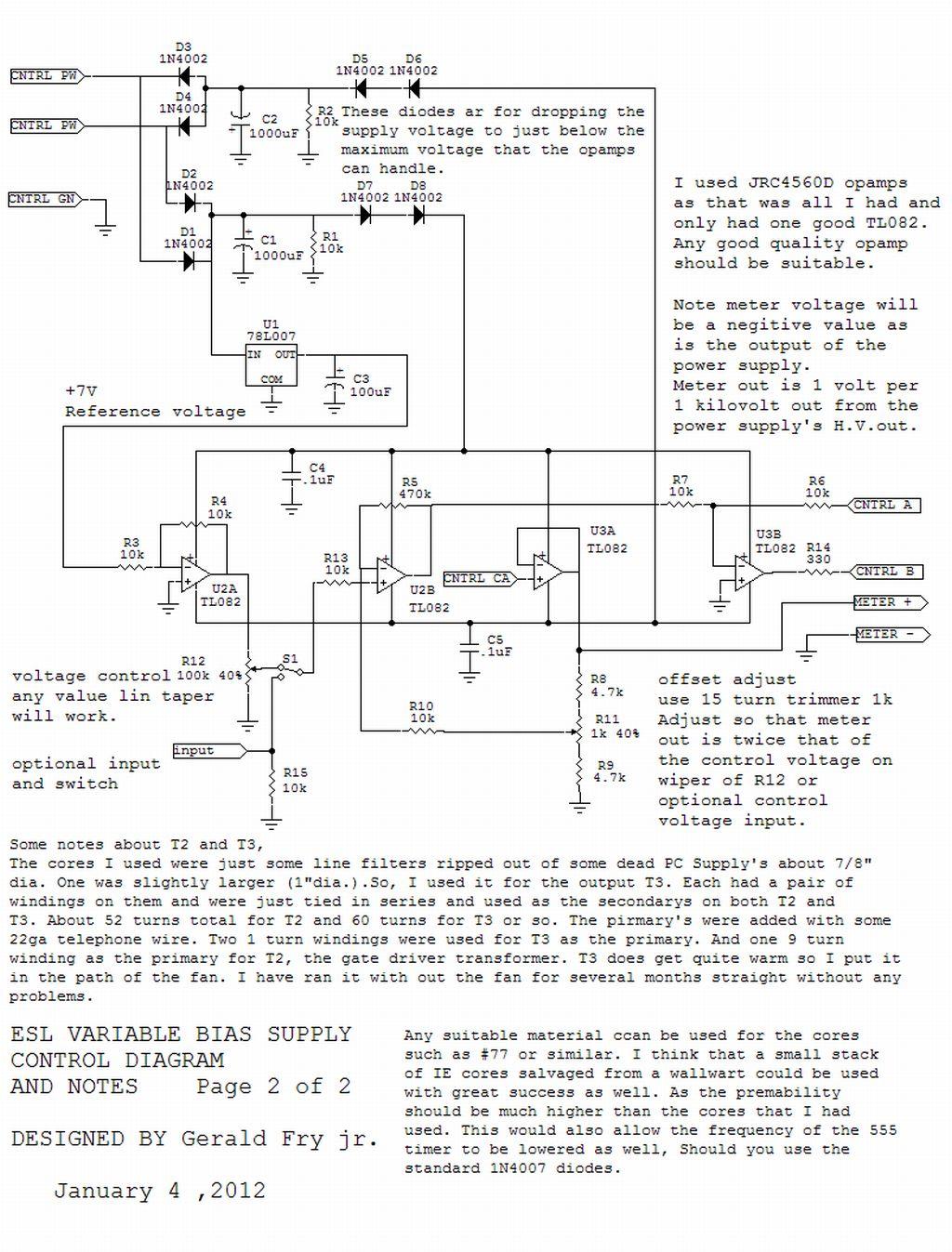

Oh My !!!!
I would just start over and build a new interface!!
Here is a good place to start,
Jazzman's DIY Electrostatic Loudspeaker Page
Jazzman's DIY Electrostatic Loudspeaker Page: The Electronics Package
http://www.diyaudio.com/forums/plan...-hook-up-electrostatic-panel.html#post3768350
If you are lucky maybe the Step-up transformers are still okay.
jer 🙂

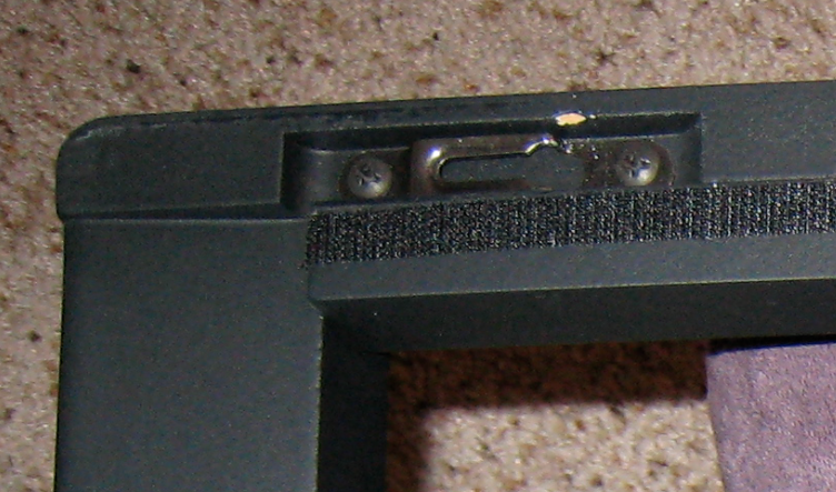

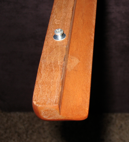

To remove the panel-mounting rails, you tap the end of the rails with a rubber mallet, and they slide up (or down, depending on the model!), releasing the assembly pins in the rails from their 'wedge clips' in the cabinet.
(Does somebody know the proper term for this type of mounting?)
In case it's not obvious, you must lay the speaker down on its back (on couch cushions) before loosening the rails. Somebody on ML Owners' Forum knocked off their rails while the speaker was still upright, and the weight of the ESL panel broke a solder joint.

I would start with square one, and that is to determine if the Bias supply is working or build a new one.
Check the step up transformer if it is working properly and get some sound out of the panels first before you waste your money on new crossover components.
The one main reasons is, If you decide to use a different step-up transformer then your new crossover components won't be of the proper values for the transformer should you change it, unless it is an exact OEM part.
Must know the transformers primary inductance before you can start to design a crossover for them.
It is much cheaper and easier to go active as X83 suggested and will cost about the same if not less by the time it is all said and done!!
And, You may very well have a better sound in the long run as well.

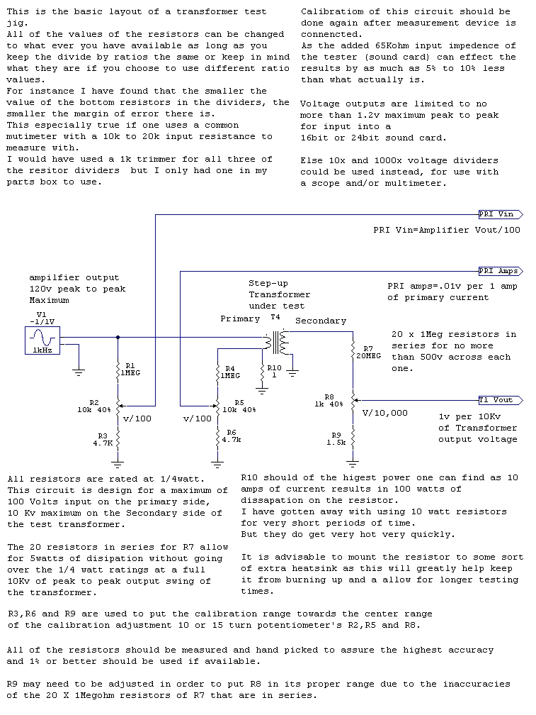

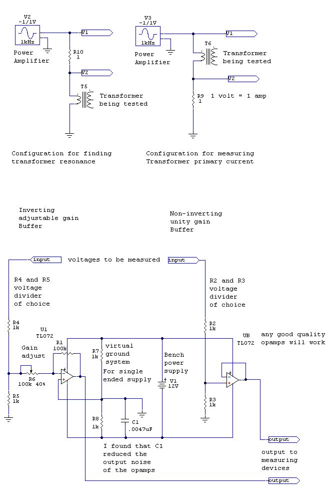

From what I have read about the ML's there should be about 3Kv to 4Kv coming out of it.
You won't be able to measure it with a common DMM unless you make a HV divider circuit as I have described in earlier threads.
Here are the plans as to what I am referring to and hope they give you some idea of how to go about measuring such voltages accurately and safely.
Here are the links,
http://hyperphysics.phy-astr.gsu.edu/hbase/electric/voldiv.html
http://www.diyaudio.com/forums/plan...tor-insulation-mylar-coating.html#post2848194
http://www.esldiy.com/index.php?topic=5.msg24#msg24
http://www.esldiy.com/index.php?topic=177.msg311#msg311
http://www.diyaudio.com/forums/planars-exotics/190716-esl-power-supply-question.html#post3714216
jer 🙂
