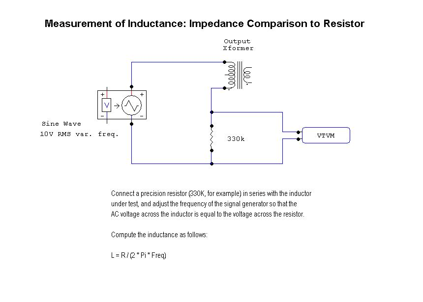

Okay using this method as pictured, I get 525H, seems a tad large. 🙄 I am using a dual channel scope and I get equal voltages all the way from 20Hz to about 200Hz, then a slight unbalance then there is a big dip around 4KHz then above that the voltages get closer but never equal again up to 10KHz. I'm using 40VAC P-P out of my generator
There must be something wacky?? If the signals are balanced from 20Hz up to 200Hz that gives a wildly different range of inductance's. Any other suggestions for measure L?
Cheers
PS going to try it on the secondary and use the formula Lp=N^2*Ls
Cheers
Got it! I used my Fluke 87III instead and found a very pronounced balance point at 1125Hz, which gives me 47H, much more believable.
I'll have to drag my VTVM out of storage to confirm, not sure the freq. response of the DVM, but I guess if it balances it shouldn't matter.

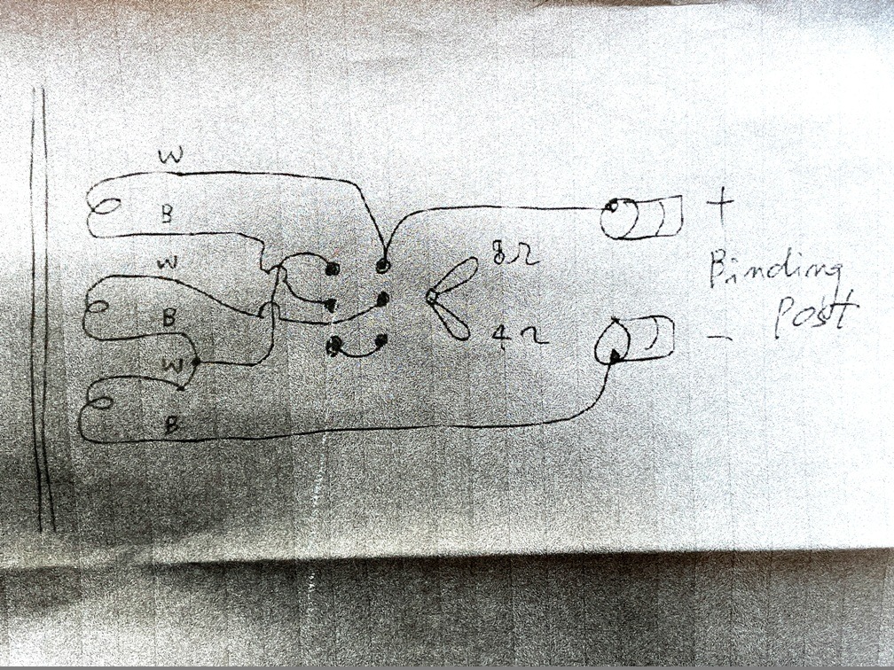

You can get 4+8 ohms (or 8+16 ohms) by paralleling all three or paralleling two with the third in series. That seems the likeliest scenario, with 4+8 ohms giving 2500-3000 ohms primary impedance - which being more common seems more probable.
The trick is then to figure out which two windings to parallel for the higher impedance, for which you need to know how the windings are interleaved. DC resistances might help. If for example the secondaries are located one in the middle of the primary and one at each end, then paralleling the outer windings gives them each half the current, which is ideal to minimize leakage inductance.

Awesome, thank you! I will dig out my Systron Donner 6 decimal place rack mount multimeter tomorrow so I can make the ultra accurate Ohm measurements. I could also try taking the cover off the xfmr to see if I can see the bobbin and where the windings come out.
I have so much to learn about transformer function, I had no idea you could achieve different impedances by paralleling different combos of windings..
Don't get fooled by that trap called "believable".
You need to understand that inductance varies due to amplitude and frequency, because flux density and losses change. Non-gapped cores are also less linear than gapped, so expect bigger variety in inductance values. If you measure at low flux densities, you'll potentially find yourself in the knee region of the core where permeability, hence inductance will be lower than high excitation regions.
To measure a tube output transformer's inductance more accurately, you need a high voltage AC value. One can use the mains voltage via an isolation or slight step down transformer, but mains voltage changes.
I believe Patrick Turner used mains voltage via isolation transformer and used a high pass 50Hz filter to reduce mains voltage lower frequencies fluctuations.
I'm using a simple LM1875 amplifier feeding an inversely connected power transformer and that gives me adjustable stabilized voltages from 60 to 150V with adjustable frequency from a generator.
Then you feed this voltage via a resistor and measure the voltage drop across the resistor. Then you can calculate the reactance across the DUT and finally the inductance.
Look what I found in my inbox when I got home!
My friend found this hand drawn sheet for the transformers he gave me and it coincides with what Paul was saying about using parallel-series combo of windings, too cool. No other info but at least we are on the right track. This is drawn for 4/8 ohms with I'm guessing is the back of a DPDT switch.
So what would be your recommendation? I would really like to have them set for 8/16 rather than 4/8 ohms. I'm heading out to the shop to find my Systron Donner meter so I can start with some DC R measurements.
