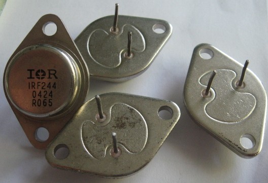

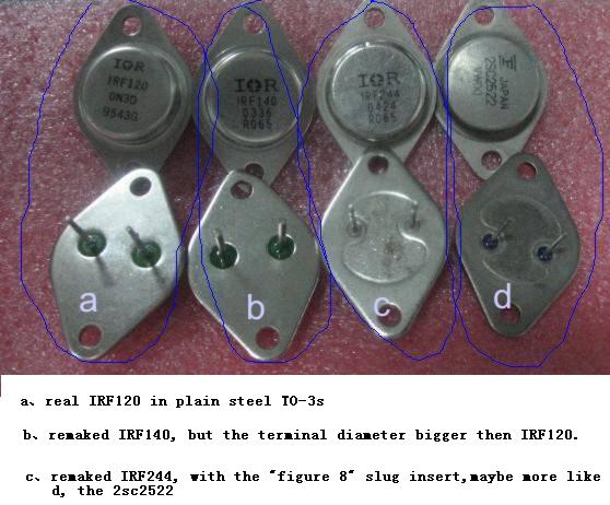

I've never seen IR parts in that sort of TO-3 package with the "figure 8" slug insert. All mine are in plain steel TO-3s. They may be phony or remarked parts from a second or third rate manufacturer. First off, I'd test the gate-source pins to make sure the things are even mosfets.
this is not real IR product
this is remaked from second hand of older IR product.
but they are real mosfet which can be used in any PASS amp , also rugged , beacuse i also have some with same lables,

If they were really IR product, why would they need re-marking? The only legitimate parts I've seen in those TO-3 packages are parts from vendors like Toshiba and Sanken from back in the '80s.

maybe MR. john-china is right sometimes,but please attention the image I attached , I had tested this fet, the vgs is 5V about when ID = 1a, So ,it is a IR parts sure.but I still cannot confirm is IRF244 or not

As far as I know, IR never used the 60-mil pins (large size) on anything smaller than their size 5 die, so the part with the big pins could be a re-marked IRF250 (or IRF150, for that matter). The parts with the "figure 8" inserts are probably re-marked Japanese mosfets and not IR product at all. Will they work in the same application? Try them and see. They may be HV mosfets with a much higher on-resistance, though.
- Help me distinguish the IRF244.
