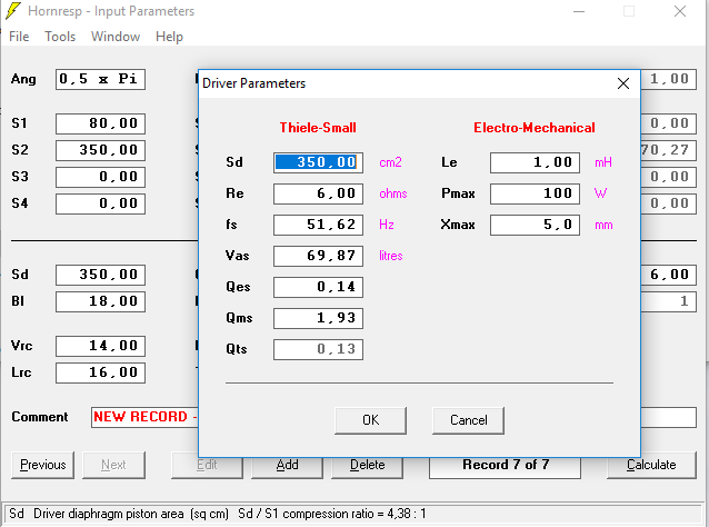

In Hornresp double click the "Sd" input field to open a popup for driver parameters. Then you can save the driver by selecting "File" > "Copy driver to database" for future use. You can "Paste driver from database" to new projects.
I have used hornresp for maybe 10 hours and its still a bit confusing 😀 But here is a quick start for you:
1. Click Add from bottom to start a new project
2. From Help menu, click through Input wizard to get started with tapped horn
3. Input driver parameters doubleclicking the Sd field or paste driver from database
4. start loudspeaker wizard from Tools menu and start fiddling with the values 😀

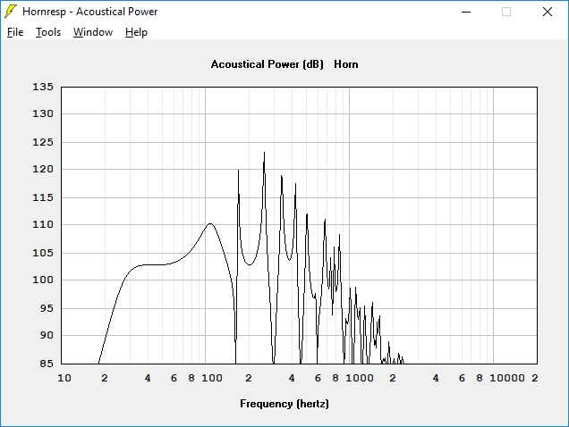

I don't know anything about designing tapped horns. Maybe you could start with WinISD default design for the driver and write the enclosure volume down. Then in hornresp, initially set values so that enclosure volume is in the ballpark. Then try to get good curve (in the power window) by trial and error 🙂

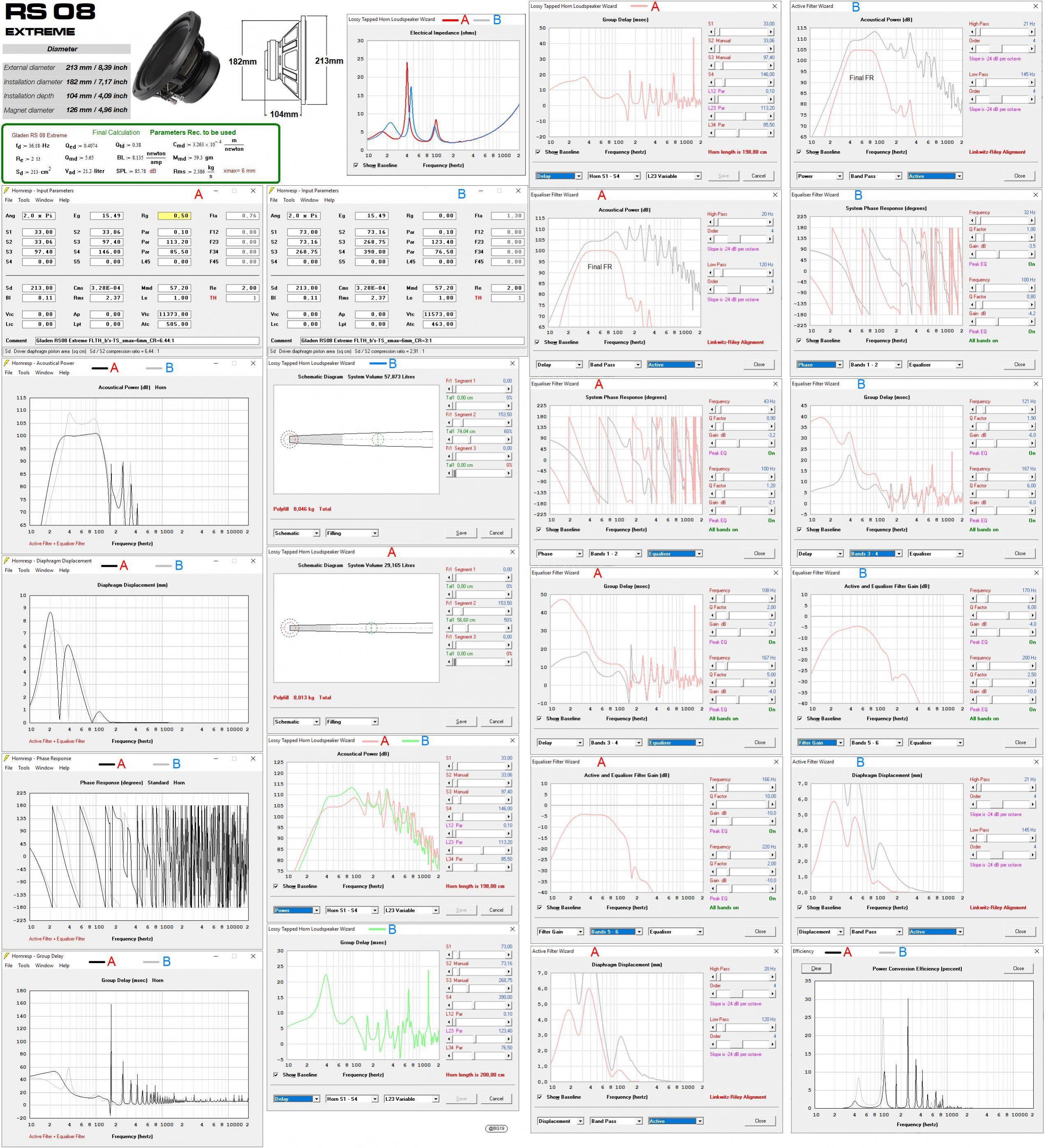

thanks for your replies tmuikku. Well I have read some hornresp tutorials before, but as I said I always failed either about missis parameters or missing knowlege on my part. The links yo posted are quite intressting but in the end didn't melp me. One of these woofers is not available anymore and none of them is 2 ohm. In fact all the stuff I found so far uses PA grade woofers, with 4 or 8 ohmm which are not really suitable for a battery powered solution that aims at maximum efficiency rather than lowest frequency.

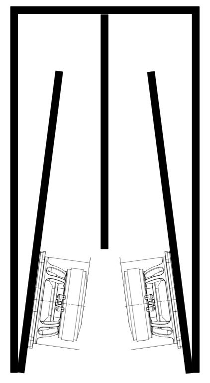

Oops! Ran the numbers, but didn't notice the app! 🙁 Still, not horrendous for a boombox as the basic 36 Hz TH = ~40 L net and the preferred 25 Hz is ~54.9 L net, so ~25% larger once built?
A 36 Hz 2:1 CR TP = ~31.4 L net, though so small in cross section that the motor will stick out through the terminus. 🙁

I forgot to mention, it will be mounted on a handcart, so I could live with about 50 liters.
Please, would you mind sharing your calculations? Maybe there is a sweetspot at about 30hz, where the case ist just big enough to accommodate the driver?

As a general rule, true TH is best when tuned to <Fs. Note that with no inductance [Le] or excursion [Xmax] specsI just arbitrarily used 1 mH, 8 mm since it has a large surround, so performance may not be as good as predicted.
Anyway, load it into HR to view.
