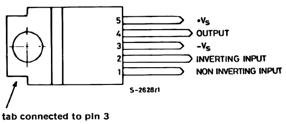

2 About the TDA2040:
This is the main amplifier, so I dont really know if here is where the problem radicates. I mean, if you turn the amp ON and the only thing you can hear is noise regardless of any guitar o knob movement maybe is the amp that is blown. Acording the datashit the maximun voltage (Vs) is 20V but I am meassuring 25V between legs 3 (-VS) and 5 (+Vs). Is this the problem? Is it the power supply? How can I test this amp?

Signal Ground (0v) with TDA2040 pin:
pin 3 (-Vs)= 0.7V DC
pin 4 (output) = 12,7V DC
pin 5 (+Vs) = 24,7V DC
Would you think is necesary to replace the TDA2040?
I'm not convinced yet 🙂
And sorry, I should have asked at the start. If that photo is of your amp then it is single supply.
24 volts on pin 5 and half that on pin 4. That fits with a single rail configuration but doesn't explain why pin 3 is at 0.7volts.

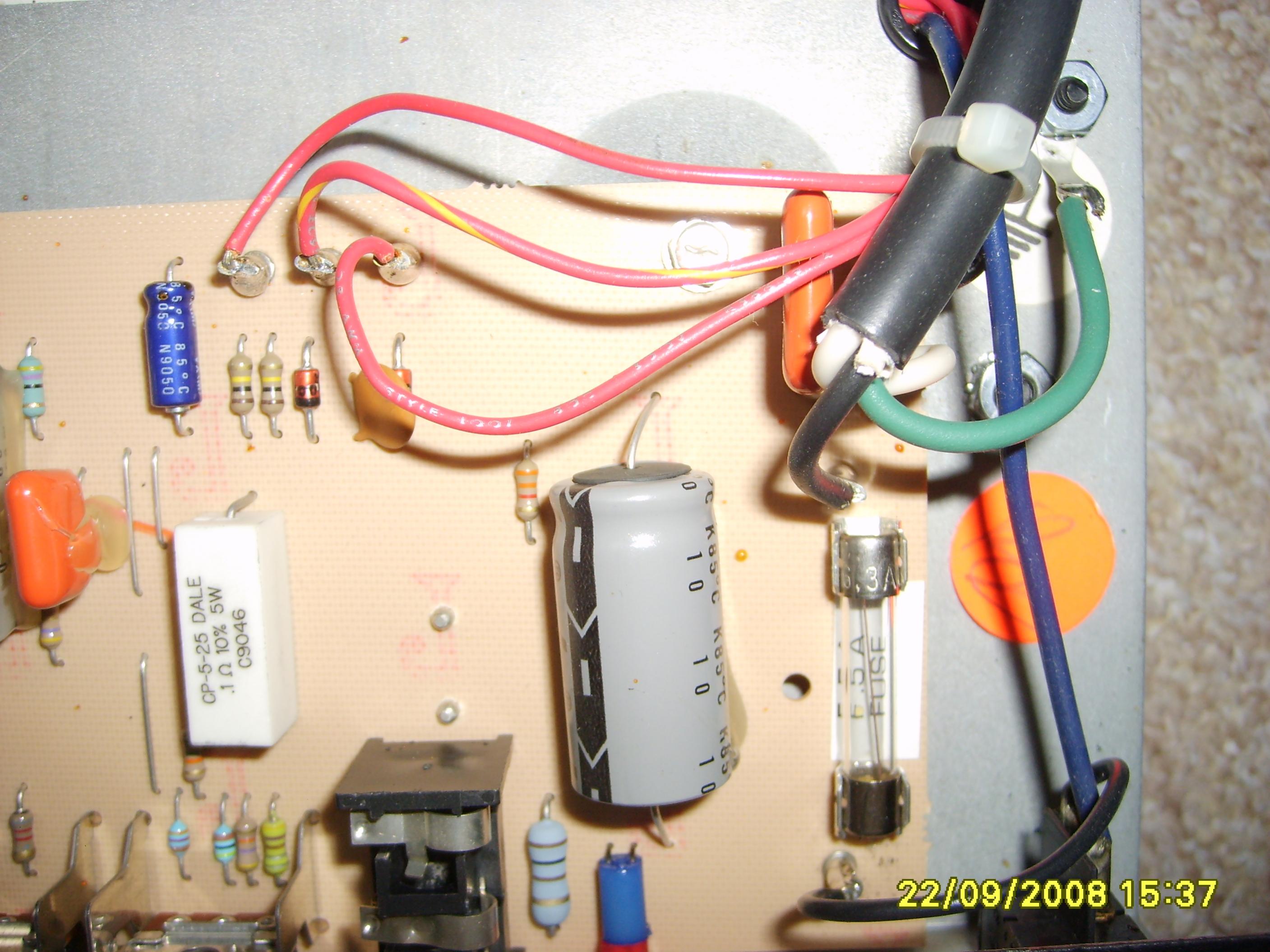

thanks for replay
Thank god there is a main switch with a fuse (220v 5w) 🙂🙂.
My qestion is: how do you measure the transformer wires😕 I tryed to but I do not get eny proper measurements. (By the way it is a working amp) I am curious for I am trying to understand the Transformer.
And thank you for responding.😀😀
Thank god there is a main switch with a fuse (220v 5w) .
Are you sure?
The schematic shows a Power switch and a fuse, but it's on the scondary 🙁
Besides that, post both a closeup picture and a hand drawn schematic of how the original transformer is connected, showing wire colors.
Yes, Mooly's method is fine to measure 🙂
Anyway I ask picture and schematic because Rage has been produced for many years, with some obvious variations, so yours might easily *not* match the posted schematic.
OUCH !!!
Are you :crazy: ?
A 6.3 Ampere fuse in a *clearly* indicated 0.5A clip 😱
Well, besides that, you will need a 220V to 18+18V , 30 to 40 VA .

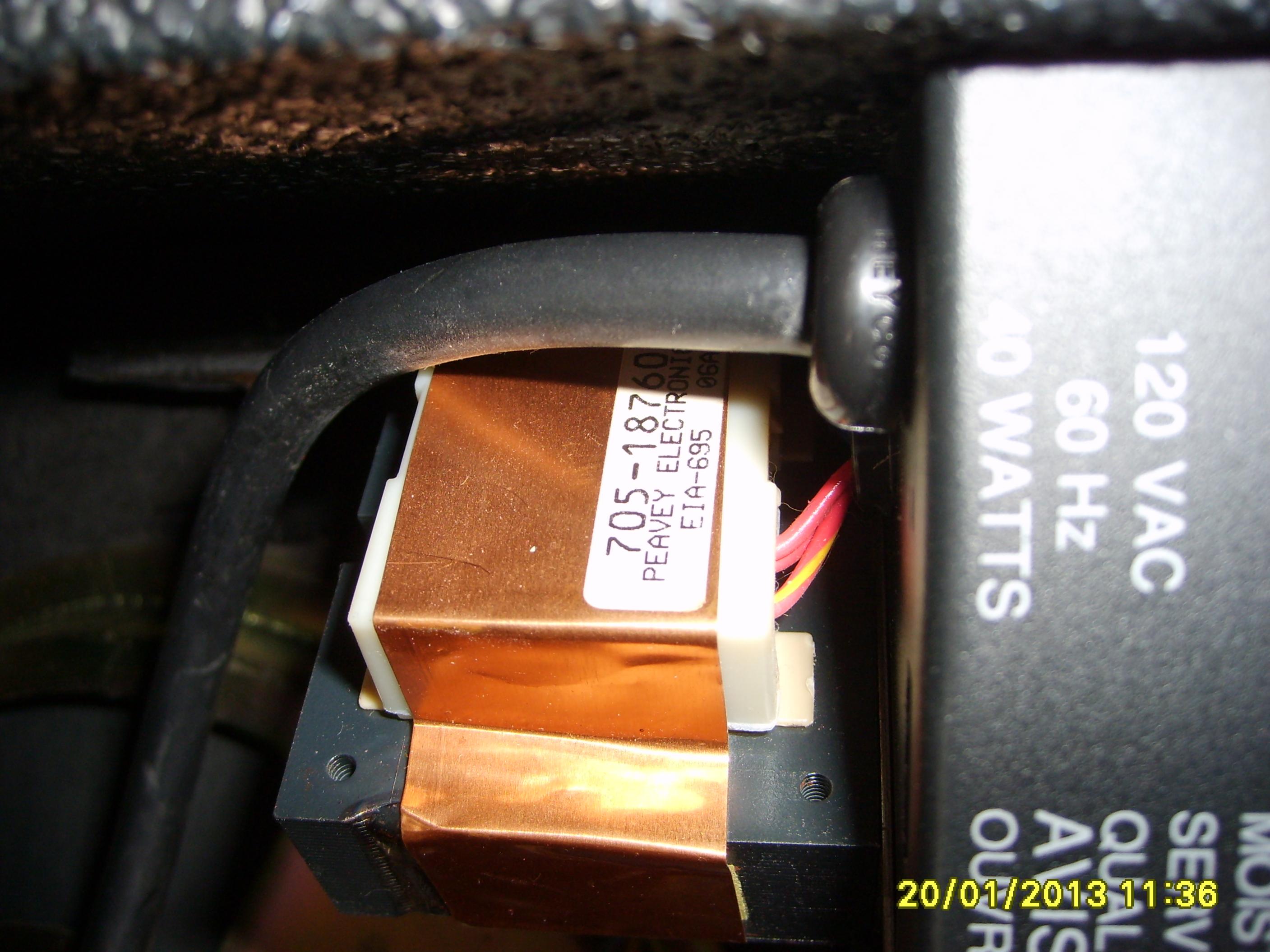

PS: probably irrelevant but I got curious: why are the pictures 4 years old?
oeps
Yes
your right😱 wrong fuse I have'nt looked that close.
I will change it right away😀
And the date🙄 I changed it also😱.
Here's the right date.

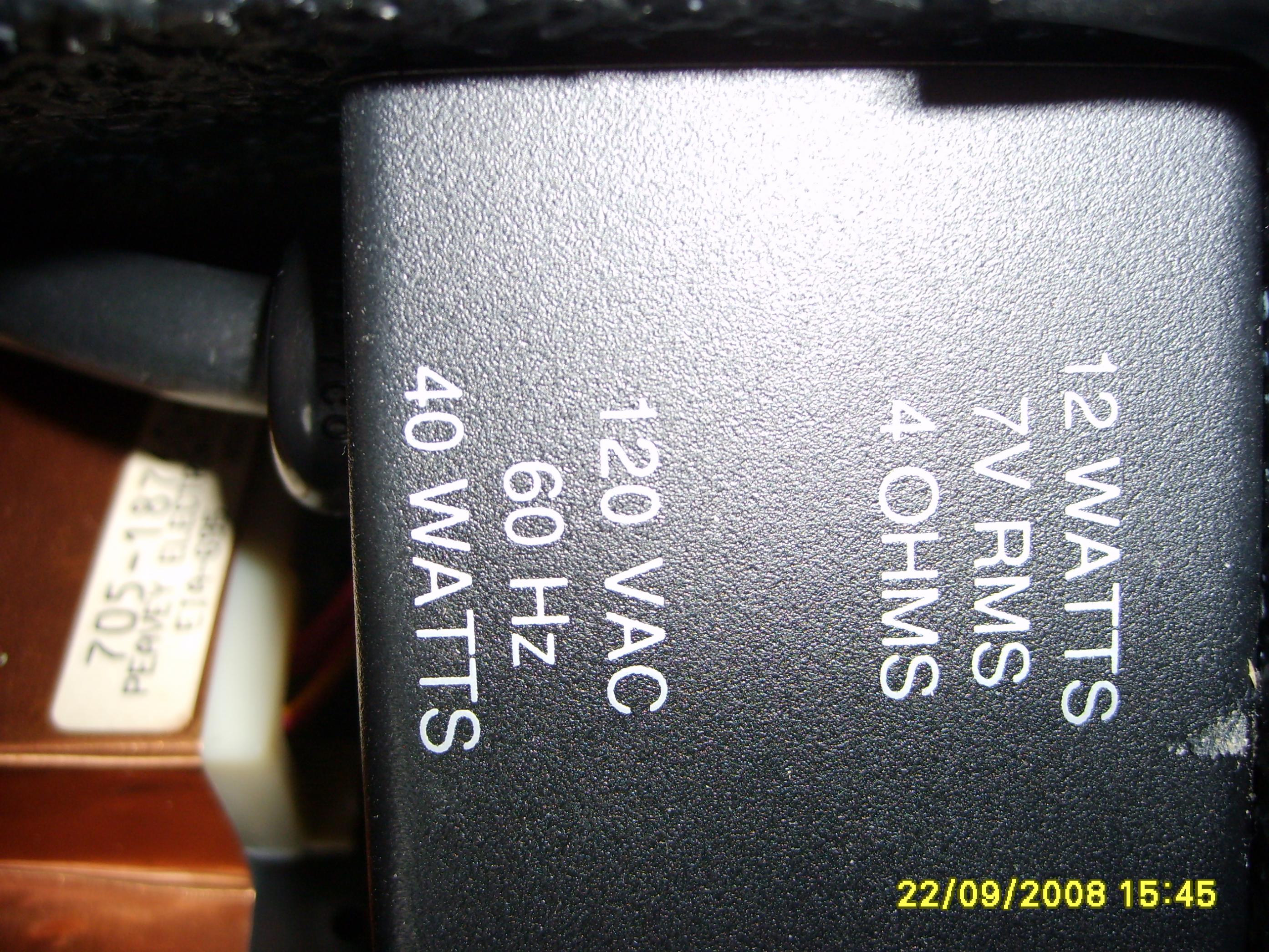

Could you explain the (18+18V , 30 to 40 VA .)
You mean, besides being what Peavey originally used ? 😛 😀
I don't have one here, of course, but post #3 claims:
it has a transformer with two secundary coils and in each one I meassure 18V AC.
Since you "can't measure" it 😕, I'll have to settle for second best, which is what somebody else posted.
Your picture matches the one on post # 3 , and both show 3 secondary wires: two red ones (18 + 18V AC) and a red/yellow center tap.
Neither yours nor # 3 matches *exactly* the schematic #3, which shows a single (red red) secondary with no center tap, and rectifies with a bridge (4 diodes connected in a "diamond" pattern).
Yours used a Red/RY/R secondary and 2 rectifiers (the glass 1n4002 shown).
Same end result by different means.
And the 30 to 40 VA size comes from the circuitrequirements.
By the way, Peavey itself prints "40W" (really 40 VA) as "power consumption", so, who am I to disagree? 🙁
If you want to measure your transformer (recommended), set your multimeter to the 200VAC scale , touch ground (chassis) with black probe, measure with red probe touching red wires.
