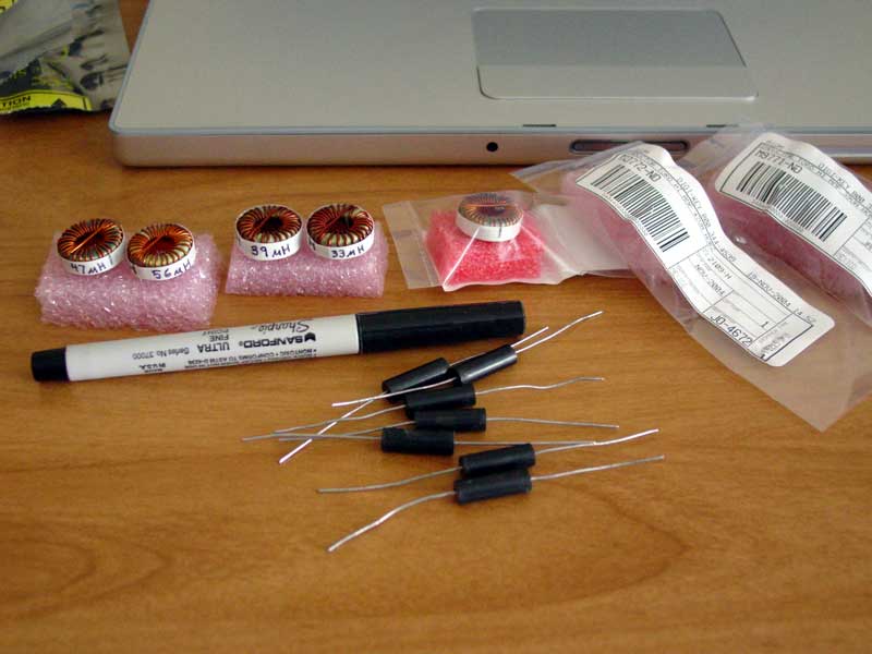

Anonymous - I have a couple spare inductors I could send you that have a much more than adequate current rating for your project. They won't exactly fit on your board but they would be good to experiment with.
I've got some toroids and wirewounds in 33, 39, 47, 56uH values. Current ratings are easily above an amp.
Thanks for the offer Brian. I don't want to take one of your inductors from you just for testing purposes, as I would still have to buy a surface mount version through the mail if it worked.
Will an air-core suffice for testing? I don't have an inductance meter but I'm sure I can easily get in the 20-50uH range using an online air-core calculator based on wire gauge.
Take it from me? They're just sitting around in a box doing nothing! It's a lot cheaper to test with these, figure out which one works best, then buy ones you know will work. I'll drop a few of the axial ones in an envelope and send them your way. An air core inductor would work, but will probably be bigger than any of the ones in the photo.
How do 27, 33, and 39uH sound? I would send the toroids but they would be way overkill for you application and are quite a bit heavier.

If you want to sacrifice a toroid and have enough wire, wind 2-3 layers on one of those cores. That should get you in the neighborhood of 30-40uH.
No stinkin' toroid winding here Brian. They are the AMP32 kits, not AMP3. The AMP32 comes with pre-wound high current SMD inductors.
