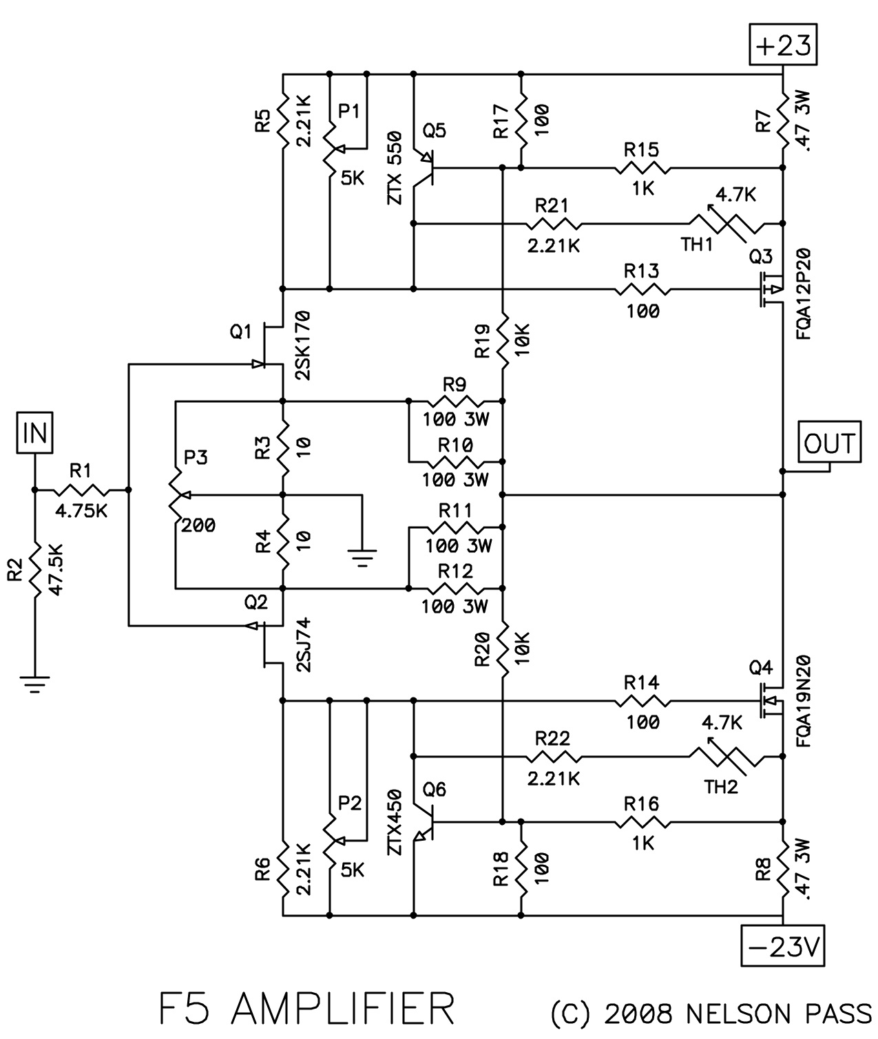

So it seems since 2011 when i looked at my F5 last, i've misplaced the hard copy of the schematics for it.
I went back to the Pass DIY website but didnt have any luck locating the F5 schematic. Anybody help me figure out where it went?

First watt site, products, F-5, manual.

Be careful!
There have been revisions to the boards and circuit.
Components are numbered differently on some revisions.
Check and double check that the circuit and board match!

Yes, that's right! I think the latest F5 schematic is in the F5 turbo article, with the addition of P3.
Yes, and the F5 PCBs currently available (version 3.0) in the diyaudio store

The store should also have a schematic and BOM for latest version. Reading F-5 article is a must have refresher
The schematic that i'm looking at looks correct, it also appears to match up with the amplifier boards i have, so all is well!

The DiyStore have linked the schematic for Cviller board v2 while the clone boards they ship out is v3.

What are the differences? P3 and double check for pin orientation?
I dont have the schematic for v2 but Resistor designation differ from the stock F5 schematic and the stock v3 schematic. P3 can be omitted for the v3 boards.

The turbo article from Nelson pass introduced a few changes which are incorporated in the V3.
- Small change in protection circuit
- Re-numbering of a few resistors
- Introduction of P3
But bottom-line is that the V3 board matches the stock F5 from the F5 turbo article.
