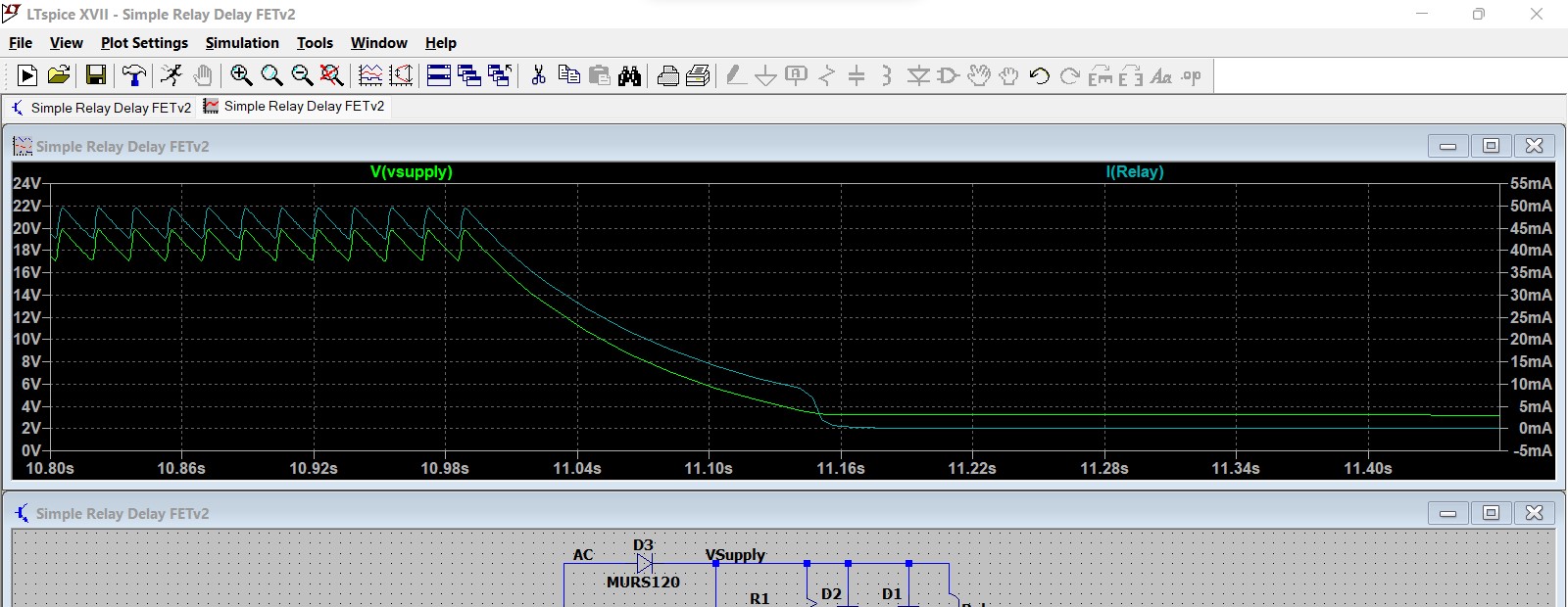

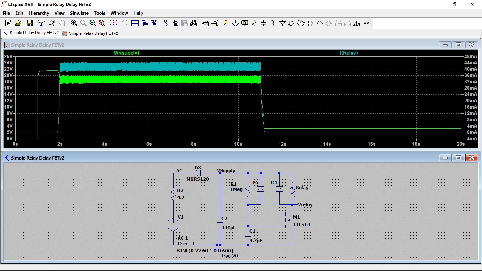

You might be able to get away with a super simple circuit to disconnect the speakers at power off.
Something like this. AC from the transformer is rectified and produces the rail to run the relay, however the small value of reservoir cap ensures the rail collapses very quickly on power off. It is totally tweakable to all kinds of voltages. It also gives a delay at power on.
Trace shows the AC voltage appear and disappear and corresponding DC rail (power on and power off) and the relay current.
Second image is a close up of the switch off point. Would that be fast enough? It is worth experimenting I think.
