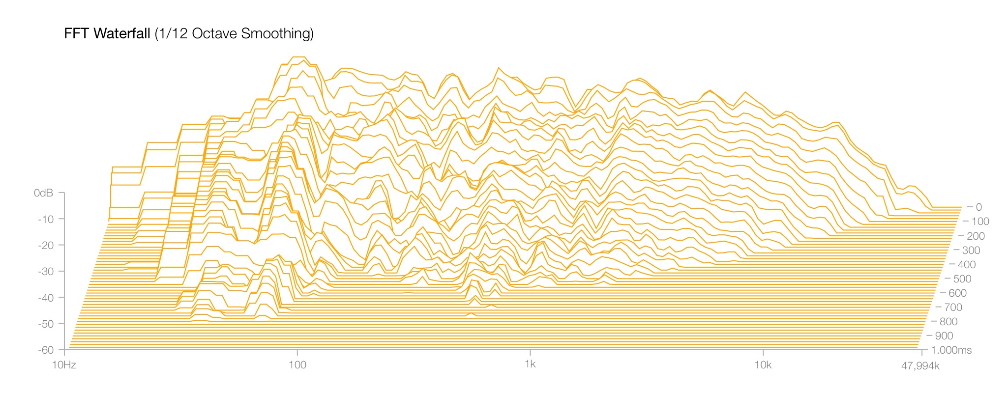

I finally bought a measurment microphone to be able to guess a bit less when building speakers. To use what's offered I also did room measurements that seem off. First the gear:
Dr. Jordan microphon (IEC60651 Class 2)
RME Fireface UCX interface (set to 96kHz)
FuzzMeasure 4 software, loopback function enabled
Class D amplifier board, flat from 20 to 20k
The microphone was placed pointing downwards onto a carpet, room center distance to carpet 1.5 meters.
Plots:

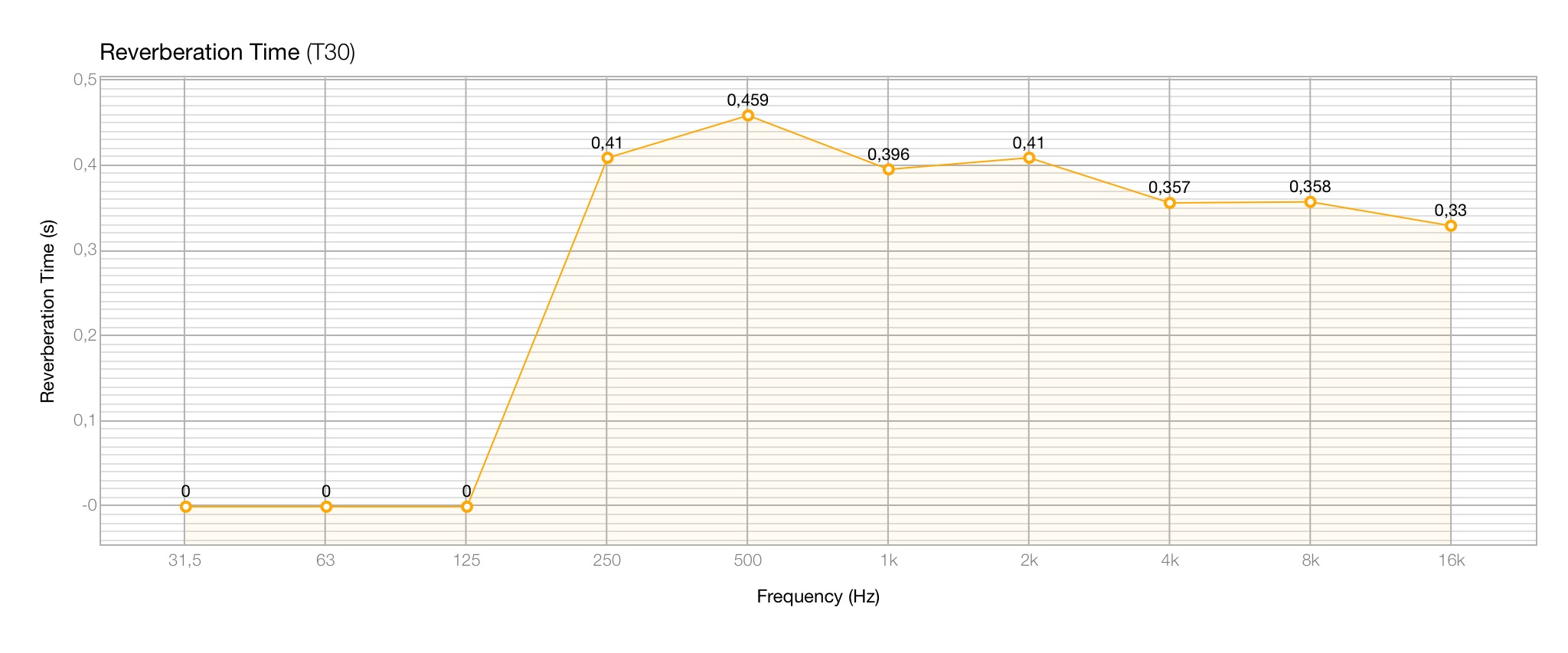

I hear a distinct slap echo after the sweep is done and always was aware of a very distict slap echo when clapping my hands. When doing the measurements I heard the sweep ring for about two seconds after the sweep. Neither the waterfall plot nor the RT30 plot seem to show any of that, right?
Am I misinterpreting the graphs or just expecting too much?
I would be happy if you could could give me some input on that matter. If you need more details, let me know.

These are too small for me to read, but a slap echo you will see a dip and re-appearance. I do see that towards the lower part of the range, just below the second numbers I can't read.
The first signal has a strong bass mode. See how it vanishes and comes back a couple of times?

Unless you have your room or speaker calibrated when you measure a speaker in a room it is a combination of the two.
If you want to see how the room affects the speaker the ETC (Energy Time Curve) or spectrogram graphs are very useful. In the ETC you will see the impulse and then later in time the reflections. The spectrogram will give a different representation.
The length of the sweep you use will have a big impact on what you hear when listening to it. If you use a short sweep at a high level a very large amount of energy is output in a very small time, in a room that sounds really loud and is likely to excite the echo. Use a longer sweep and it won't sound the same when you listen to it.
Without seeing the scale of the graph it's hard to judge but the RT60 seems quite even and if it is the range of 400ms then it is a fairly normal room without much treatment. Your room won't be ringing for 2 seconds unless you live in a concert hall 🙂

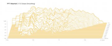

A waterfall or CSD graph can be very tricky to interpret because it depends very much on the window settings you have chose. In all the graphs there is a trade off between frequency and time accuracy. When one is more accurate the other is less.
REW Room EQ Wizard is free measuring software that has good graphs and is familiar to a lot of people on this forum. It is free, try it out.
Is your microphone calibrated and do you have a 90 degree file? If your mic is calibrated for 0 degree (pointed straight) and you use it at 90 degrees there will be quite a difference in the range above 1kHz, if it isn't calibrated at all that adds another unknown into the mix.

Ha ha, yes possibly your ears. 🙂 To be honest, I don't see the 1K echo in your graphs. But I know the sound well, it's typical of bare rooms with gypsum board walls.
Do try REW, it will run on the Mac and is a common platform here. Plus you can upload your REW files for others to look at and analyze.

The graphs look pretty normal. Using longer sweeps is unlikely to change the graphs, it was more to demonstrate that the sound you hear is very different due to the time the energy is released over. I don't recommend listening to the sweeps unless you have to, particularly if they are loud. I set REW to start after a few seconds delay and walk out of the room. Limiting the frequency range is fine if you are only interested in that range but it won't change the result.
What is it that you are trying to achieve with measurements?
