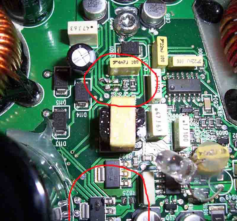

here is a picture of them. what is that thing in the middle of the 4? does it need to be replaced alongside the resistors? should i look for anything else? or just change these 4 and go try it?
of the 4 there are 3 different manufacturers? is this important?

The two on the left are the rectifiers. They're probably not defective and won't need to be replaced.
If there are only two of the 75339s in the amp, you only need to replace those two. Are there 2 more 75339s on the other side of the amp?
The device under the foam is a thermistor. It's unlikely to be defective.

i replaced the 2 transistors numberd 75339p and now it will power up if apply power via a resistor but if i apply current directly from a power source it immediatly shuts off the power supply.
It appears that at least one of the PZTA56 transistors has failed. The resistor to the right of it is likely a 10 ohm. Replace both of the PZTA transistors (there should be another one very near the burned one) and both 10 ohm resistors.
Try to read the numbers off of the right-most resistor in the group of 4. All 4 in that group will likely be the same. They will have to be replaced also.
All of the components above drive the power supply FETs. If they were defective, it could have caused the new FETs to have failed. You will need to check the FETs. If they burned only after the new FETs were installed, there was a solder bridge on the FETs or the FETs failed because they were not clamped to the heatsink.

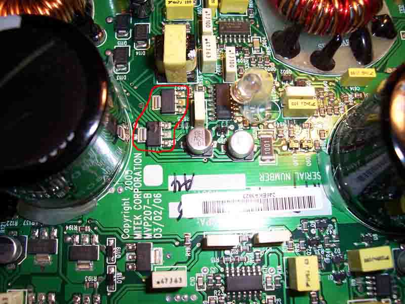

Those are probably both PZTA56s but I can't read the numbers on them. Do they both have A56 on them?
Are they both connected to the yellow transformer next to them?
If so, they are the ones you need to change.

and yes they are both marked A56.
