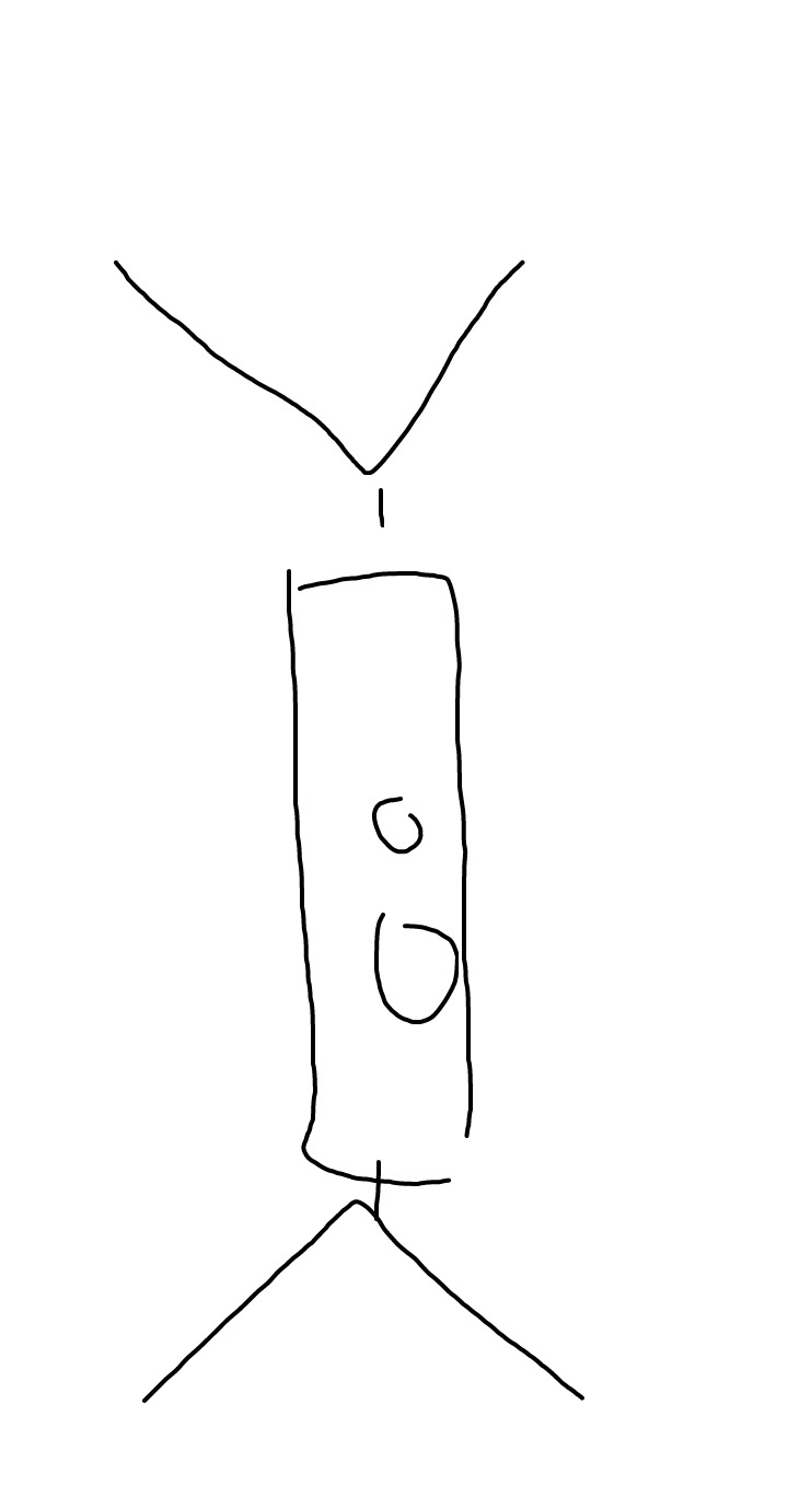

Next possibility is corner placement in a box, look my concept
with 2 fullranges

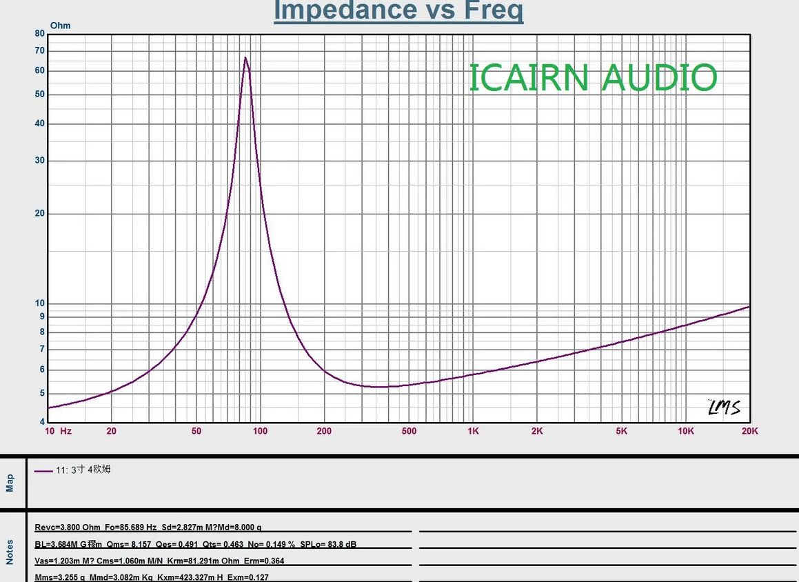

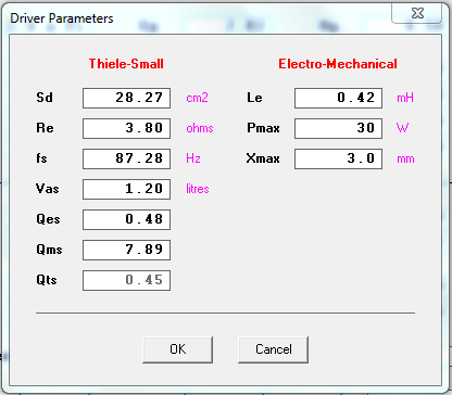

Don’t see any specs for the 3”, maybe an 85 Hz Fs. If it is that low sensitivity its likely closer to 84 dB.
Lii are remowned for their poor data, looks like start it out in a sealed box(ideally about 45 litres using the provided data). I doubt very much it is anywhere near that sensitivity. Unlikely with that Fs and Vas. Unless they have a significantly rising response and are measured up there (ie Visaton B200 is rated at 95 dB but is actually more like 89 in real life). I have yet to find a whizzer cone driver that does not benefit from phase plugs.
I don’t see how you use these together other that as 2 loudspeakers, if used together the 3” as rear surrounds.

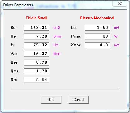

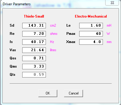

Below are the specifications if it still matters

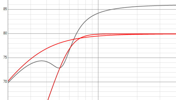

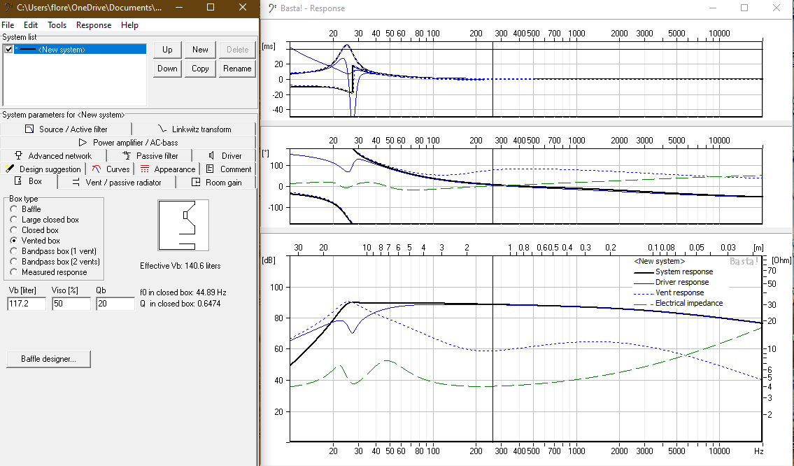

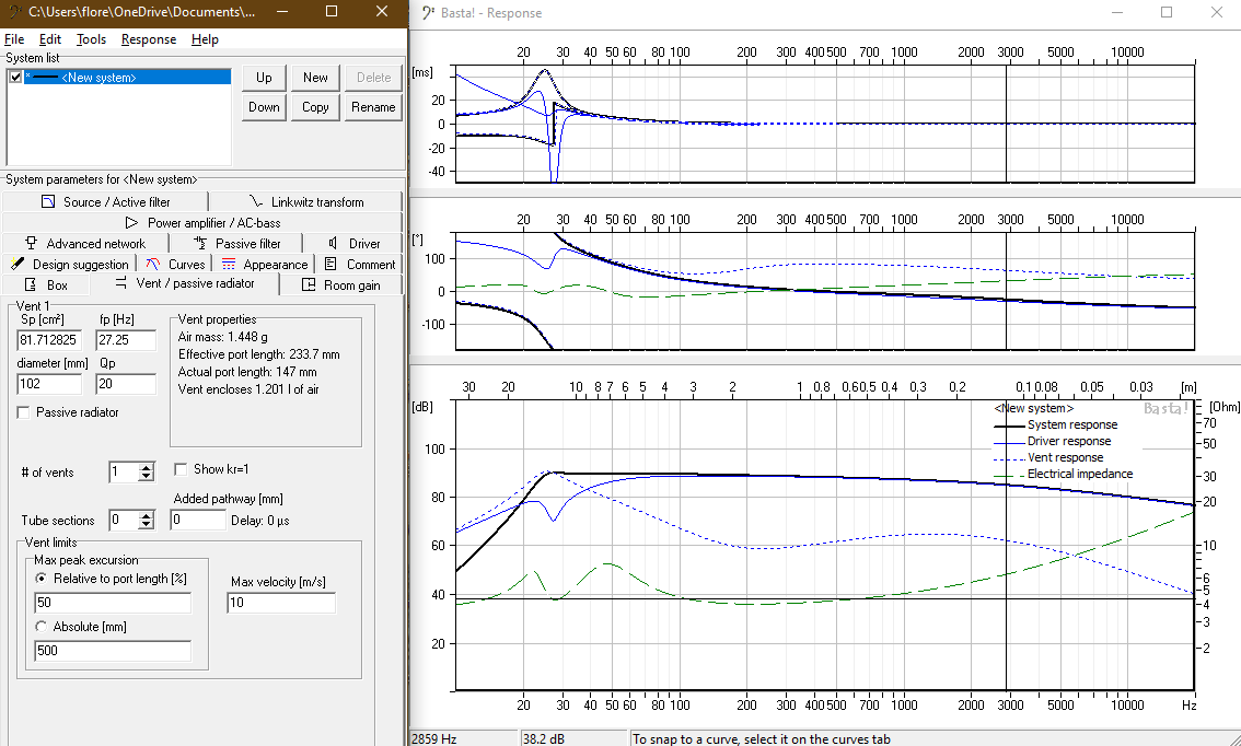

The alignments in post 8 are kinda ugly. You don’t want all those bumps. It should have smooth monotonic roll-off for best sonics.

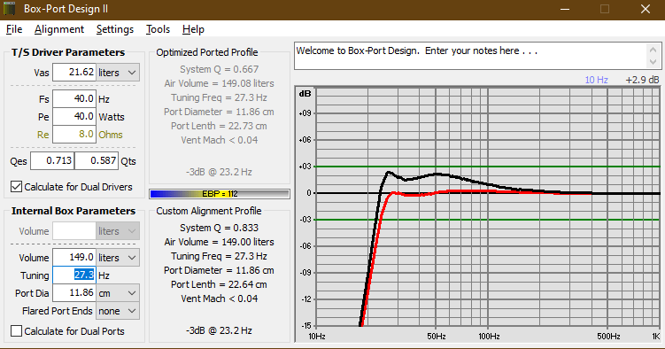

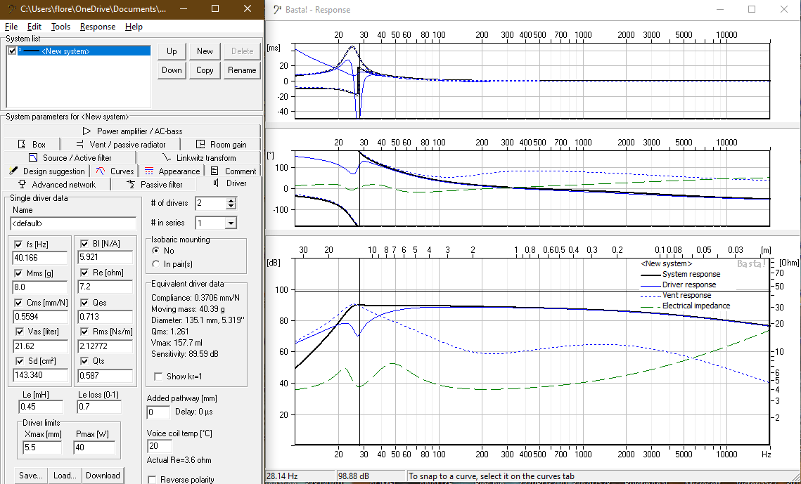

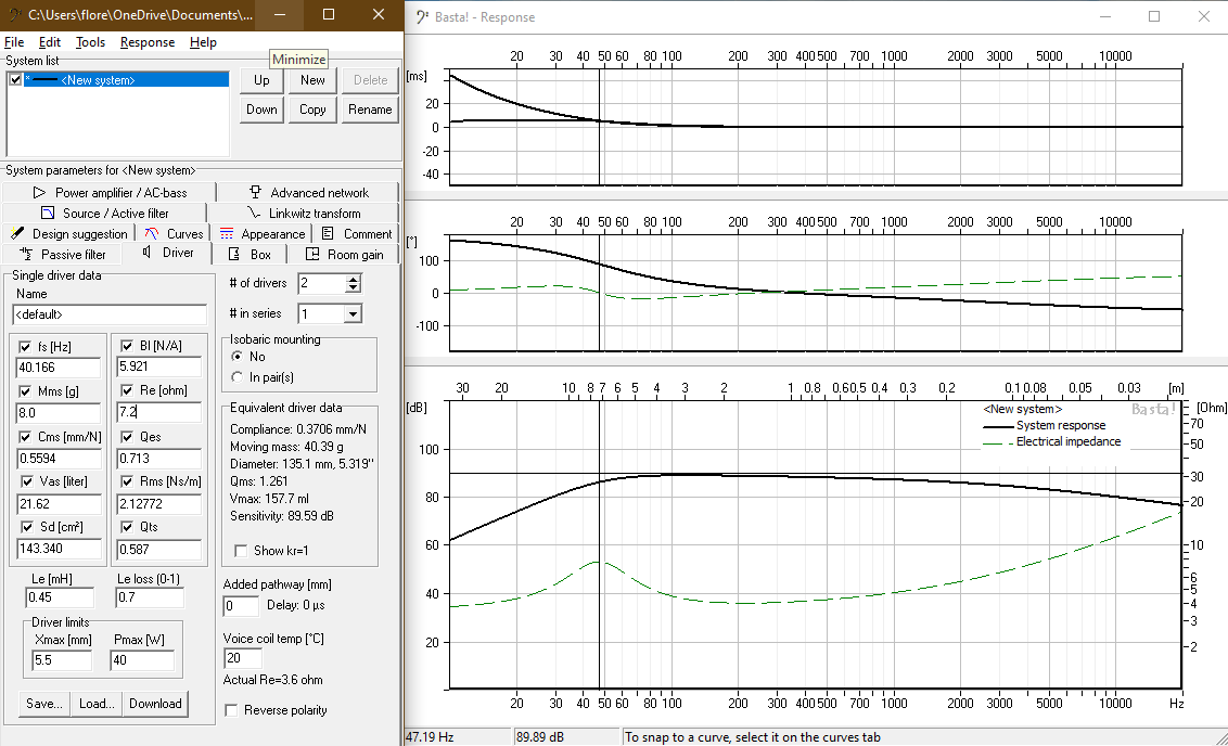

Hello again. So, the profile I will use, the one from the program is the one with the frequency response with the red line, the optimized one. The black one appears by default. To me, one seems relatively linear but not perfect, the red frequency response (the optimized, just ignore the black one, it's the customized one)
What tuning frequency and literage would you suggest or think would be suitable for those 6-inch speakers

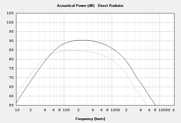

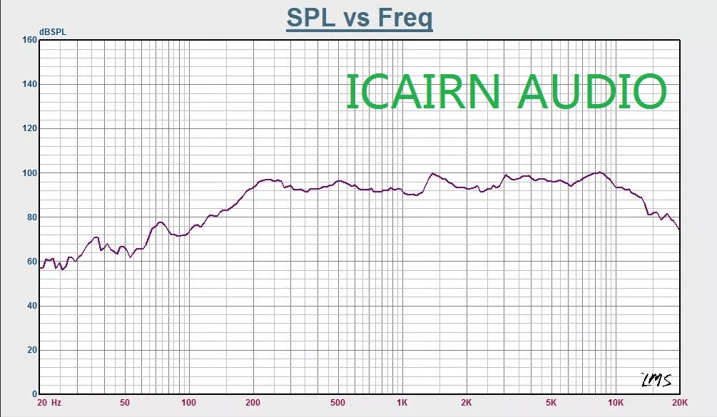

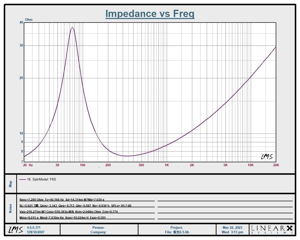

The various specs don't line up real well, same as other Lii and similar, but simmed both ways there's > a dB difference in an IB (> 12 L), so better than usual for them, though with no Xmax, guessing its rolled surround is good for 3 mm = down to 200 Hz/30 W/100 dB/m/2piBelow are the specifications if it still matters
Sadly, the same can't be said of the F6S (shadow is T/S, solid is Bl, Cms, Mmd), so use worse case T/S and hope for better than predicted performance?

Looks like a high Qts speaker = .587 as shown in post #8
Will model a little strange.
It is common to use Qtc of .707 for woofer.
But with high Qts the Q of the cabinet will be on the high side.
Might be more likely for a large sealed cabinet.
Response wont be flat, will have a bass boost in sim.
For a real world application that is realistic.
149 liters!! or about 5 cubic feet is something a 15" would
use, huge huge box. But somewhat normal for a " Auto"
calculator. Will make the box very very large.
To make cabinet Q .707
Fs is about 40 Hz dont expect more bass than that.
More likely 50 to 60 Hz
And high Qts speaker will have a bass boost and will
be more realistic in .9 or Qtc of 1
Would have to sim to find something realistic might
even be sealed.
Not to sound negative. But a 6.5" speaker with high Qts
is usually made for a sealed car door. common factory speaker.
About what this is. Glorified wideband factory car stereo speaker.
All good just a guess a large sealed box and Qtc will be high
around 1 or 1.1
Just a confusing and tough to model driver for first project.
Since a auto calculator trying to make it " Flat" will make the box
very very big and not realistic in real world.
Even if sim shows amazing low end.
In 5 cubic feet the speaker would hit high distortion
with very low power.

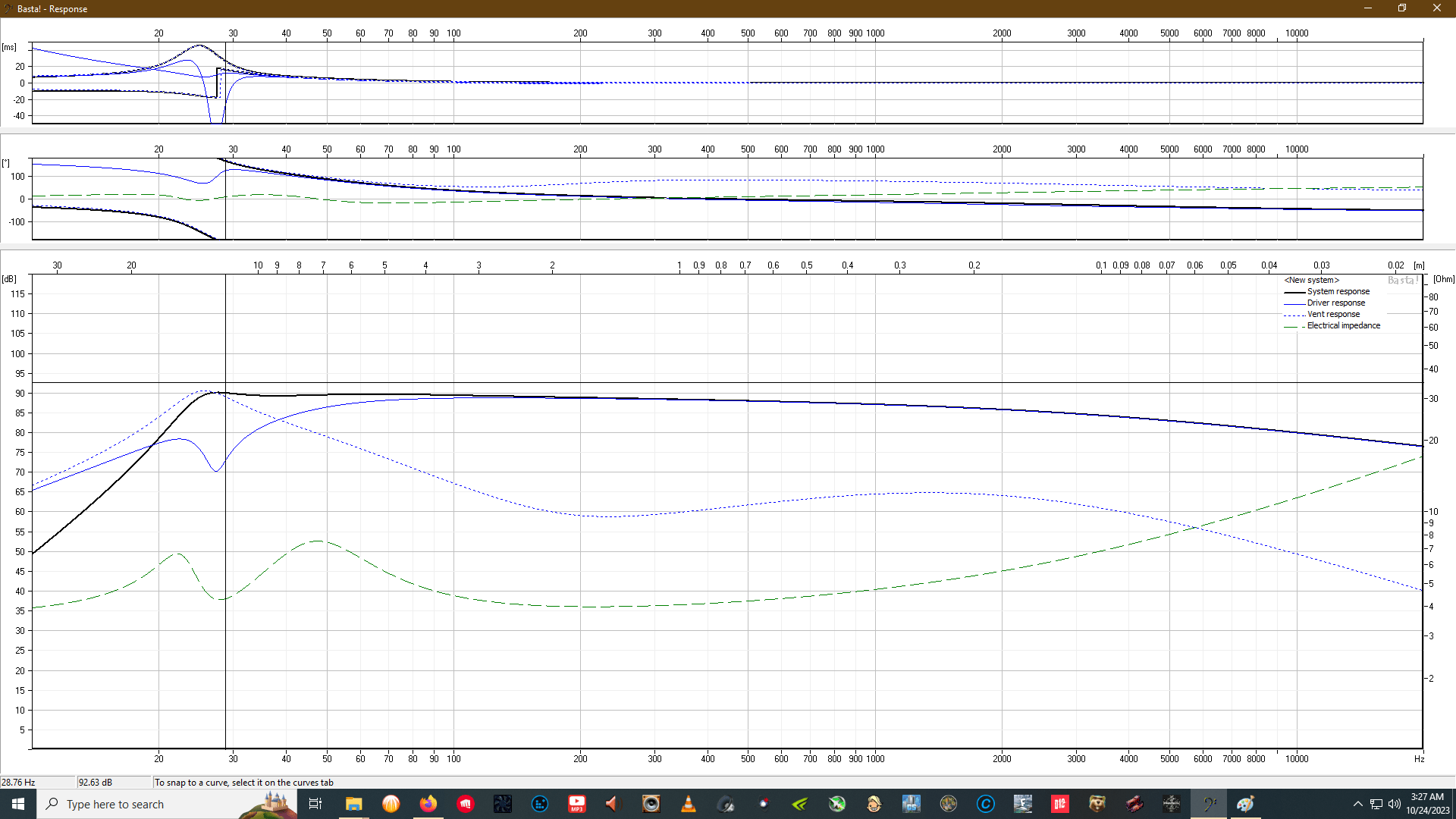

Greets!What tuning frequency and literage would you suggest or think would be suitable for those 6-inch speakers
None till I know what its real specs are since based on their published specs there's way too wide a range difference!

Not as bad as the black one but still not pretty.

Understood, but they're bogus as I proved in the two IB sims, i.e. using the measured specs that calculate T/S specs (Bl, etc.) shows a radically different efficiency and much higher Fs (no longer a woofer per se), so either accurately measure yours, which typically will create at least a slightly different response or use an averaged set of specs or choose one and hope for the best.These are the T/S specifications from the 6 inch speaker that appear both on aliexpress and on their original website. For a speaker that will use both speakers, do you recommend a closed or ported enclosure?
