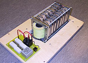

This is a call to all the forum members that have a knowledge of transformer design. You guys are in here I have read snippets of information posted from time to time.
What Is being tried is a copy of a design shown here.
I have been in contact with Arto Kolinummi (one of the co-designers ) and asked him if he would mind an attempt at reverse engineering the full range transformer that he and a friend created. HE said go for it!
http://www.ele.tut.fi/~artoko/audio/audioindex.html
Check out the full range transformer section.
From what I can gather the trannie is constructed iin a manner that permits it to have a wide frequency response into a capacitive load ( those big ESL panels )
As a step up trannie does effect the sound of an ESL it's surprising how many designs stand on the shoulders of others. What they did was actually legitimate design and engineering. The actual design and engineering work is above my current knowlege of transformers. I'm not familiar with the techniques of interleaving and so forth. Maybe someone could direct me to a good source book. But the actual winding is probably within my capabilities. But I'm pretty sure that there are members that could take a stab at it. A basic question is what kind of ferrite for is used for the core? THe circuit board in the front of the picture is the HV bias supply nothing to do with the trannie.

Here is what I have so far from Arto:

Yes the load is basically a big capacitor. THe cores in the picture are split to allow the bobbin to be inserted. It is also true that the load the transformer sees being capacitive will cause a reactance ( a little fuzzy on this part actually ) that will basically increase the load to the tranny as the frequency goes down. Hence the note from Arto that they went through great pains to design a trannnie that was very low in it's self inductance. ( Agin I think this is somewhat true ) My only guess is a type of bifiliar winding. I really don't know enough about the subject yet. But with the posts coming it may all fall into place.
