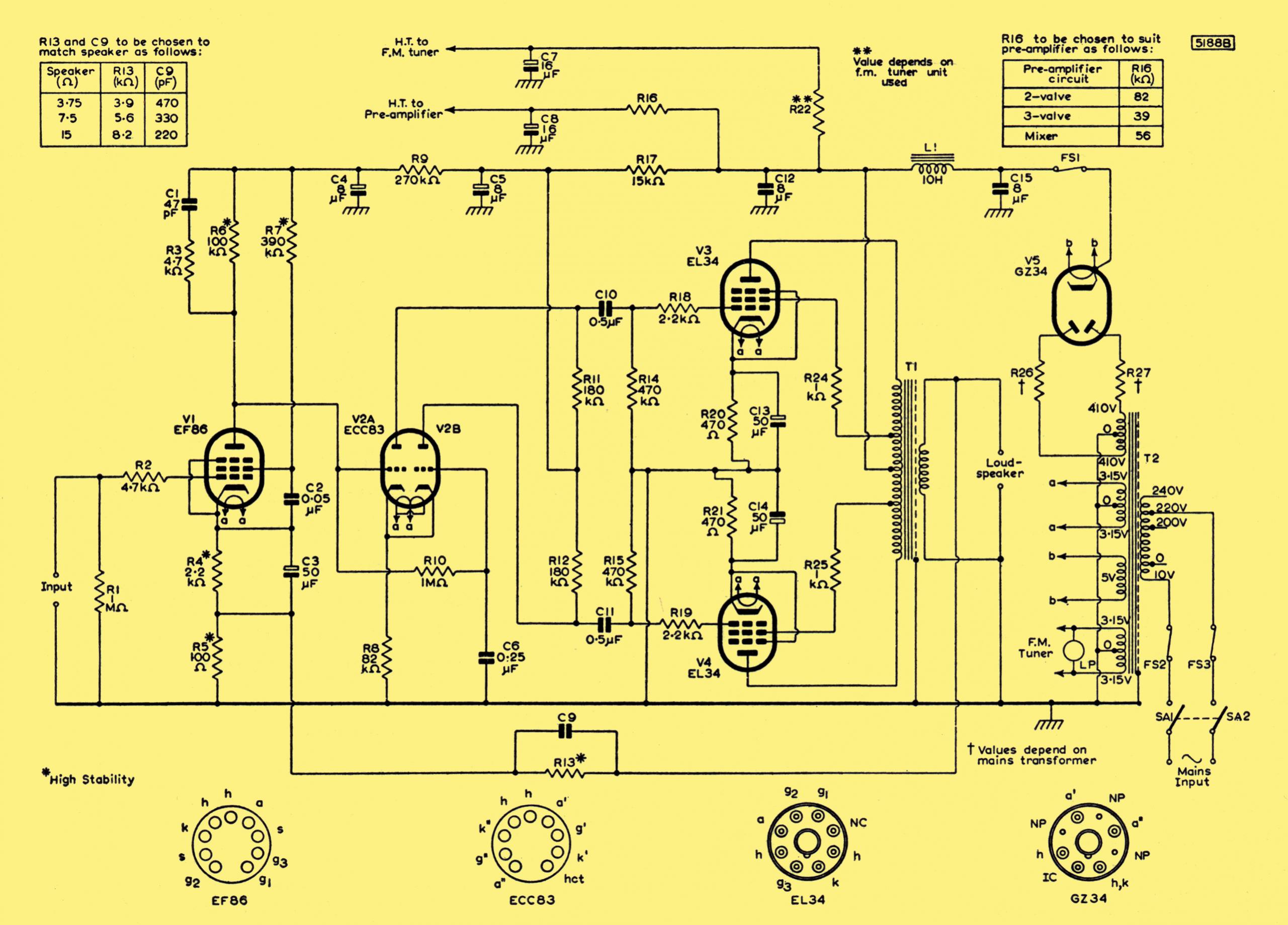

These are a DIY effort based on the Mullard 5-20 circuit.
You could sell the Acro and Partridge OTs off the chassis and replace them with something that matches and pocket a little money. IIRC, the Partridge OT is what was specified in the original 5-20 design.

The amp built with the Acrosound O/P trafo appears to use oil caps., in its PSU. Those things, unless they spring a physical leak, never go bad. OTOH, electrolytic caps. literally dry out over time and should, as a matter of routine, be replaced.
The amp built with the Partridge O/P trafo employs "can" caps., which are 'lytic. Clamp mounting "snap in" or other modern parts in the existing chassis openings is a convenient way to replace those old, dried out, 'lytics.
The 'lytics in SS equipment suffer from the same drying problem.

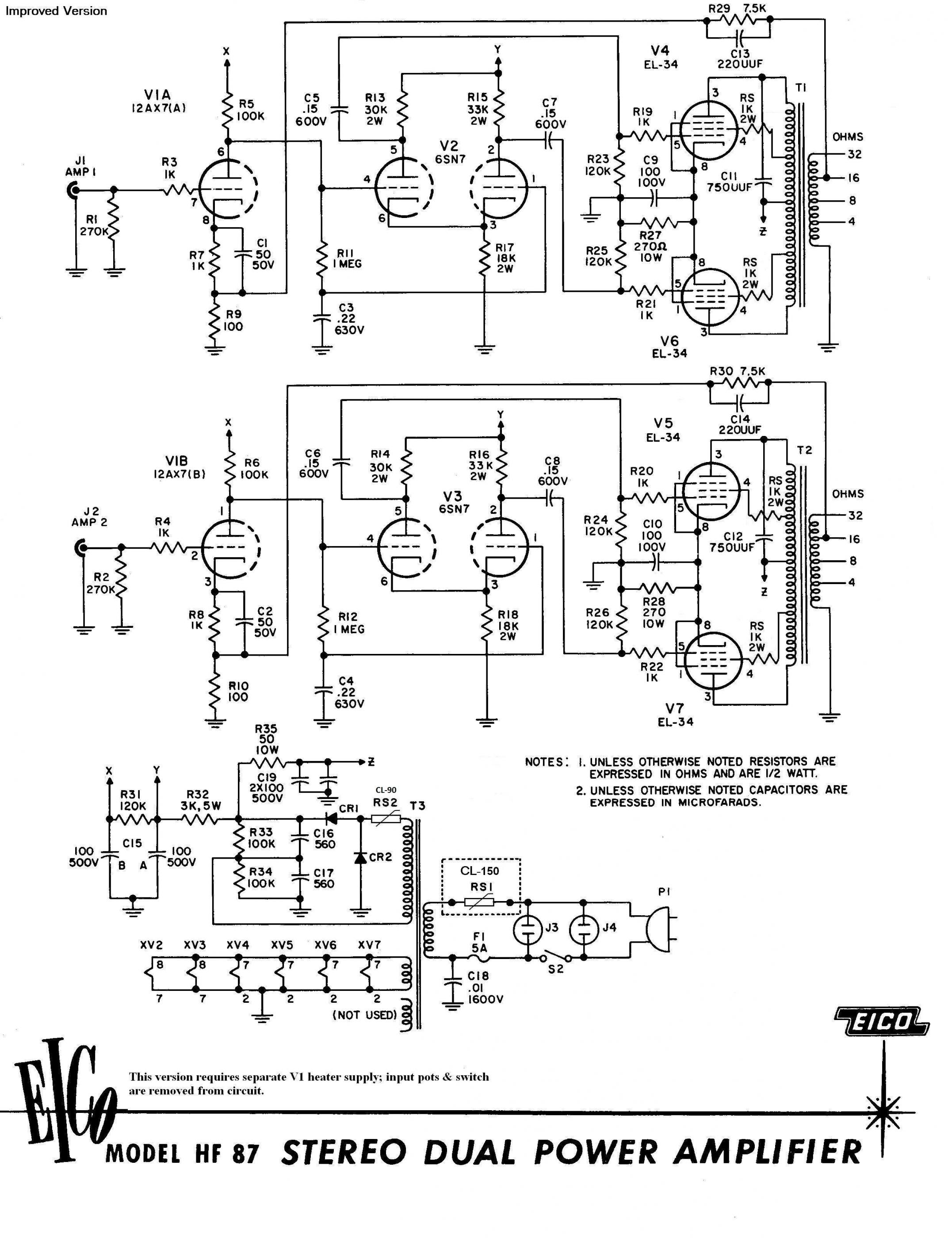

I've provided the schematic for the previously mentioned Mullard 5-20. I am also providing the schematic for EICO's HF-87, which employs Mullard style circuitry. The Noval 6CG7/6FQ7 and the Octal 6SN7 are electrically equivalent. FWIW, I'm guessing the circuitry present is a hybrid of what's present in the 5-20 and HF-87, with an EF86 voltage amplifier and a 6CG7 long tailed pair (LTP) phase splitter.
To this day Hammond manufactures the 278X power trafo. 😉 Old magnetics that are electrically intact hold and (sometimes) appreciate in value. I agree with the suggestion that the Acrosound and Partridge "singles", which are quite valuable, be sold to fund the acquisition of a "matching" pair of O/P trafos. For the Canadian OP, Hammond's 1650NA seems to be correct.
BTW, which rectifier type(s) is used?
