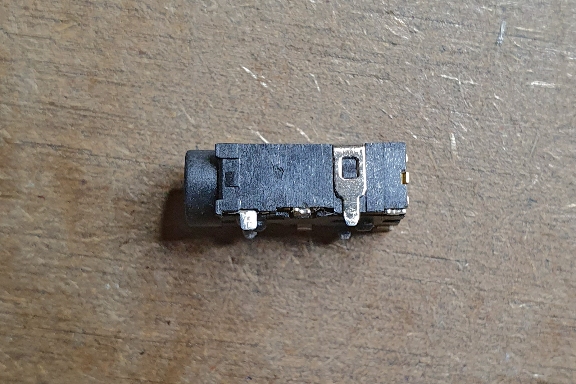

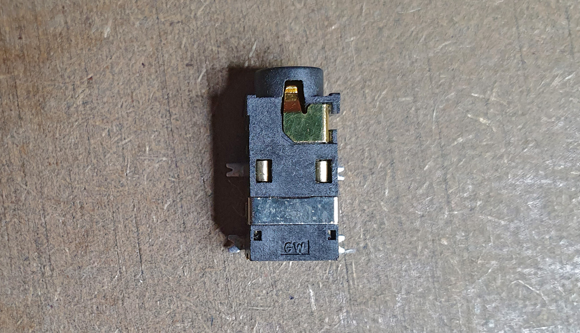

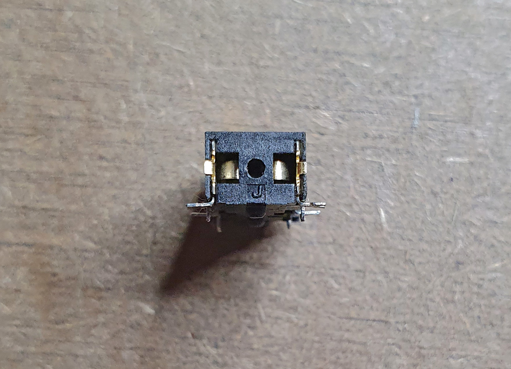

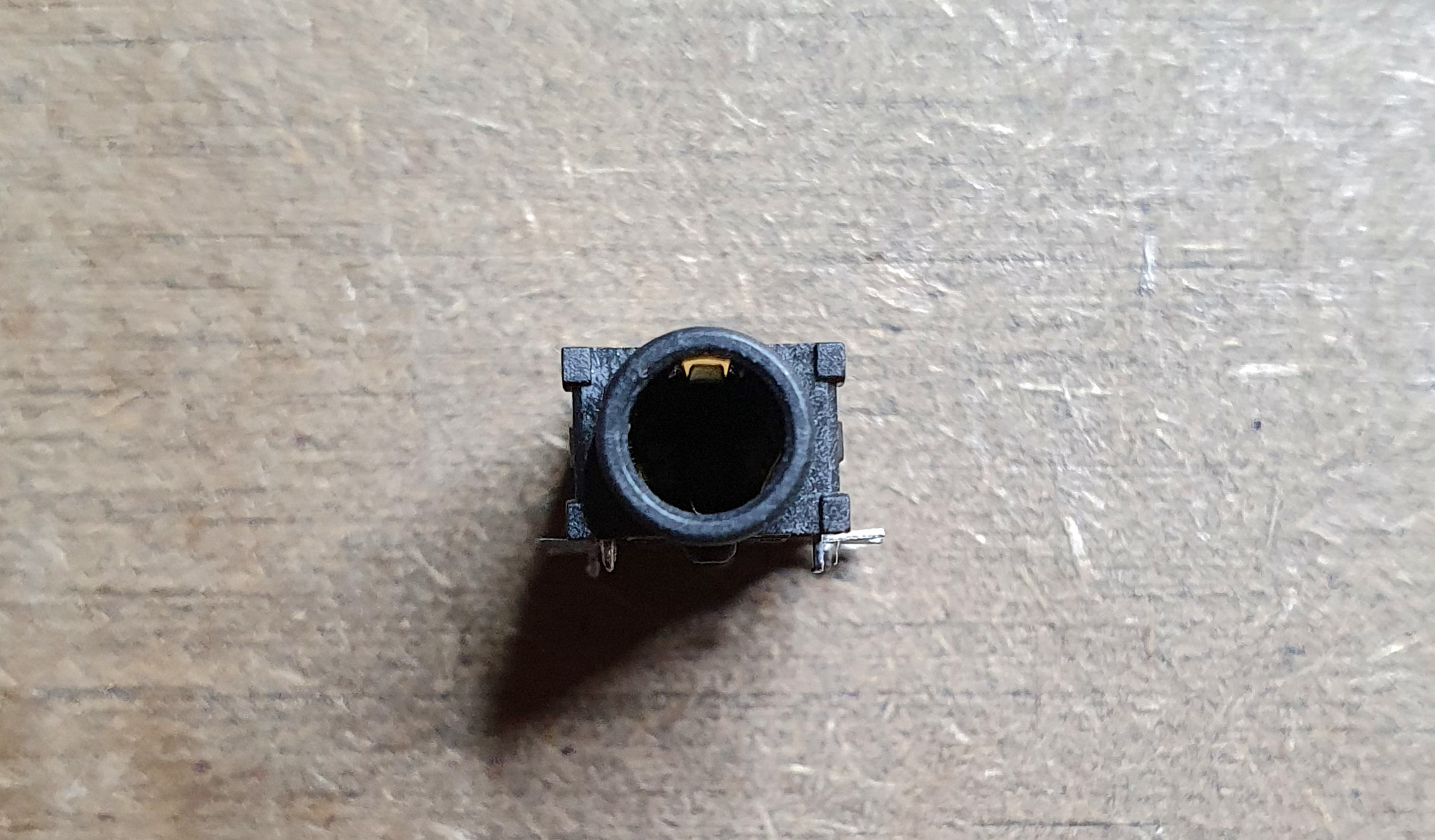

Anyone recognizes the model/manufacturer for this audio jack?
It's a 4 contacts-TRRS type, no switch. SMD (L/R contacts, i.e. T and R1) and TH mounting (ground/mic contacts, i.e. R2 and S). Also comes with extra mechanical support in the form of a silver metal band with TH mounting to board.
It's used in quite a few digital audio players (Fiio, Cayin etc.) but after rather extensive search (Mouser/DigiKey/Arrow/Farnell/LCSC/Aliexpress etc.) I was not able to identify it.
Eventually (actually just a few mins before writing this) I think I think I may have identified the manufacturer (G-Switch - 轻触开关-防水轻触开关-TYPE-C连接器-TYPE-C母座厂家-品赞电子) and I even found a connector listed on their website that resembles very closely the one in question (PJ-0275S00 - 3.5四极6PIN带铜套贴片镀金耳机插座_品赞电子), however not the exact one I am after. Nor was I able to see one for sale.
I guess I'll reach out to G-Switch and assuming they reply will find a way to source a replacement for the connector I am interested in, however I thought it does not hurt to ask a question here as well. Thanks

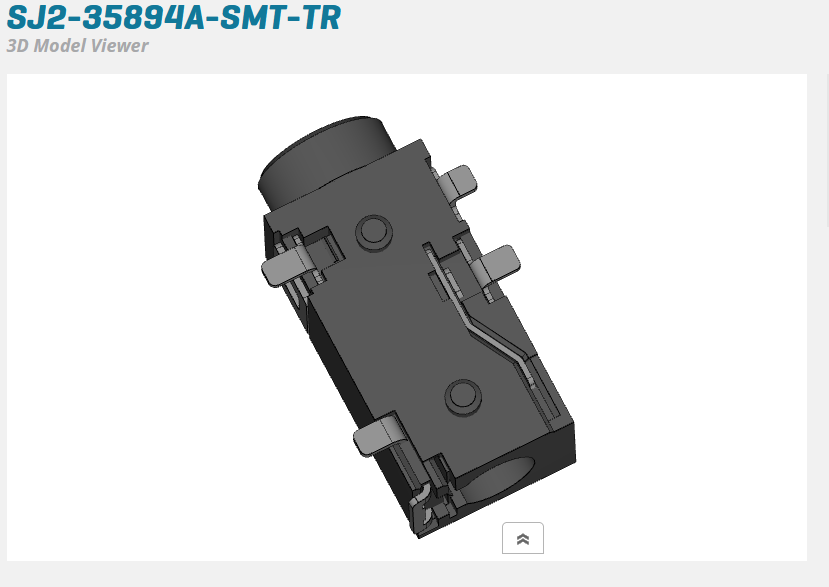

SJ2-35894A-SMT
Unfortunately pinout is not compatible, quite far as a matter of fact.
