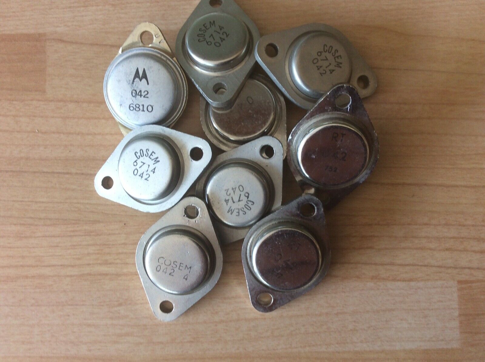

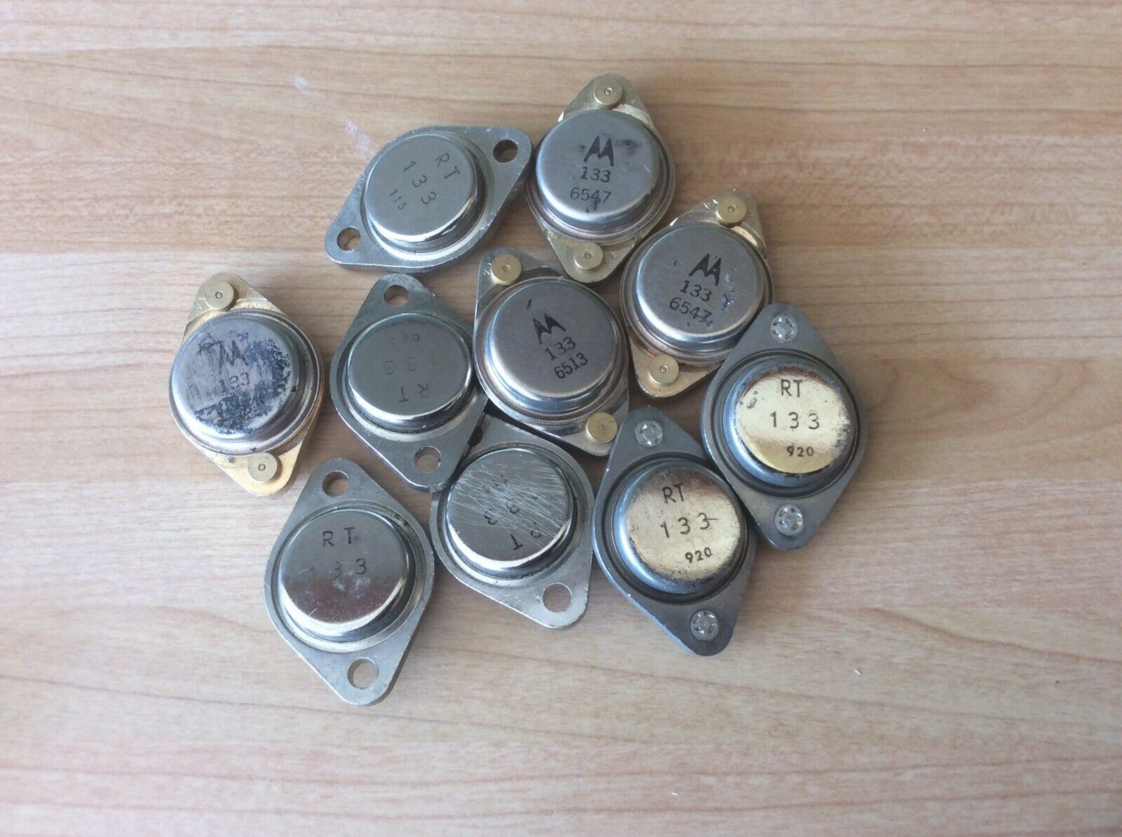

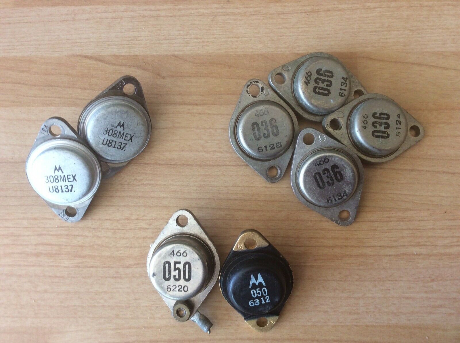

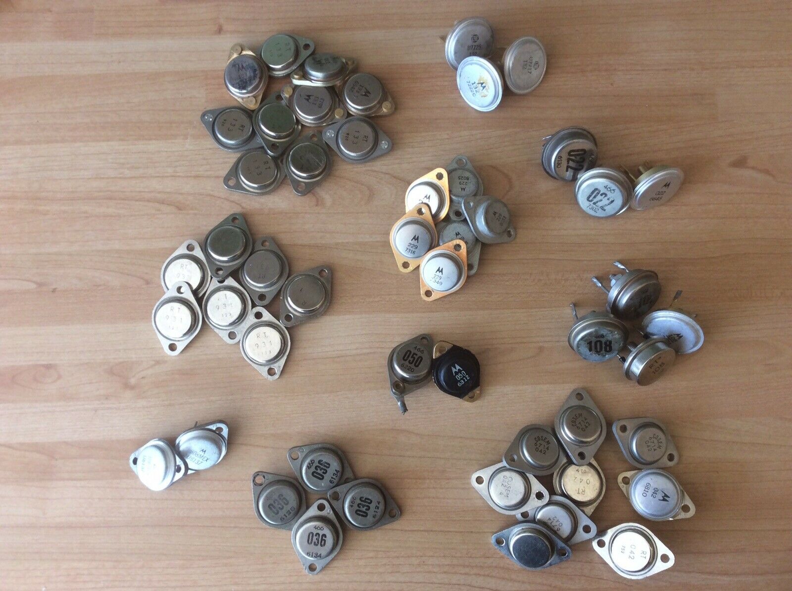

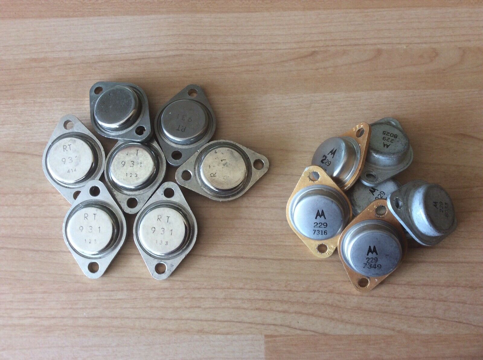

Help Identify These Transistors
I recently acquired a ot of transistors mainly TO3 case but also some "flying saucer" ones.
They have strange numbers, probably house codes.
Can anyone shed some light on what they are?
Thanks.
Andy

Start by measuring Vbe and Vcb to check/confirm they are Silicon or Germanium, polarity, and also diode check Vce to confirm they are not straight shorted.
Some might be bad, many (all?) look like "pulls".
Can´t even imagine who had all those stashed for so many years.

You can go vaguely by production date. After figuring out ge versus si, PNP vs NPN, what was selling in big numbers in 1973? 1975? The date code is right on there. That gives you an upper limit on current limit, Vce, intended use current. Before soa was invented, you used a power transistor at the current before the gain dropped down to 5 or 2. Mid sixties designers actually went down to gain 5 a lot.
You can test Vceo with a 30 v supply, or more, a 47k resistor and a microammeter. Ice 2 uA, you under the Vceo. Current= supplyvoltage/47k, you're over the Vceo.
Don't use 2 hands to probe or apply voltages over 24, current across your heart can stop it. No jewelry on hands wrists or neck.
