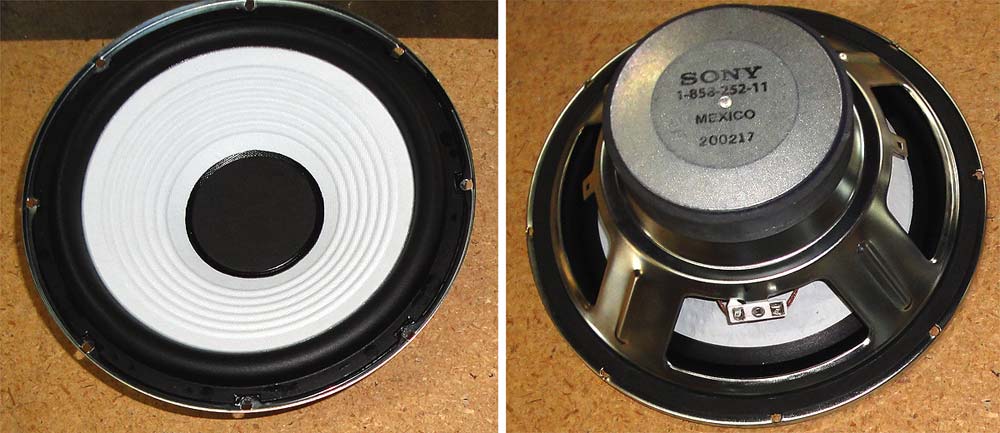

I am working on a deal and have bought some, but am not sure
what I'm buying, Please help if you can...What are these and
where were they used ?
10" woofer P/N 1-858-252-11 made in Mexico
8" woofer P/N 1-826-913-11 made in China
8" woofer P/N 1-826-950-11 made in Mexico
4" woofer P/N 1-826-366-31 made in Malaysia
Tweeters
P/N 1-826-110-21 made in Indonesia
P/N 1-826-692-11 made in China
If anyone knows anything about these please let me know

The 10" made in Mexico was used here in this mini system

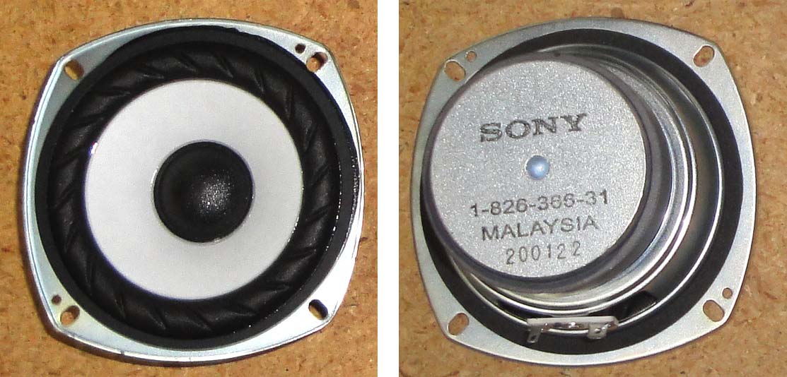

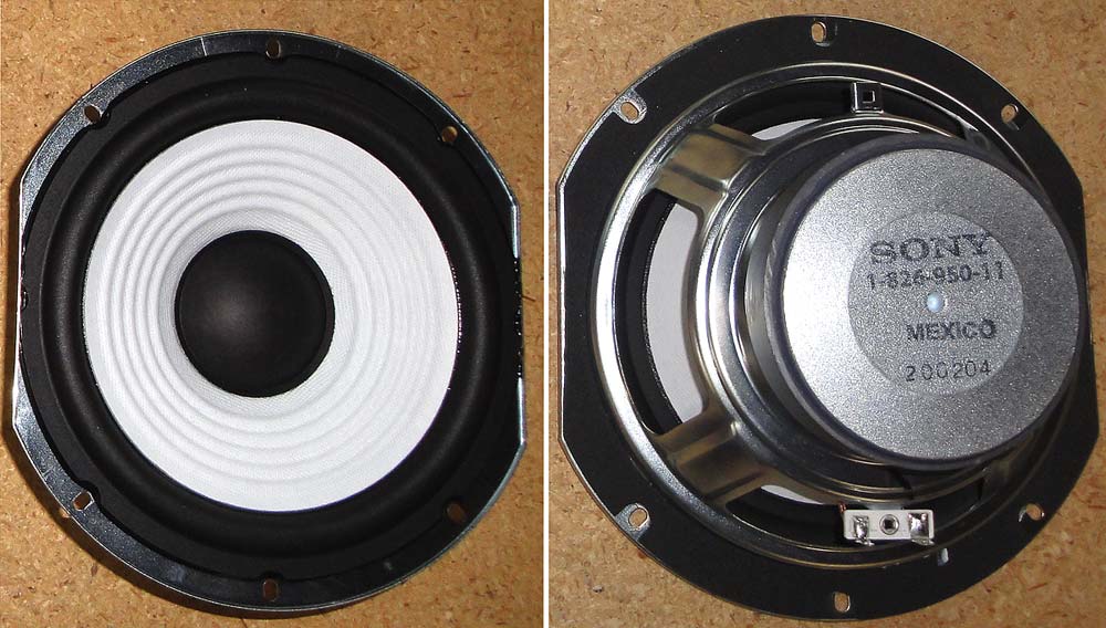

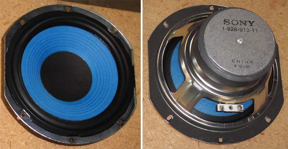

This seems to be the thread that is getting the most traffic, so i'll post pictures Steve sent me here. (the other thread will be erased -- this one should move to multiway? Or ApexJr?)
The woofers 1st. I can't say much about them, except that i think the blue one is very pretty. Constructionwise they resemble the new Mark Audio #6 and i like those. We'll need to see T/S to see what aps they fit into.
dave
Pictures are smallest to larger
dave

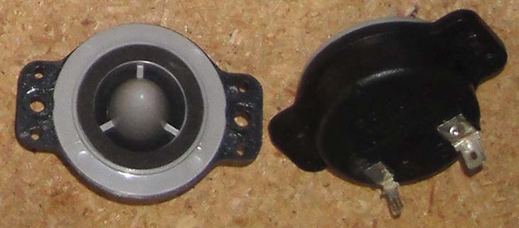

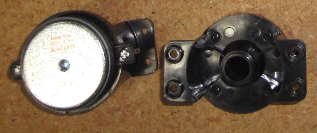

The tweeters & the mid.
The mid has a surround very similar to the Fostex eSigma series. Too bad it isn't a FR, i'd be checking them out.
The tweeters look to be a screw-on driver for a horn, and the other a "miniHorn" loaded piezo (or a neo) super-tweeter.
dave

I've Gotten my Hands on One of the 10"s
the Suspension is Quite Stiff,but it appears to have Decent Excursion and looks like it should be Loud in the Right Enclosure...handles my Cerwin Vega 150 Watt Plate Amp Pretty Well.
Unfortunately the Pole Piece is Not Vented...Makes the woofer pretty Noisy in Free Air,but that wont be noticed inside an Enclosure.
http://1.bp.blogspot.com/_-BLADXHipoQ/SpFd-oKb6AI/AAAAAAAAAHs/kRqvhhukv5U/s320/sony_htddw7500_2.jpg
Seems like the 10" as well as the 8"s and possibly the 4 Inchers come from this Sony 7.2 Muteki Surround Sound System.
