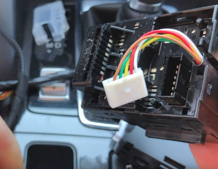

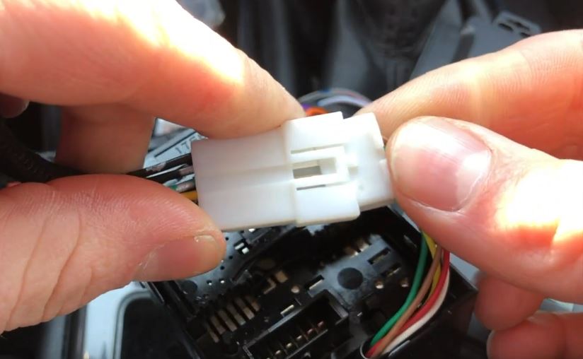

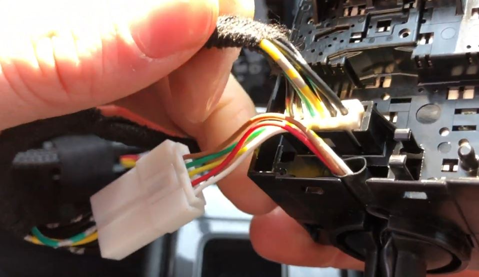

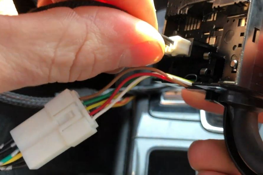

could you please help me identify the connector in the image? I know that it is a 6 pin connector (one row) but I cannot find any information
of how is it called and where to get similar (searched Mouser connector types with no luck...)
I'm looking for both male and female connectors of this type...

yes I'm looking for the exact connectors, they are not used for audio in my case (they are the the parking light/headlight switch connectors of a Mazda CX-5) but I thought that those are simply electrical connectors and maybe some member used such connectors before.
I'll keep looking for them thank you.

It's typically called a Molex connector, but there are a zillion varieties and manufacturers of them.
Actually, there's only one manufacturer of Molex connectors and that's Molex. But I suppose "Molex" has become a noun just as Kleenex has become synonymous with any sort of paper-based snot rag.
The connectors pictured look more like those made by JST (another major manufacturer of wire-to-board connectors). Amphenol is another manufacturer.
To find a mate for these, I would search for "connector" on Mouser and sort by pin pitch. It'll take some work comparing dimensions in the data sheets with what you have to find a mate but it should be possible.

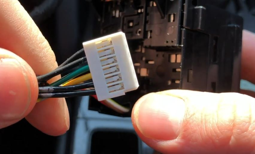

Yes, my wording was incorrect. They all are "crimped".
Well, I removed one wire from the connector housing and it looks like this (blurry photo but i cannot get closer and clearer than that):
