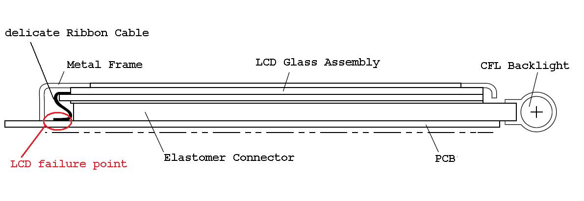

To revive this thread yet again, R128 gave good pointers. It is indeed the ribbon cable that makes poor connection on the circuit board and can be corrected by applying mild local heat and slight pressure. This is a very delicate job and I would not recommend to attempt it. Have joelfriend do the job for you.
But for those who can't resist to mess around with the display, be warned, this very very delicate work.
Here are the steps:
Carefully disconnect the data cable and backlight cable from the main board.
Remove the main board.
Remove the metal chassis then remove LCD display from plastic chassis.
Wearing gloves, carefully undo the tabs which hold the metal frame over the LCD glass assembly.
Be aware the delicate ribbon cable is on the opposite side of the LCD display with respect to the backlight.
Once the metal frame has been removed the LCD may be loose now, be sure there is no chance for dust or contamination to come between the elastomer connector and the LCD glass assembly. Be careful not to stress the ribbon cable.
Now carefully apply mild heat and mild pressure simultaneously to the area on the ribbon cable on the PCB at the locations needed.
Now reassemble LCD in reverse order and with some luck the dark horizontal lines are now functioning again.
Here are the steps:

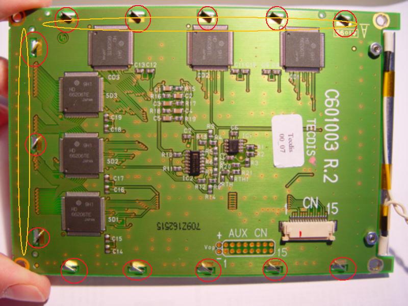

Fluke Scopemeter 196 B/W Screen Repair w/better Grammer
Disclaimer: If you try this and it does not work… It is not my fault….
Last night I said what the heck and jumped in to see if I could fix my Fluke 196 Scopemeter’s B/W screen...
This is how I did it...
First
Be clean keep fingers off all plastic and glass you have to look through… not heeding this will cause you to redo things a little care would have prevented..
Remove the battery when working with your scope.
There are 12 screws torx/flat blade... Two for the top cover, two for the bottom cover, two to split the case, 2 holding the scope frame to the front half of the scope case (shell) and 4 holding the display in. Not bad.
Ok so the Horizontal lines of the display are connected by the infamous “glued” ribbon cable and the vertical lines are connected to an elastomeric connector.
Do not disconnect any ribbon cables you want to be able to turn on the meter apart to test your work.
Flip the main chassis so that the display is sitting in its half of the case on the left side that puts the main board with the rest of the scope sitting on the right side.
I used a mouse pad placed over the main board frame so at a later time I can flip the display on the main board and power up the meter while apart.
I have read in the past that the elastomeric connector for an LCD is not alignment critical… that is not true…. think about how they work it will come up later.
On the back of the display there are 13 twist tabs that hold a glass and metal frame over the display providing the alignment and pressure needed to keep everything connected….
Carefully align the twist tabs to their respective slots… then supporting the frame flip the display board over onto the mouse pad and gently lift up on the frame… This is where you need to keep things clean (don’t touch anything that you can see through or make sure you go back with a micro fiber cloth and clean your finger prints off).
Inside the frame there are two very thin and possibly fragile strips of isolating rubber these are located inside the metal frame… watch out for them they may fall out, if they do I used an xacto blade to maneuver them into their original position… (I did not want to touch them)….
I started off with missing horizontal lines in my display (7 to be exact).. Researching this you may have read about people using glue guns without glue sticks to heat the ribbon cable, or soldering irons…
The heat source I chose was a small travel iron. With the tabbed frame off the ribbon cable is accessible at both the display and daughter board connection points. The travel iron inspired me because the temperature can be controlled, the heating surface is flat and you can carefully control the amount of pressure you exert….
I set the iron at its highest heat setting waited till it reached temperature and carefully ironed the ribbon cable… I ironed and cooled the cable 4 times over about 20 seconds….
Next I tested my work before I put it all together. I placed the tabed frame over the display, I plugged in the battery and carefully pushed the on button on the scope (don’t press the on button too hard because it is held in place with the pressure of the main board frame…).
Now press on the frame to see if the horizontal lines are gone.. You are simulating all those twist tabs… so think about how much pressure they may exert and remember the back end of the display is being pressed against the frame of the main board (thus the soft rubber mouse pad suggested above) so don’t overdo it…
If everything went well and you press the frame in a way that that simulates the tabs you will see the display the display clean on black bars…
If not try more careful ironing…
I did mention that I started out with horizontal lines… at this point I pressed the frame down and could see that I fixed the horizontal lines but in the middle of the screen I now had a vertical line… aaaghh… The vertical lines of the display are controlled by the elastomeric connector…
What I did now was probably not necessary and probably dangerous but I took a Q-tip dipped it in some good grade alcohol and wiped the elastomeric connector and the daughter board lands once (thinking it was somehow dirty).
What I think was really happening was I had not pushed the display over far enough to make proper alignment…
Next I pushed the display over toward the ribbon cable (you just ironed)… after doing this I once again placed the LCD frame over the display and pressed down on it in a way to simulate the pressure exerted by the twist tabs and verified everything was working and that the vertical line had disappeared. They did..
