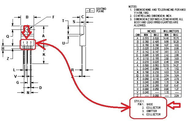

Hi. I thought it'd be easy to find pics of the pinouts for these two types of transistor but the info I can find is, to me at least vague but probaby more than fine for the experienced tech savvy builder. Am I correct that these :-
MJE15030G : from front view - is B C E with the tab as C
MPS-U07 : from front view - is E B C with the tab as C

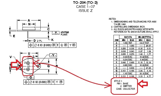

MJ15003G / MJE15031G : viewed from pinout side : ??? (no idea)

Well, you are right about the MJ15003. the datasheet I have doesn't explain what 1,2,3 are. If you look at the TO3 cans from the leg side (bottom) from the long end, the base is on the left. the flat bottom is always the colletor. I don't have the datasheets on the other 2 and don't want them, but I would say "pin end, tab down" when describing how to look at them. Most plastic with heat sink tab devices are B,C,E but some early ones were E,B,C. I was hoping when I bought my recent stuff that they had solved the collector tab problem requiring an insulator, since most datasheets don't discusses this connection, but apparently not.

For both the MJ15003 and the MJE15030 the pinout information is buried in the fine-print of the package drawing, on the last page of the datasheet.Well, you are right about the MJ15003. the datasheet I have doesn't explain what 1,2,3 are . . .

And if memory serves me, if you look at those MPSU types, there is a tiny little E B C stamped into the metal tab. The letters are over the pin that corresponds.
Every bipolar TO3 I have ever seen has the same pinout, and every bipolar TO220 I have ever seen has the same pinout
The difference between a TO202 EBC and a TO220 BCE is not obvious to us amateurs out here working from catalogs and stock shelves of local resellers. I had replaced dynakit TO5 EBC stuff with NTE49 and 50 which were EBC, and was very perplexed when I later got ahold of a TO220 BCE. Now we have the internet, but guessing the package from the dimensions is still requires some skill, particularly on exploded or rusted or house number stuff.every bipolar TO220 I have ever seen has the same pinout
Well yes, if you don;t know what package you have, you can;t rely on a listing of pinouts. I can;t for the life of me never remember the pinout of the TO92 BC series, like BC550, but I myself never had trouble differentiating TO220 and TO202. But once you can identify TO220, you can feel secure in knowing that all of them are pinned out the same for bipolars.
