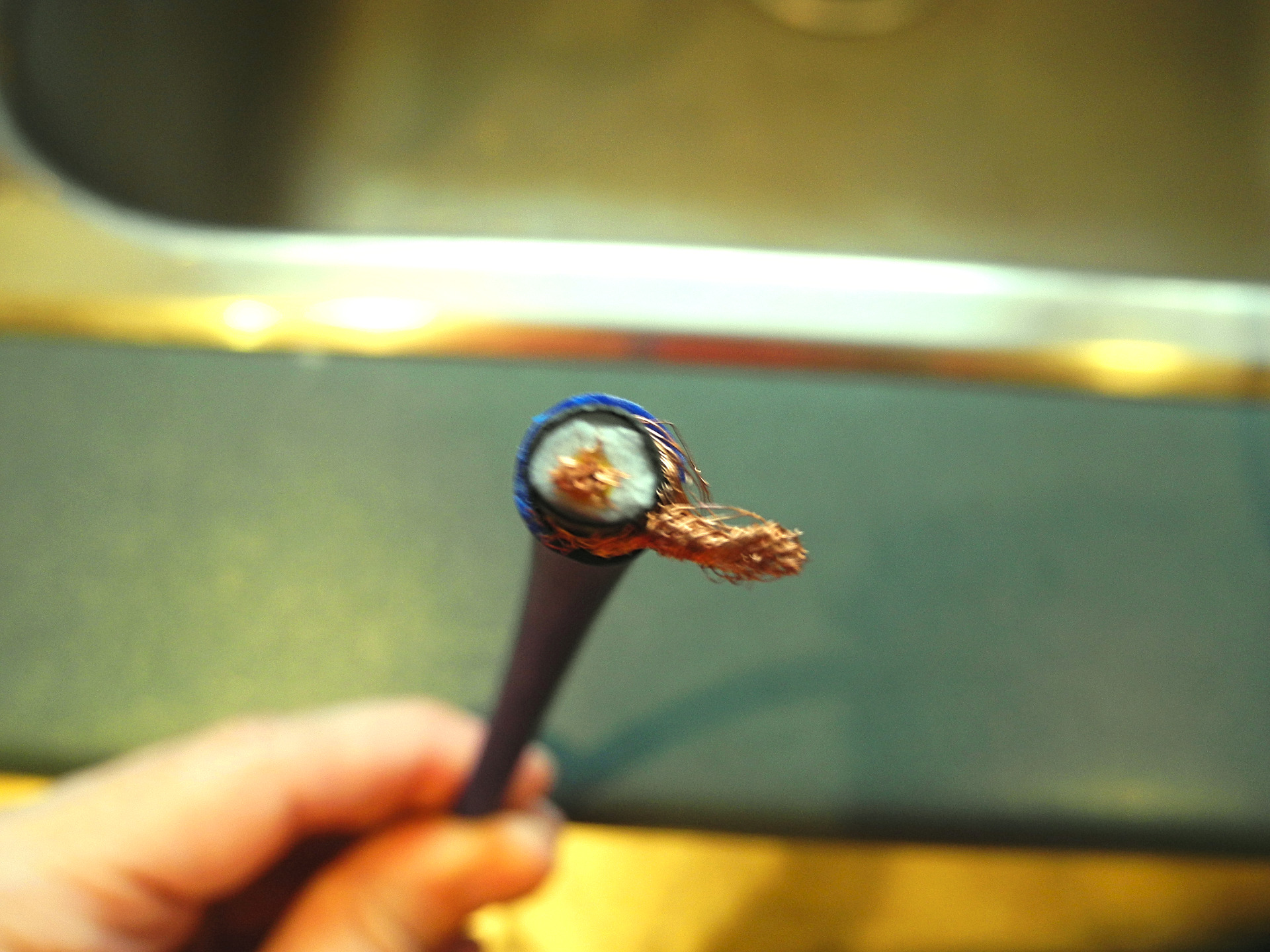

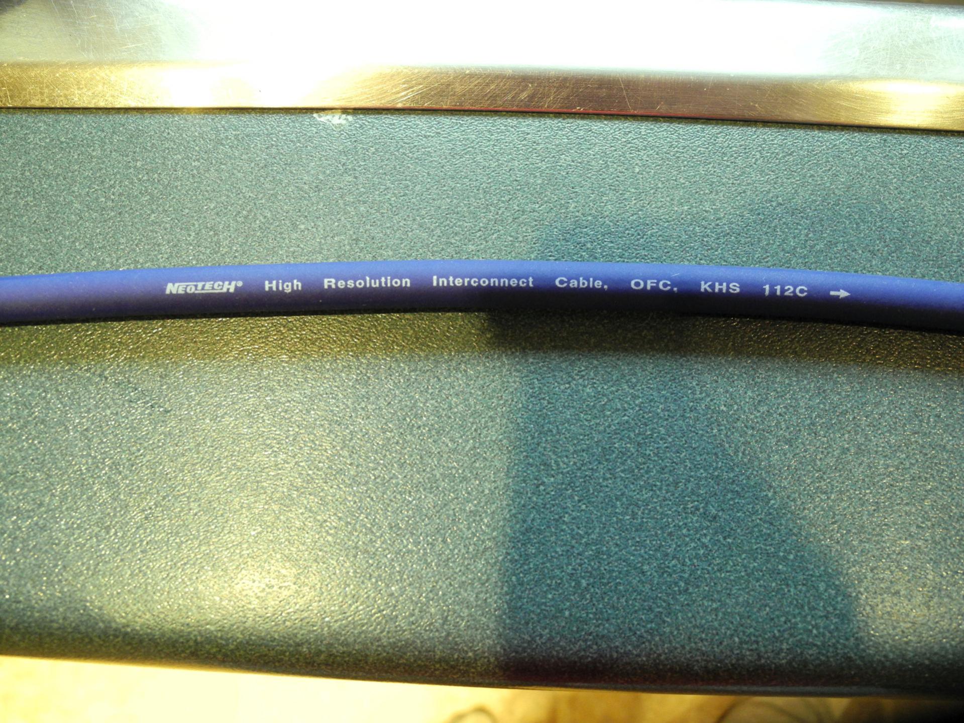

I had about 8 feet of this Neotech cable given to me. I know it says "Interconnect" on it, but I was just wondering how good quality this is compared with minimum standards of quality...eg..does it have double-braided shield + foil shield. Also, I don't know what impedance it is.
Can anyone ID this and tell me how well it will perform as an interconnect?

It appears to be designed to extract money from audio enthusiasts. However, the electrical design looks solid enough so it probably is good enough for use as an unbalanced analogue audio interconnect. If you want to use it for digital audio then you need to find out whether it is 75 ohm characteristic impedance; I suspect not, because it might say so on the jacket if it was.

Is it possible for me to tell if both types of shielding are included in this cable just by looking at it?

KHS-112C: ”Double shielded (black conducting PVC foil and OFC braid) OFC mono interconnect cable in dark blue PVC jacket. OD: 7 mm. Cross-section of the internal wire is 0,43 mm2. R: 0,042 Ohm/m, C: 62,59 pF/m, H: 0,451 uH/m/l kHz, Z: 72,33 Ohm. Ideal for video signal transmission.”
