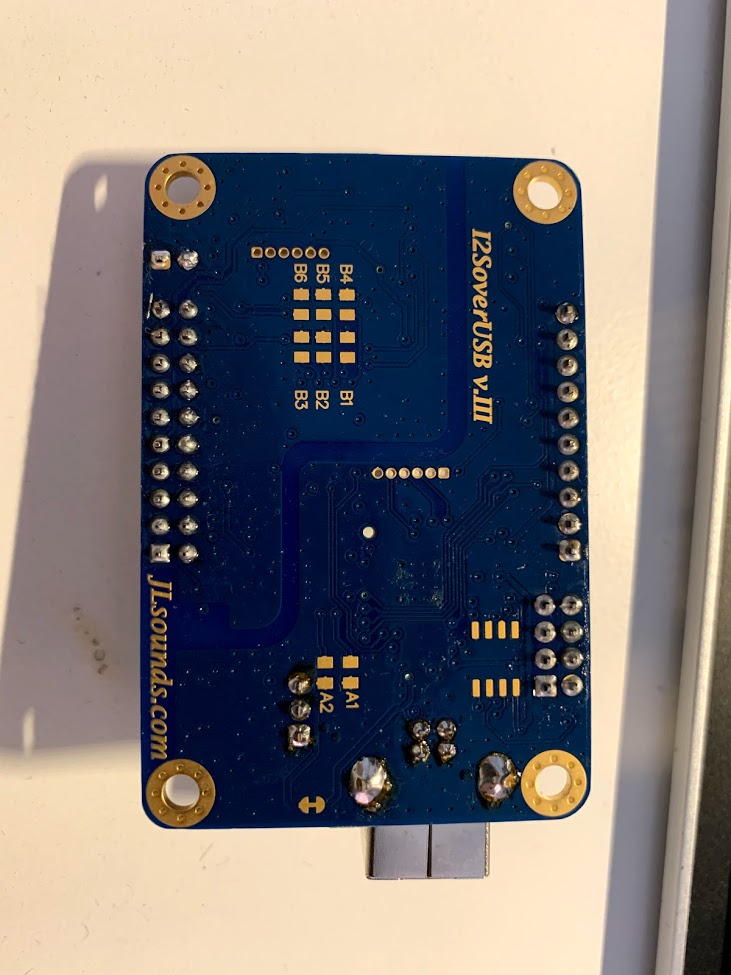

Anybody have experience with I2SoverUSB MK3 card and AD1865DAC? I tried to setup according to the user manual,
http://jlsounds.com/uploads/I2SoverUSB v.III.pdf
(J3 jumper closed, H1.1 connect H1.3 with 4.7k resistor), then connect the board to the DAC but no sound.
I checked the H3.9, H3.11, H3.13 H3.15 with my scope, I see the square signals, so the outputs are working, but maybe the data format not good...
What is MCLK_2/4 or MCLK_2/2 options?

Guys, I realized, there are a few smd jumper on the bottom side of the PCB where must solder 0R resistor, but according to the user manual it should B1-B5 and my PCB has B1-B6.
Anybody have this new version?

yes, you can see at the first post there are a jumper on the J3 position, and the resistor between H1.1 and H1.3, according to the manual.
I just want to figure out why not working with my DAC. B1-B5 and B1-B6 is a difference between the manual, and the current version of the PCB.
...B1-B5 and B1-B6 is a difference between the manual, and the current version of the PCB.
True, but B6 appears to be for future expansion. If still concerned about it there is contact information on the JL Sounds website so you can ask them directly (email: info@jlsounds.com). If can take a few days for them to respond IME.

1.) If I see correctly the USB part powered from USB bus.
Is source driver "see" the Jlsounds?
2.) Are you tried it with fixed sample rate and bit depth (for example 44k1, 18 bit)?
3.) Are you sure, that galvanic isolation part GND connected to DAC GND?
Now it's working.
I don't know what happened, I disconnected from my DAC, I removed the board from the enclosure to check with my scope again. I soldered the 4.7k resistor directly to the back of the PCB. Maybe the resistor was wrong, or the contact was wrong I don't know, it is working now.
