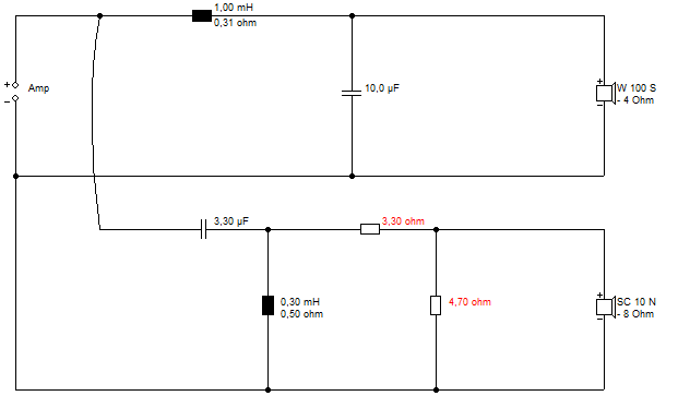

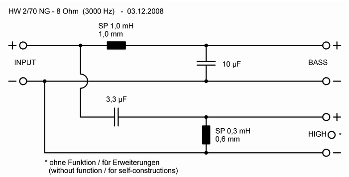

Here's an off-the-shelf 8 ohm 3kHz filter:
HW 2/70 NG - 8 Ohm
You seem to have a 4ohm reflex 4" driver (Qts=0.3?) and a 8 ohm tweeter. I'd guess you need a small box between 5-10 Litres. It won't be dissimilar to this Troels Gravesen project: Eekels' Mini
I just ran that 8 ohm Visaton filter past Visaton Boxsim with the 4 ohm W100S and it all worked quite well. The tweeter attenuator is the crucial adjust. You want to keep it around 6-9 ohms load to the filter.

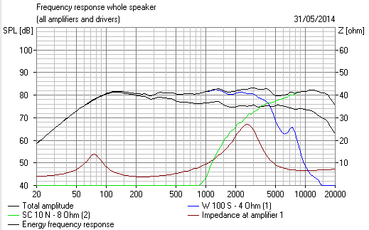

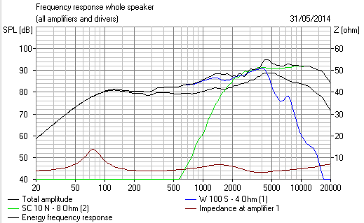

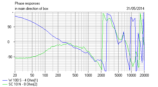

I always try to get a feel for a crossover and drivers with some rough and ready modelling. coryvirtue, your first effort is pretty disastrous, if you don't mind me saying so. You knew that. Here's something like what you are hearing now. 🙂
I modelled this as a 12cm wide standmounter cabinet which seemed to work. The HW 2/70 NG - 8 Ohm filter seemed to give something closer to a tolerable speaker and gives a point of departure for this project.
This is rough and ready, but what I'm getting here suggests a 1.5mH bafflestep coil might be better to get that midbass slope down. Or 1.2mH coil and a 10W 2.2R wirewound in the bass shunt arm. I think you'll need to experiment, because I can't read your Le woofer inductance which affects this.
Your tweeter is a high 95dB efficiency too, I used a 90dB jobbie. So the attenuator will need to do more too. A third order tweeter wasn't so nice on phase. Not that anybody, except me, is ever interested in THAT. 😀
