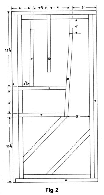

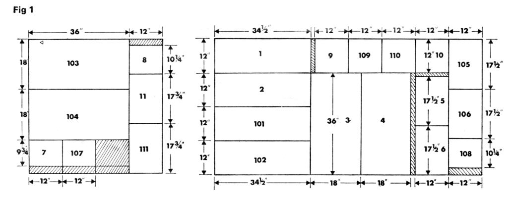

I hope someone who has built Chris Rogers' Transmission Line Monitors from the August 1975 Hi-Fi Answers notes can help me here. I am trying to get MDF cut at a timber merchants but am not 100% certain that I entirely understand the dimensions.
Based on Figure 1 (LINK) I can see that the top (5) and bottom (6) fit inside the sides (3 & 4) and that the front and back (1 & 2) fit inside the resulting box. What I don't understand is why the top and bottom are half an inch less deep than the sides, surely they too should be 18 inches deep?
Figure 2 (LINK) is equally confusing. What is going on with the baffle board, it seems to be "notched" at the top and bottom panels but this isn't mentioned anywhere in the text. The various dimensions at the top of the cabinet add up to 18" assuming that the port panels (9, 10 & 11) are ¾" thick but I am somewhat confused by the exact positioning of the port panels. Having spent time trying to understand Figure 2 I get the impression that the depth of the B139 "duct" goes from 5" (bottom of 11) to 4¼" (top of 11) to 4" (top of 11 & 10) to something undefined (bottom of 10 & 11) to something else undefined (bottom of 10 & 9) to 2¾" (top of 9 & 10) to 3¼" (top of 9 & rear of baffle) to 3" (bottom of 9 & rear of baffle)
i.e. 5" => 4¼" => 4" => ? => ? => 2¾" => 3¼" => 3"
This despite the comment in the middle column of page 1 of the notes that: "The duct starts with an area of 66 sq.in. at the drive end and is reduced by 50% to finish at 30 sq. in. at the duct mouth."
Does it actually matter that the duct doesn't consistently reduce in size? Would it cause a problem if panel 9 was vertical, making the duct the same size for the whole length of the final inverted "U" section?

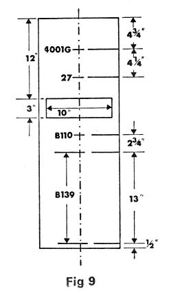

Figure 9 (LINK) also appears to be missing a dimension or two.
I need to convert all these dimensions into metric and in addition I aim to use 25 mm MDF rather than 18 mm (¾") for the external panels.
If anyone has built a pair of these speakers I would greatly appreciate any clarification, I would rather specify the cuts accurately first time around!

It appears that the joint of the front/bottom panel is meant to be
like the picture shows. Missing 1/2 " is routered out of the baffle.
The figure 2 issue is because the whole picture is rotated about
0,5 deg counter clockwise. And no, I have not built these.

I don't think that the front baffle is routered. Page 1 of the article notes "Obviously you can't get four 1 foot pieces from a 4 feet board but the thickness of the cuts allows for a slight clearance around the fronts and backs . . . Without this the panel fits tight and no one wants to have to bang into place panels with expensive drive units mounted on them!".It appears that the joint of the front/bottom panel is meant to be

Having said that, figure 1 does show the top and bottom (5 & 6) as being ½" less deep than the sides (3 & 4) but then again, the front and back (1 & 2) are the same height, 1½" less than the sides, presumably to allow for the ¾" thickness of the top and bottom!
I have now come up with the following dimensions:
From 25 mm MDF:
4 off 875 x 300 (front & rear - 5 mm undersized all round)
4 off 930 x 470 (sides)
4 off 305 x 470 (top & bottom)
From 18 mm MDF:
I will probably position the front port panel vertically.4 off 305 x 305 (front two port panels)
2 off 250 x 305 (B110 box base)
2 off 260 x 305 (B110 box top)
2 off 450 x 305 (B110 box rear and rear port panel)
