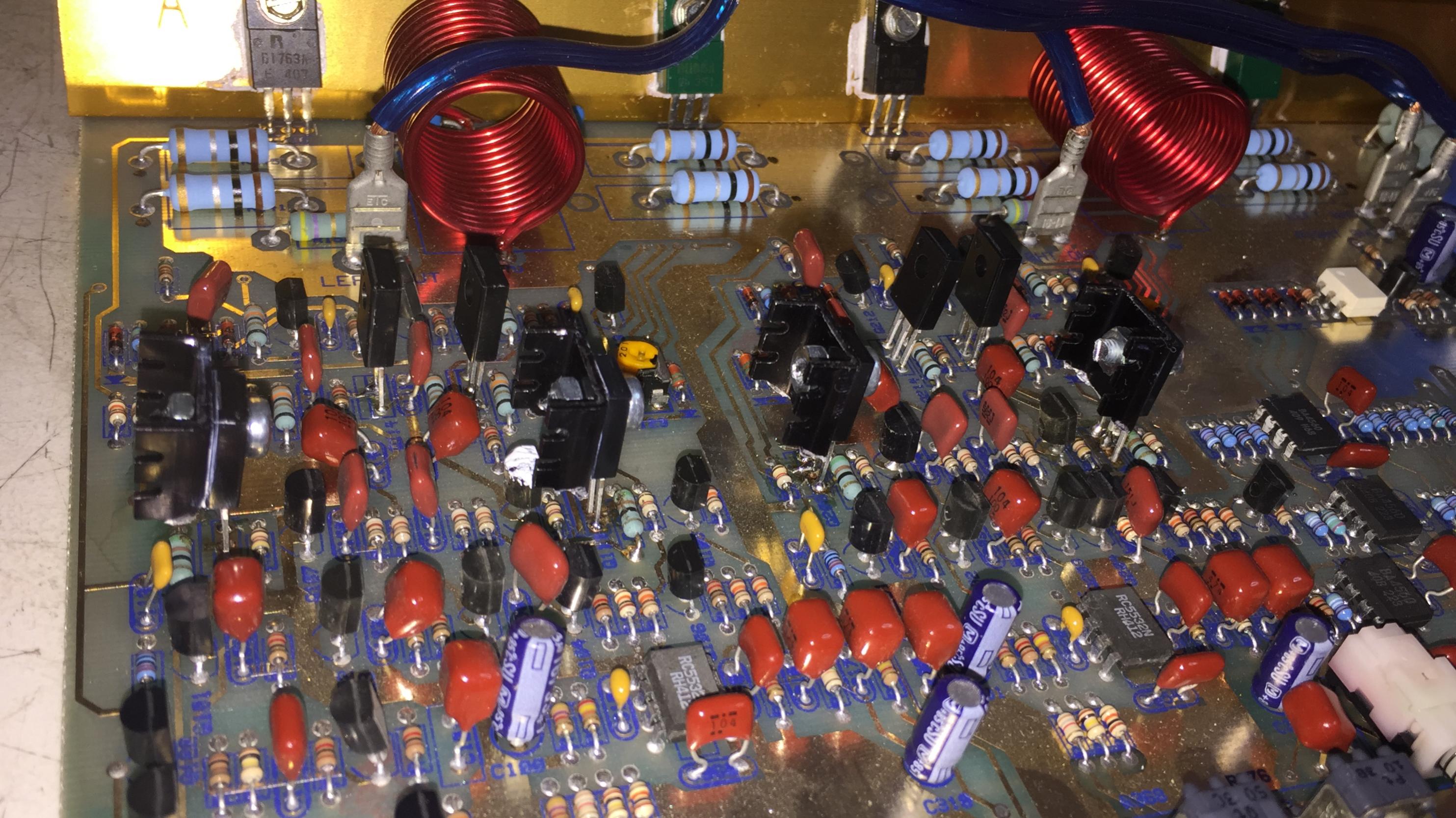

Hello, I have a Phoenix gold m100 that has 1 channel that sounds low and with a lot of distortion.
I found one driver transistor 2sc3423 with a leg broken.
2sa1360 and 2sc3423 aren't available, can you tell me a good replacement?
Ksa1220 and ksc2690 works fine.
Amp is ok but I note that 4 transistors are very hot, it's arrive at 105 degrees within 5 minutes.
In original amp these transistors has an heatsink. In this amp there is no heatsink but transistors are replaced.
Now I put an heatsink in the four drivers when i replaced its but Temperature is too high, 100-105 degrees

Does the other channel drivers run as hot?

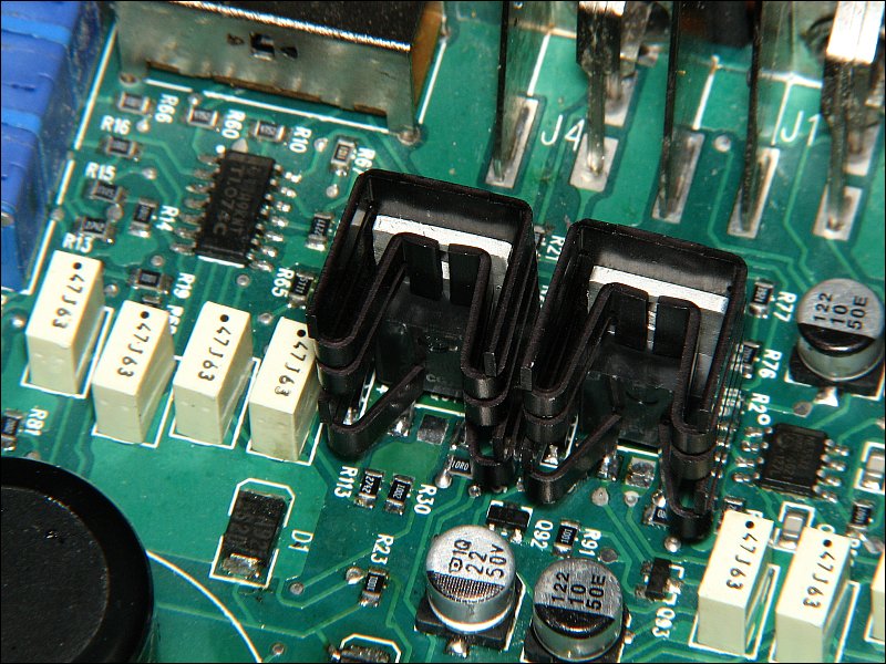

The MJE15030/15031 are also generally good subs but have reversed pin configuration so have to be installed facing the other direction. They have larger heatsinks available. The ones used in the attached photo are pretty good.
I use only one heatsink, I have to try with 2 back to back.
Mje15030-15031 are to220, I use for this amp ksa1220-ksc2690

Drivers become hot in both channels

The TO-220 pin spacing is the same. They drop into the locations without any mods, in most situations. If you can get the smaller transistors cool enough, there is no need to try the larger ones.
Do you see any corrosion around any of the capacitors? Sometimes darkening can be seen around the solder pads (especially those with thermal reliefs on the pads).
No corrosion around capacitors.
I change input filter capacitors and the 4 100uf/25 volts near the big resistors that give power to opamps.
Resistors are changed in an old repair and the zone near the resistors is dark
What do you think if I put a small fan inside the amp?
My idea is a hole with a fan in a side of amp but I have to sell it and I cannot modify the chassis.
A 3x3 fan inside should move air but is hot air when amp is on
