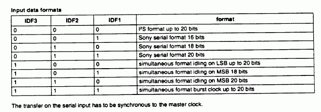

They both uses Philips SAA7350, can someone tell me whether the I2S inside is oversampled (2Fs or 4Fs) or non-oversampled (Fs)?

The SAA7350 is a dac itself but is often used in conjunction with the TDA1547 where it functions as a bitstream converter. It can also be used with an external digital filter. To find raw I2S data you may have to look further back. The table below shows the different input formats the SAA7350 will accept. The IDF pins determine the format and they are
IDF3 pin3, IDF2 pin4 & IDF1 pin5
