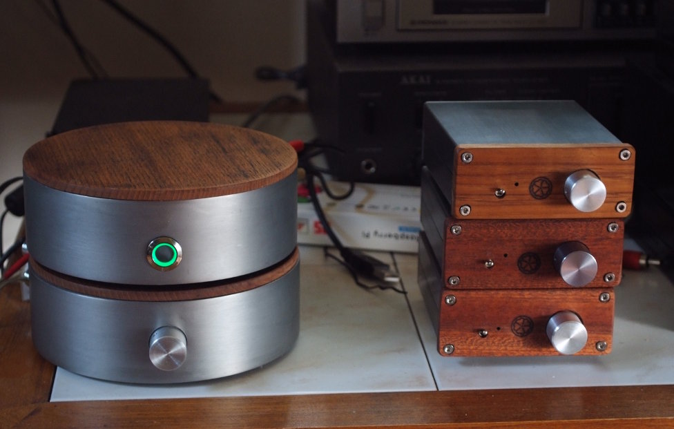

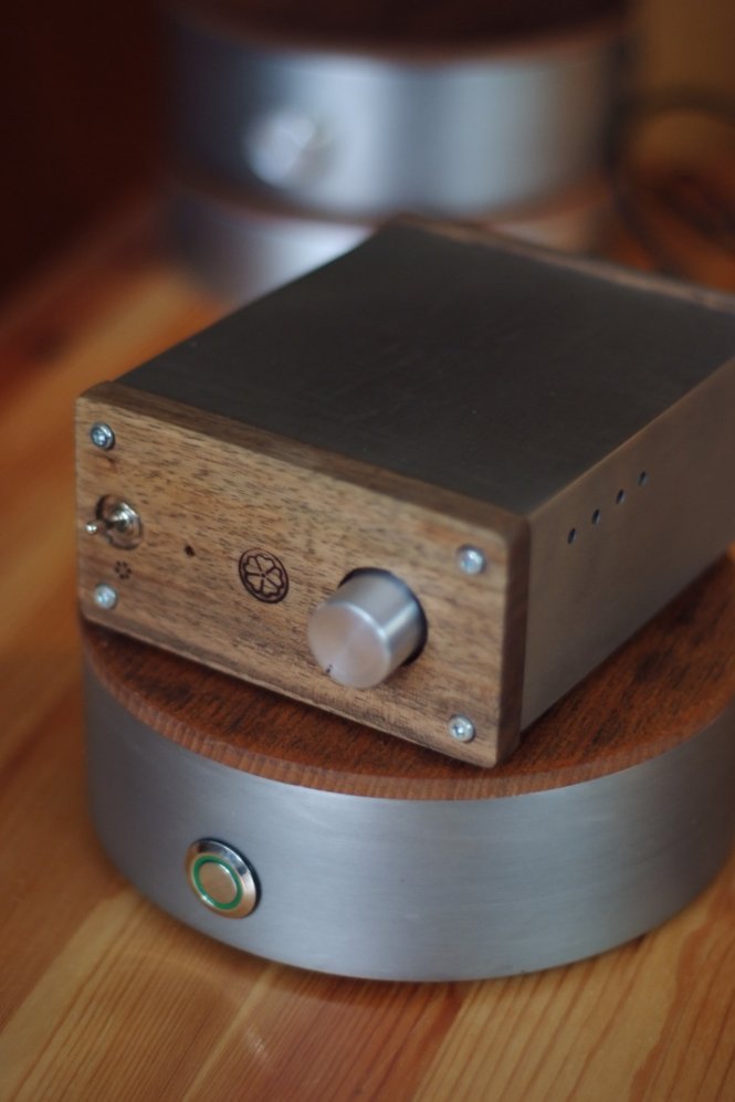

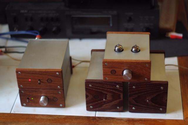

I also make enclosures for amps (and Raspberry Pi based servers), but I went for aluminium+wood combo... see attached photos, maybe that could also give you some ideas.

den_hr those boxes look great! I love the exposed screws on the front. Also well spotted on the grovemade site! I think I will get in touch with doctormord as I see he's based in Germany (I'm currently living in the Netherlands) so postage would be cheaper than gmarsh. Otherwise I am definitely up for trying my hand with the Breeze 2.0 - I guess I can find a thread regarding mods on here! (there seems to be an answer to every question the more I look!) I will definitely post some updates when I'm further down the line - I'd love to share with you guys what I manage to make! 🙂
