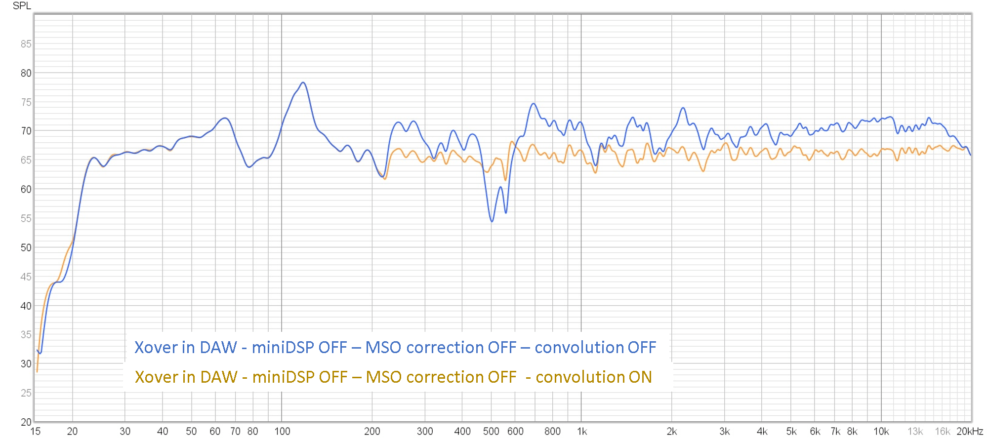

This is because MSO has only a limited range of optimization (max 300 Hz) and I want to optimize the full spectrum up to 20 kHz. The convolution is less precise than the MSO correction because it is based on the optimization on one spectrum (be it an average or not) whereas MSO calculates the best parameter sets fitting several listening positions.

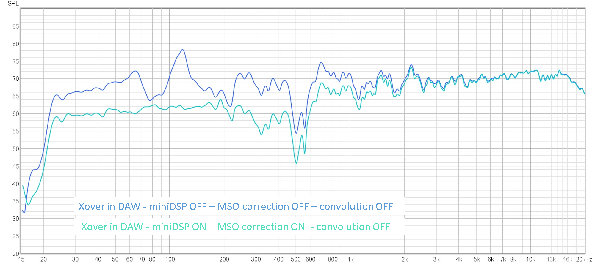

Below you can see how each work nicely, on their own:

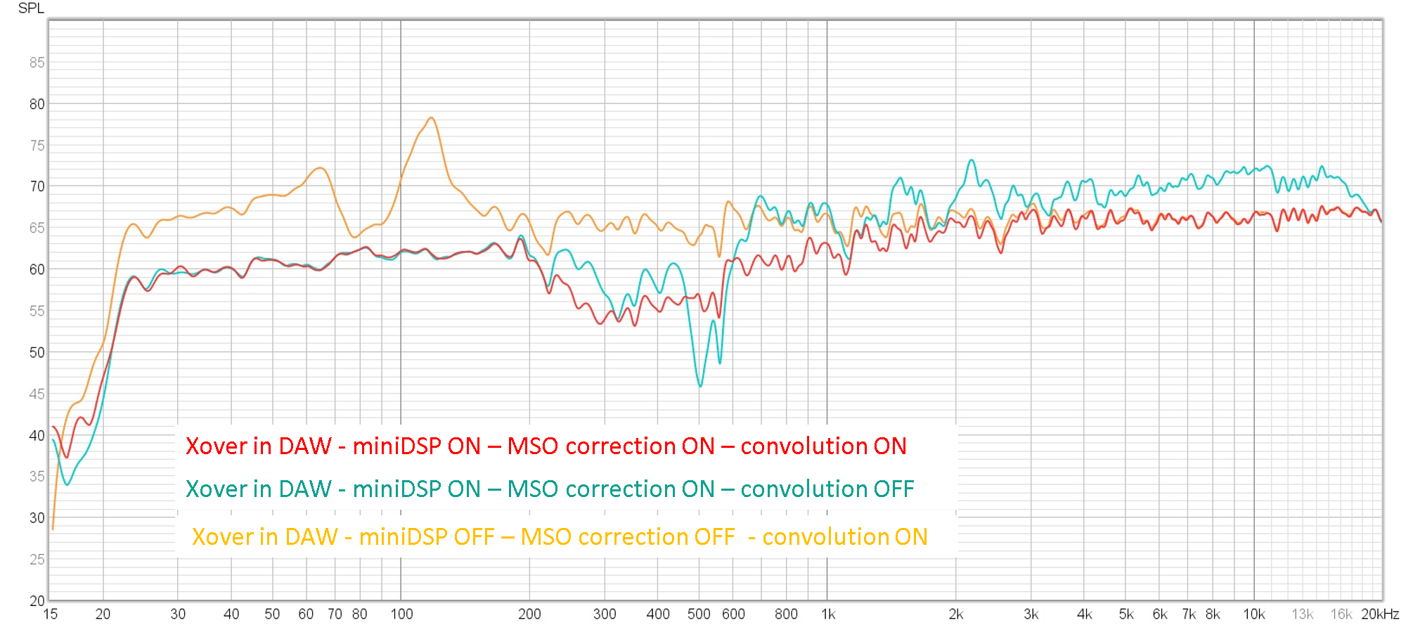

And below you can see the two corrections at the same time (red curve). There is something wrong from 200 Hz and it recovers slowly around 2 kHz... *
There is a peak disappearing at 550 Hz for some reason but this thin peak was nothing related to the large dip appearing with the 2 corrections at the same time.

* there is a few dB offset between the correction of the low-end and that of the high end. I thought fixing afterwards, easily with some negative gain on the high end.

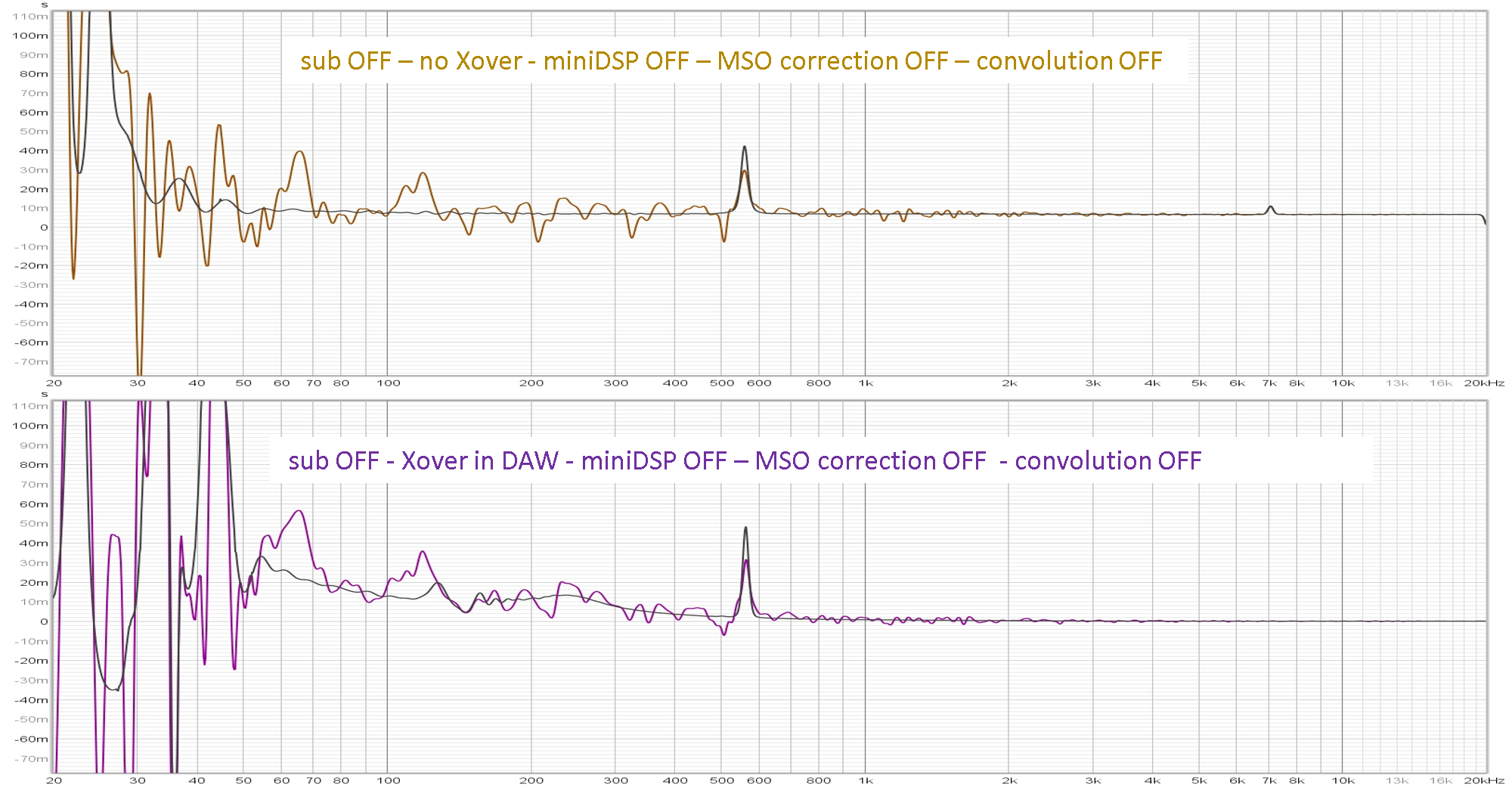

I am going to search for the spectra without the sub. But here is what I thought was maybe worth looking at:: the (excess) group delay, sub on and sub off.If you want to post your graphs it would be nice to see with and without subs, with and without DSP.

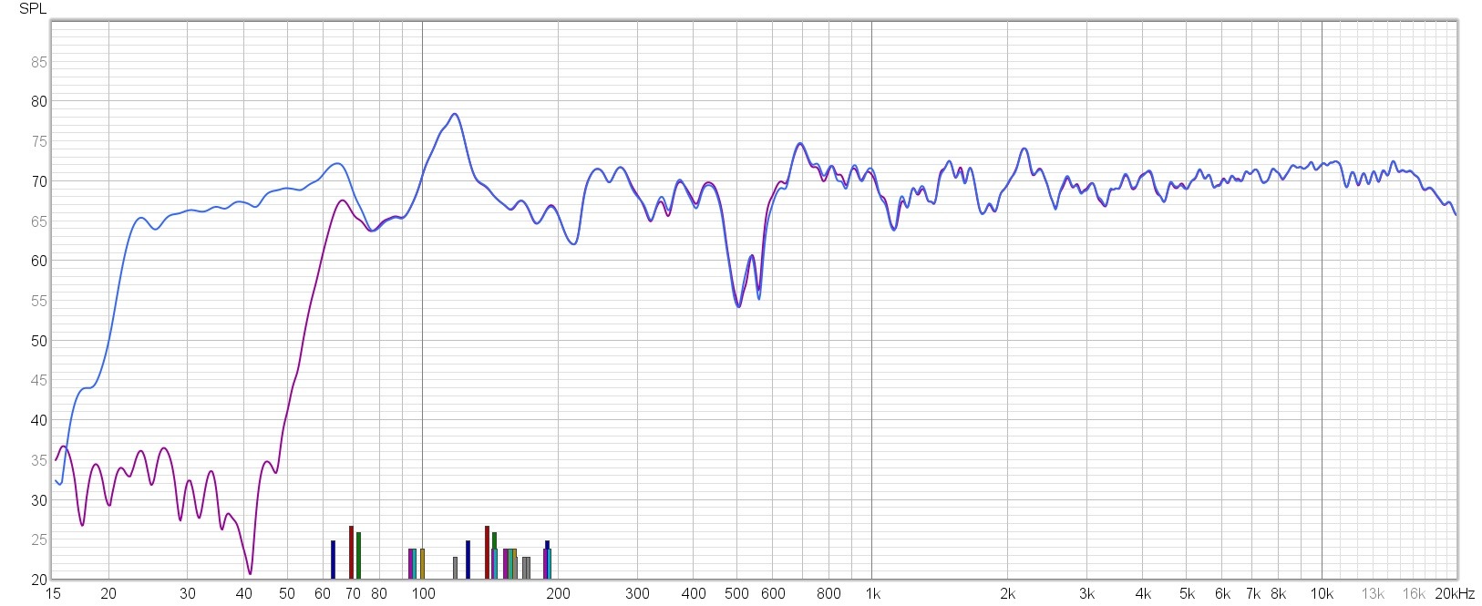

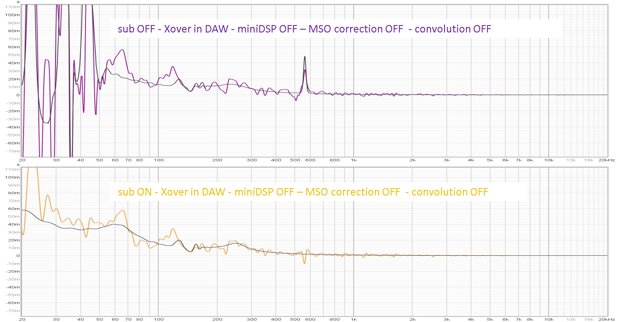

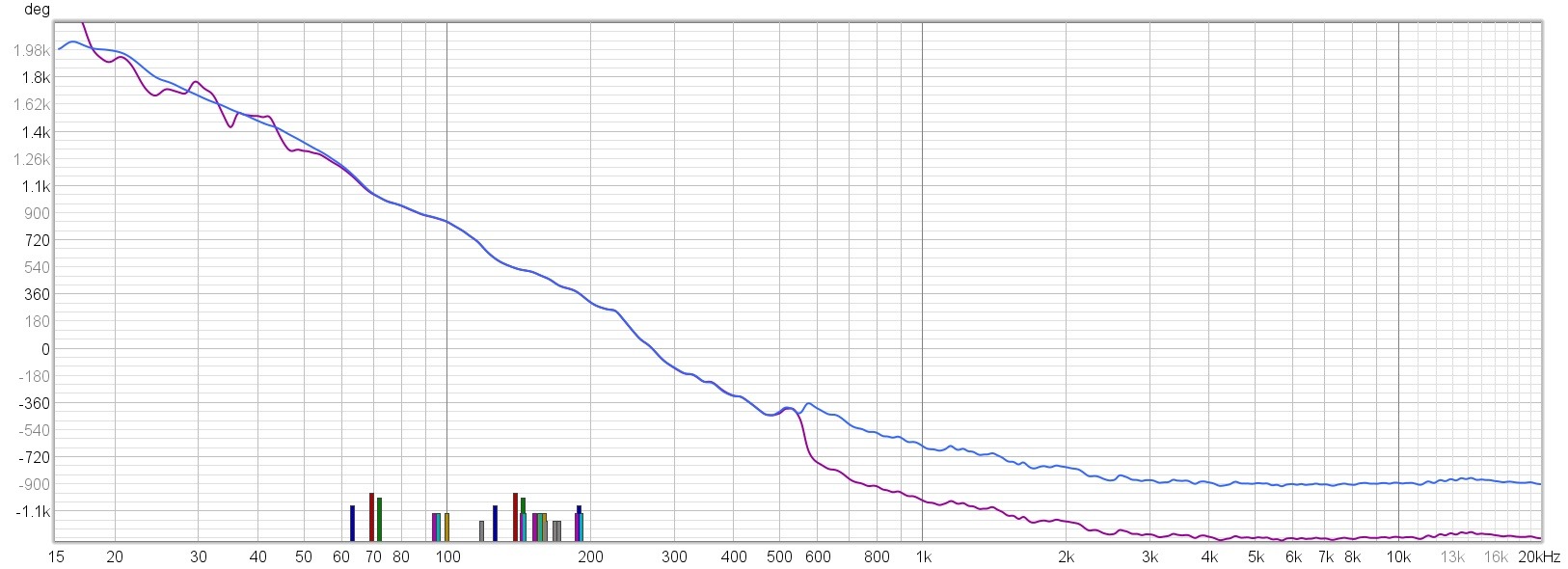

Here are the SPL and phase curves of the measurements without corrections, just sub ON and sub OFF.
There is nothing much different with respect to the phase, except the 360-deg flip at 555 Hz (related to the peak in the group delay).
