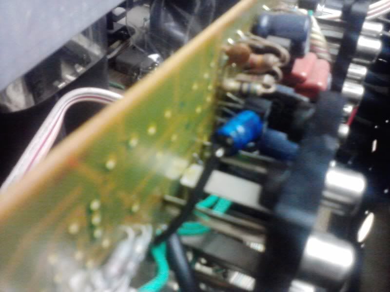

I found one capacitor on the input board that looks like one leg came loose from the board. problem is i cant find any place for it on in the wiring diagram, I'm wondering if it is supposed to be like this, does a cap serve any function with only one leg used?

Unfortunately the picture is too blurred to get a good look, but from it, I would assume the black wire is connected to it.
A cap with only one leg connected indeed doesn't serve any function. But I find it hard to believe that this could have happened with the amp just sitting somewhere playing music.
If you were to bend the cap upright, is there a hole in the pcb the loose leg could fit in?
