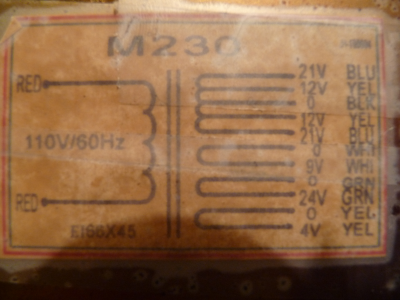

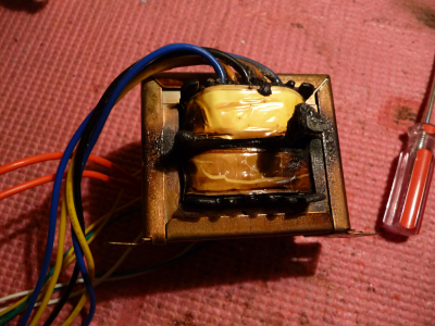

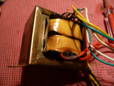

Hi all, I'm trying to source a replacement power transformer for a Magnum Audio M-230 (also know as Epic Audio Epic-230). It's a 5.1 channel surround amplifier receiver system. The original smoked up (shorted coils) possibly due to bad home wiring. The transformer takes 110v mains and provides 24, 21, 12, 9, and 4 volts. I've attached pictures of the unit and the transformer, as well as a circuit diagram on the transformer label. I have been unable to determine or locate the manufacturer, so I've been trying to find something that will work.

4Vac, 9Vac, 24Vac, and centre tapped multi output 21,12,0,12,21Vac.
you don't have a hope of getting this off the shelf.
A custom wound to this spec will cost more than four of these receiver systems.
Try asking the importer for spares. Again little hope that they will.
I'm afraid to say, but this is a bucket job simply because it cannot economically be repaired.

Yeah, agreed. The sub contained the amp, receiver and power supply, so I'm thinking I should pull the guts out, put a plate and connector on it, then get him a decent 5.1 receiver/amplifier - and just use the speakers as speakers. Boxes are decent. The amp section was 5 channels of all-in-one amp chips and a couple of TO-220 devices for the sub channel. No great loss. I was hoping someone had seen it before, or someother bit of good fortune.
