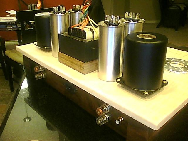

Here is the 2A3 under construction:

Thanks,
The top is actually 1/2" thick and made from laminating strips 1" wide of white Tiger Maple. I did it this way b/c the cut edge of the Tiger Maple has the best "tiger stripe" pattern. The base is Spanish Modena I planed down to 1/2" thick. I will try to take a few better pics, these were done with my web cam and do not show the grain of the wood at all.
